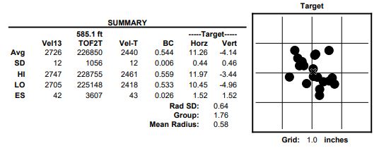

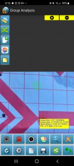

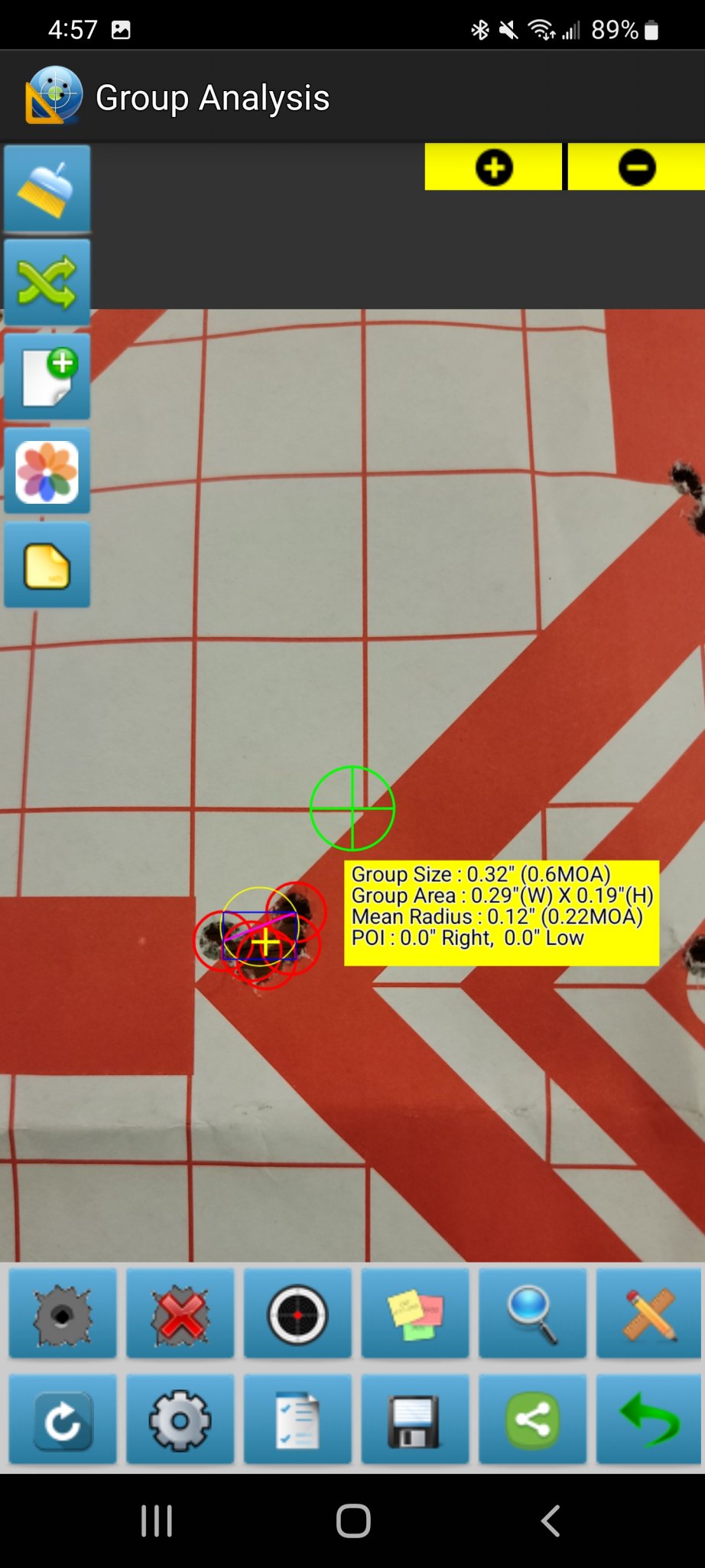

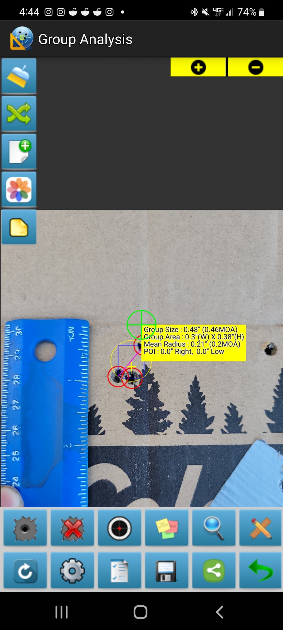

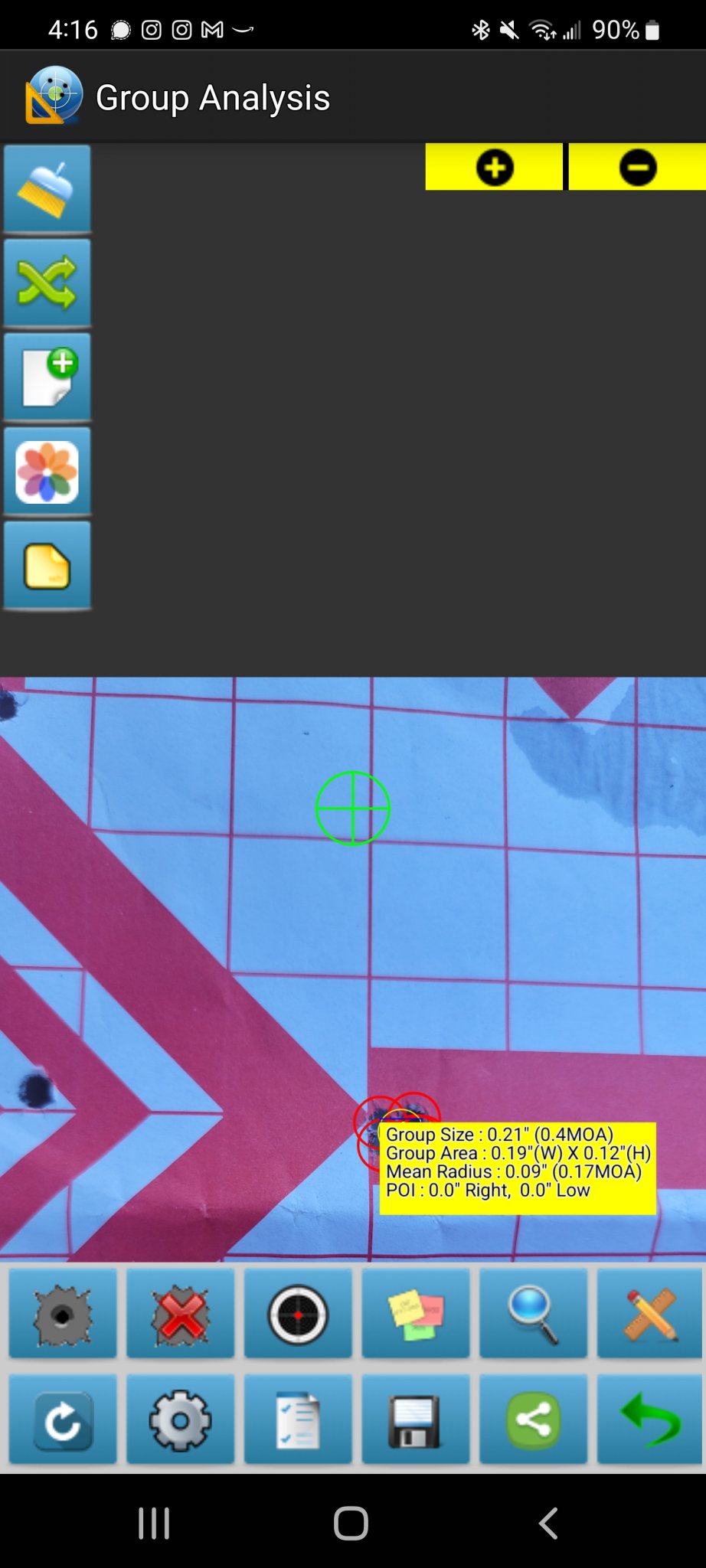

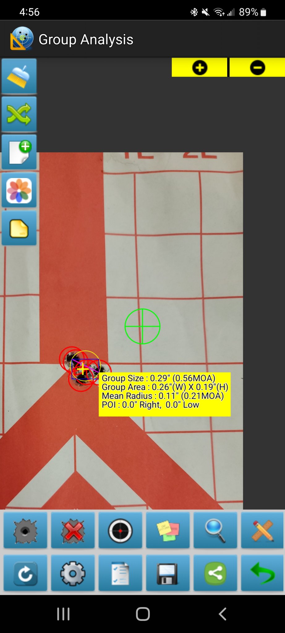

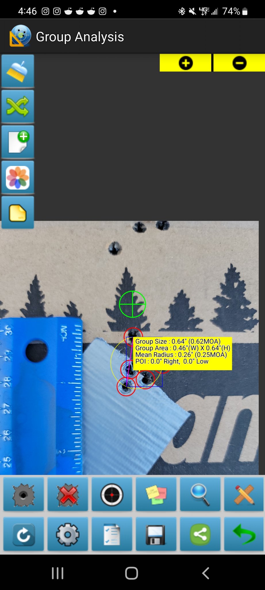

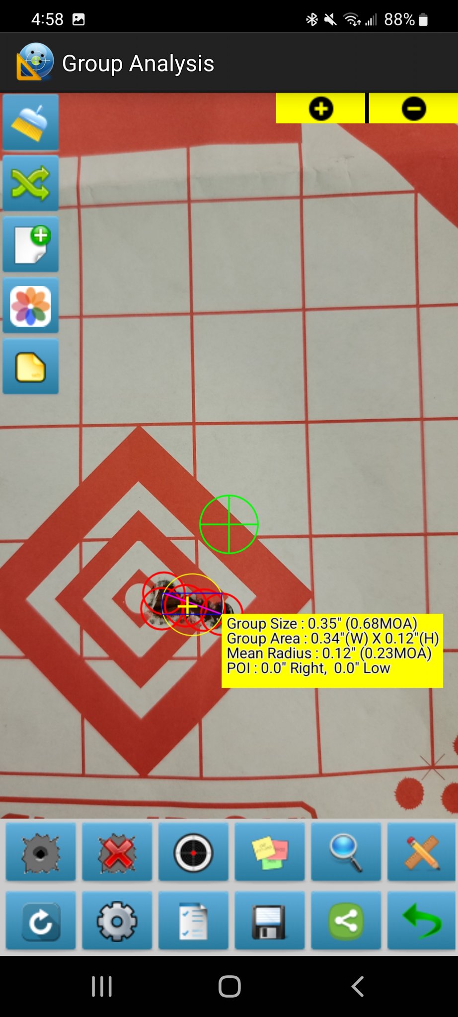

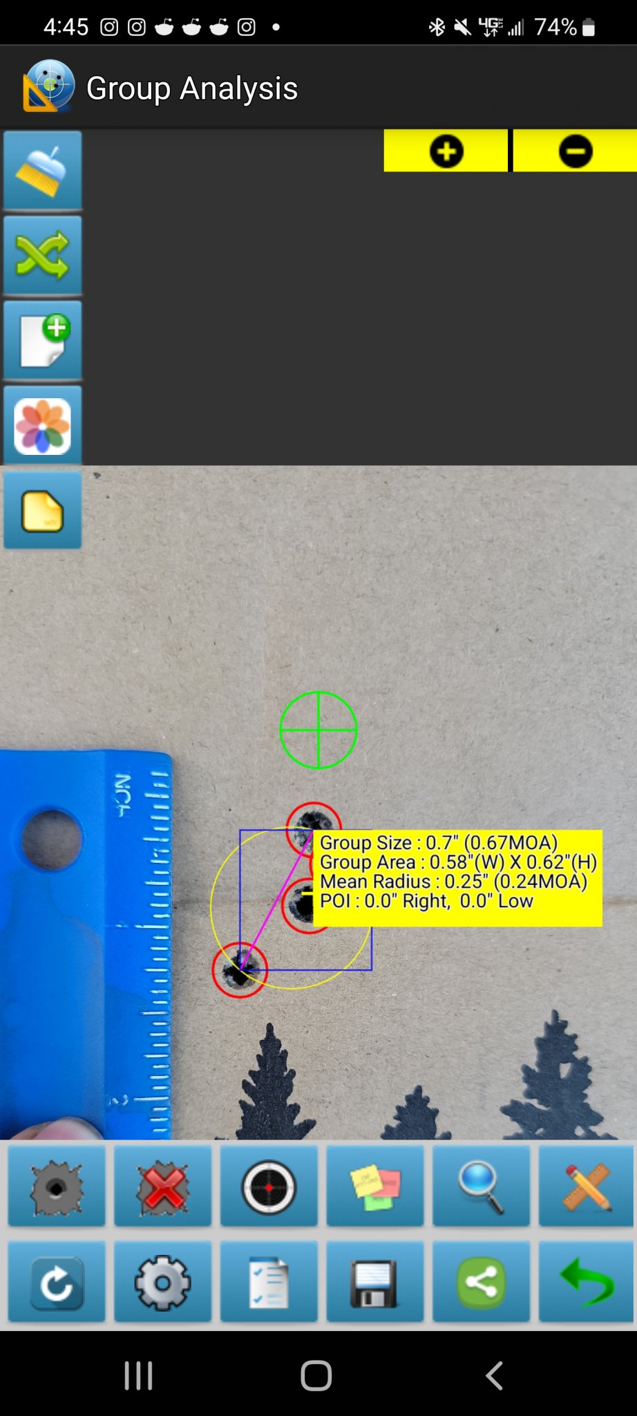

My bartlein 20in ar with a mix of factory hornady 108 eldm and 105 black.

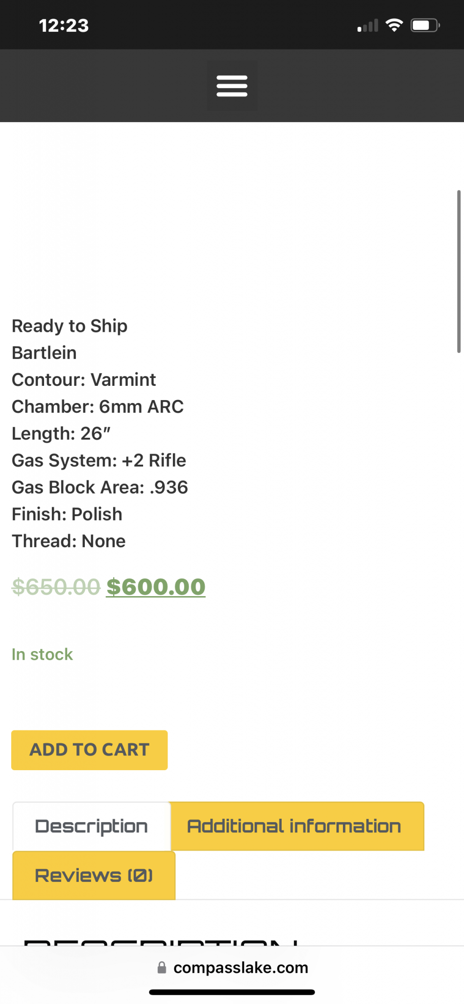

I’ve had good luck with this barrel. It’s a cut rifled vortakt blank. Single digit SD’s, 2660 fps with 108 ELD reloads. Half inch groups.
Kind of looking for a 22” barrel.

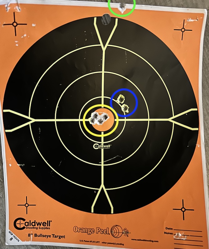

I have an Odin Works 18" barrel with +2 rifle gas length. While there are better barrels available, the Odin Works barrel is doing great for me with factory 108Gr ammo.
Here is a 100 yard target from when I was sighting in my Arken SH4 scope and also breaking in the barrel.
The single shot circled in green and the two shots circled in blue were just getting the scope dialed in. The five shot group circled in yellow was my final group before trying out some factory 105Gr ammo.
