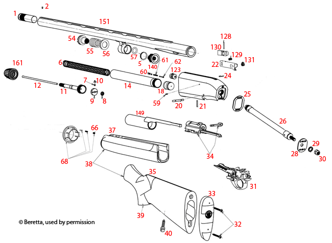

With many semi autos, their is a recoil system in the butt stock. (Part 26 in Diagram below)
It is impossible to shorten the stock on many Semi autos. With a pump or O/U, you don't have this issue.

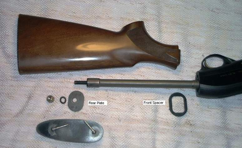

Many trap ranges will have a wide variety of rentals. Some also have a resident Smith who can chop the stock in a bandsaw and fit a new recoil pad. They can also install threaded inserts into the newly cut buttstock and the piece that was removed.
You save the piece removed and can later reinstall the piece with bolts from the removed piece into the threaded inserts in the stock.
If you are taking a big piece off- say 3", you might have them cut that in 1/2 so you end up with 2 spacers so you can add 1 1/2" to the stock at a time as the child grows.
Mossberg started importing Turkish made O/U. The main issue is that when they break, Mossberg does not stock parts.
Stock has to be longer than the metal tube :(
Spacer Concept - berretta 1301 - your spacer would be the wood removed

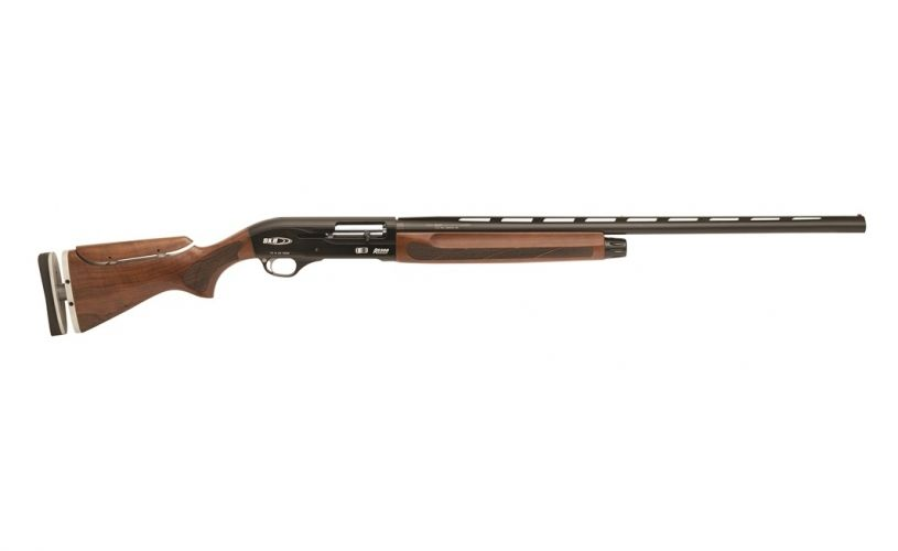

SKB RS300 on GunBroker for $866, buy now for $929. I think this is what you want.
FEATURES
  • Competition Grade
  • Standard and Youth Lengths

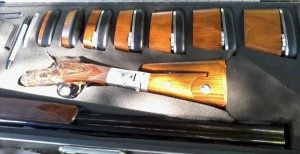

A properly fit shotgun stock is a combination of adjustments. These adjustments are unique to each individual shooter and include the drop dimensions, the proper length of pull, pad rotation and the comb alignment and height. The “fit and feel” of a shotgun and where it patterns are all dependent upon these unique dimensions.
The major challenge for most student athletes and coaches is having a shotgun that “fits” them from season to season. The RS300 is the solution to this problem.
Adjustable Butt Plate System
The stock’s length of pull can be adjusted from 13 ½” to 14 ¾” for proper gun mount and cheek placement on the comb of the stock. The pad can be rotated in either direction for proper shoulder pocket fit. This reduces felt recoil and the natural reflex to cant the toe of the pad away from the top of the pectoral muscle. The pad can also be adjusted in an up and down direction 1 ¼” to insure proper eye alignment to the sighting plane

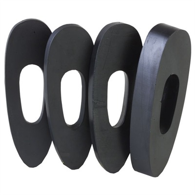

Adjustable Stock Shim System
A selection of 6 stock shims are provided with the shotgun. Three of the shims adjust the drop dimension of the stock from the standard drop dimension. The shim with the maximum drop dimensions is DAC 1 3/8” and DAH 2 ½”. The shim with the minimum drop dimension is DAC 1 3/ 8” and DAH 2”Also included are two shims that adjust the cast from neutral to either Left or Right. These cast shims have a standard Drop Dimension of DAC 1 3/8” and DAH 2 ¼”
Adjustable Comb Hardware
The adjustable comb can be moved horizontally ¼ inch from the center line of the stock in either a left or right direction. The comb can be adjusted vertically upward ½ inch by using washers that slide over the post. These comb adjustments insure that the shooters eye is in alignment with the center line of the rib

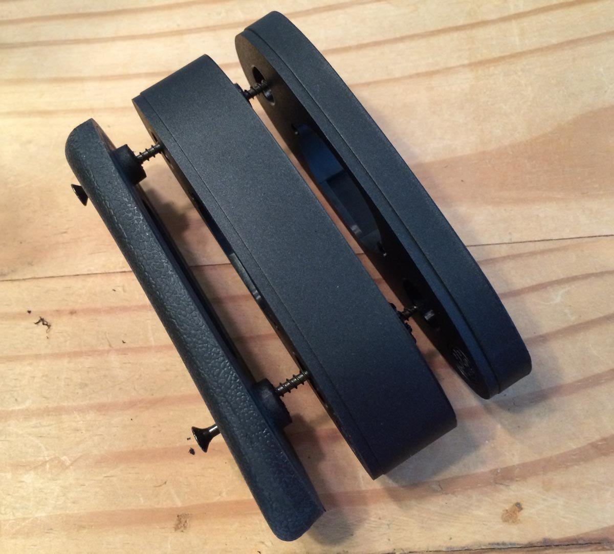

RS – Hybrid Recoil System
The new light load recoil system allows even the youngest of the youth shooters to utilize a 12ga shotgun in practice and competition. The gas assisted “RS” will cycle a full range of ammunition from light low recoil training loads to 1 ¼ oz. Heavy field loads.

I strongly recommend a KickEze pad on whatever you set up for her. Got the wife into trap and 5 stand with a shortened/fitted citori with a kickeze and she'll go out n shoot 200 rds. of 12 gauge with no issues.
