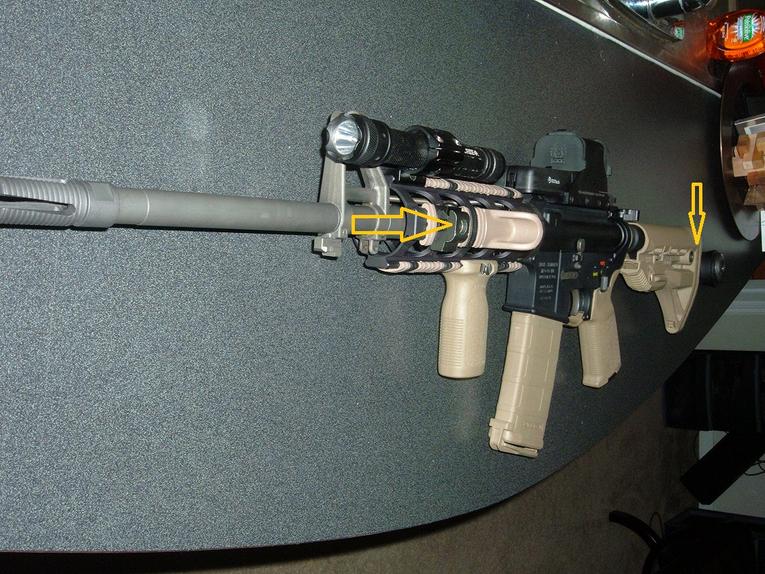

if the $60 is too expensive for you, go old school with some 550 cord loops on the stock. I did it for years in the military. if you are right handed and put the buttstock sling attachment on the right side of the stock, you will have it lay flat better pulling the stock in with the sling.
maybe these pics will give you some inspiration
Don't run a sling based on the cheapest way to do so. Find what works for you and run it that way. If you want a 2 point sling Gear Sector and a few other companies make QD adapters you could mount to a MOE base attached to the hand guard.
I agree with CASDB, I've been down the cheapest path and I spent more to get where I needed to be. I run Troy 2 point slings on my AR's with QD sling mounts on the ends of each and the rifle sits just fine, doesn't tilt away from me. Here's one of mine and I run the same mounts for all my AR's. I tried the end plate with the wings for running your sling through. Problem is, I run VLTOR charging handles and I'm use to charging the rifle with just my index finger and I kept hitting the sling mount. That really was a pain the first time I tried it and never got used to it. You may not want to spend but I would at least get the buffer tube clamp style if you aren't going to get the armorers tool and I would get Magpul's sling mount for the handguards. You can always try mounting the front of the sling on the right side(forward assist side) if need be.

I dont want to be cheap I just personally can not justify $60 (plus what ever shipping) for two QD sockets that will work with my furniture. Then spending another $20ish for QD swivels, then ontop of that spending another $30-$40ish for the sling I want. $120+ for a sling is just silly IMHO.
Ive got a few thousand feet of paracord at home Ill have to run and see what I can do. Maybe I can rig something to get me by. I have been running just a single strand of paracord tied off on the handguard and the butt stock. Its not at all comfortable and its only good for allowing me to hang the rifle and use my hands for other things but its just not working.

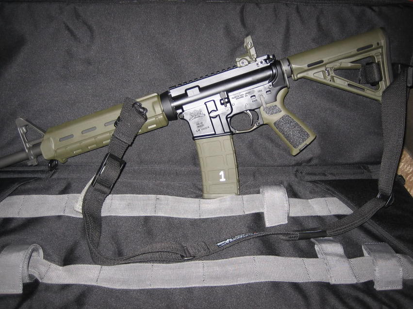

I was pondering just threading the sling through the butt stock but im afraid that when I am just carrying the gun or just letting it hang it wont want to hang correctly. The sling wont allow it lay flat across my body like a sling swivel would allow it too. Theres so many options I just cant decide what way to go.
If you thread it over the buffer tube which I have done it will hang the same way it does when using the QD mount. I tried it when I first got the sling just to see if I needed the QD attachment. Mounted that way with the front mount using the front sight base it wont hang flat as I think you are thinking. The back attachment is more responsible for how the rifle will hang. If you threaded it using the vertical slit that's along the butt pad side you'll be fine, I've tried that as well. I wouldn't use the bottom "angled slit" because that will help the rifle fall over . I'd use the buffer tube portion of the stock to thread the sling.
This is not my rifle pictured but it describes how I would do it on your budget.
Thats exactly (well pretty darned close) to how I planned but someone told me that it would not hang correctly.

No, that's fine. Treading the sling like that will cause the rifle to lay against you with the mag release against/to you, barrel pointing down, sling running around your back. Some people will also mount the QD cup on the opposite side of the hand-guard (port side) sling across the top which will also force the rifle to be in the position you're looking for. Main thing is having it hang barrel down , stock towards your face where you can rest your hand on the grip and have control of the rifle without actually holding it all the time, that's how I like a sling to work; let's you roll the rifle around to your back if you needed to climb as well and the rifle will lay flat against you.
