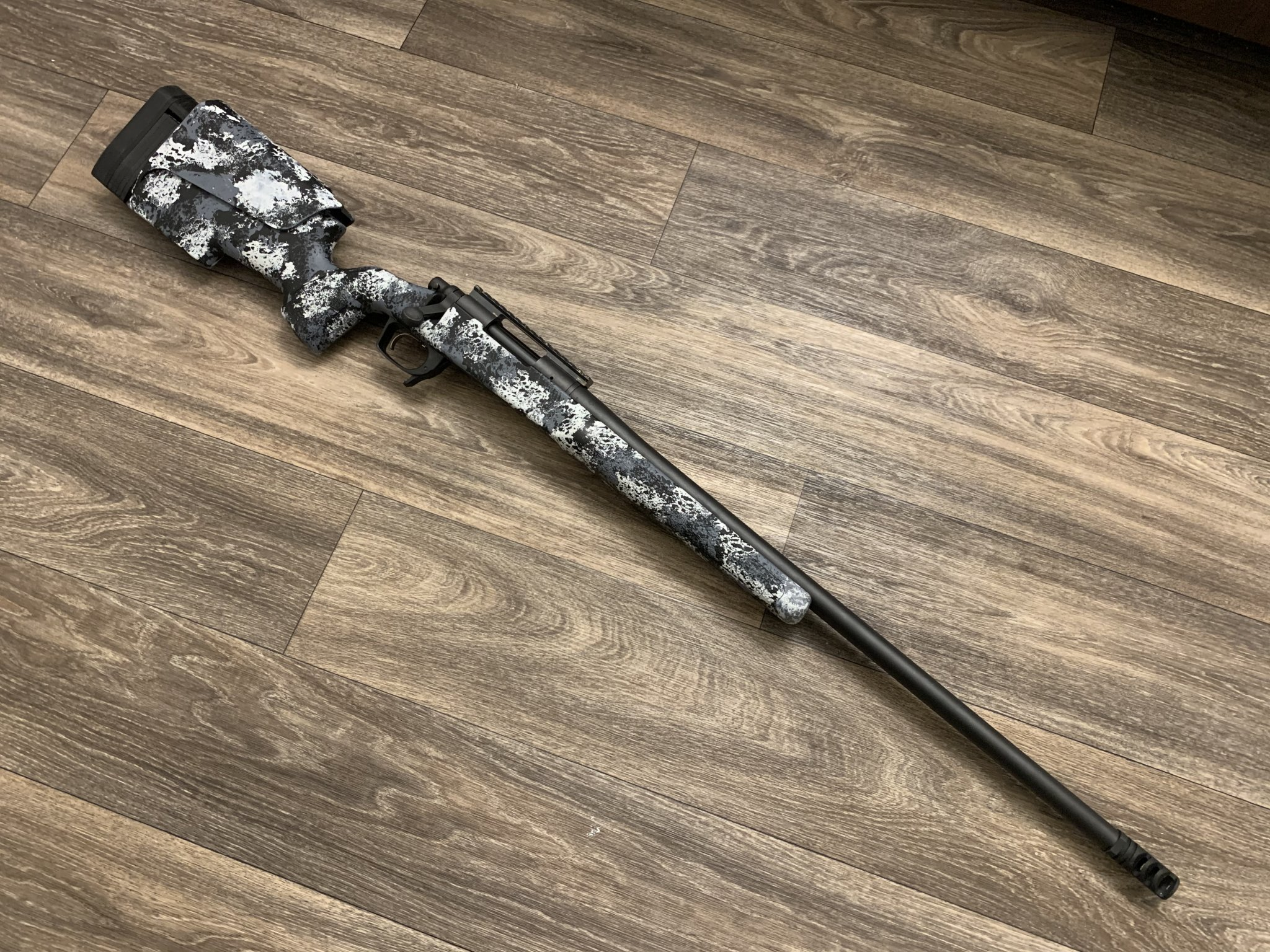

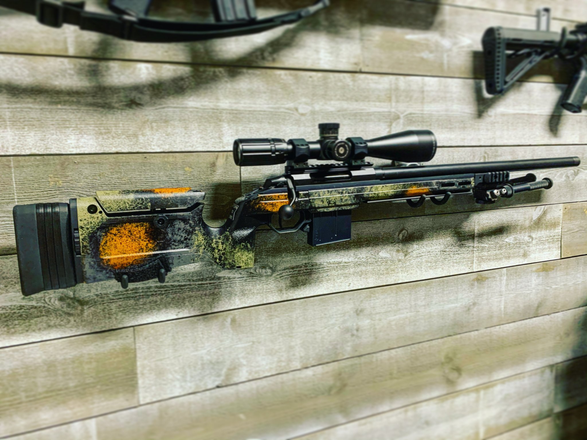

I used various high quality spray paints. Spray a puddle on a plate and dip the sponge. The real trick is learning how to add dimension with layers. It’s really not hard to do you just have to find the technique. I practiced on random things and had a big plan when I started but it all went out the window about halfway through and I just went with it. Turned out better than I hoped. I was actually putting this rifle together for my brother but I like it so much I ended up keeping it and buying him another one lol.

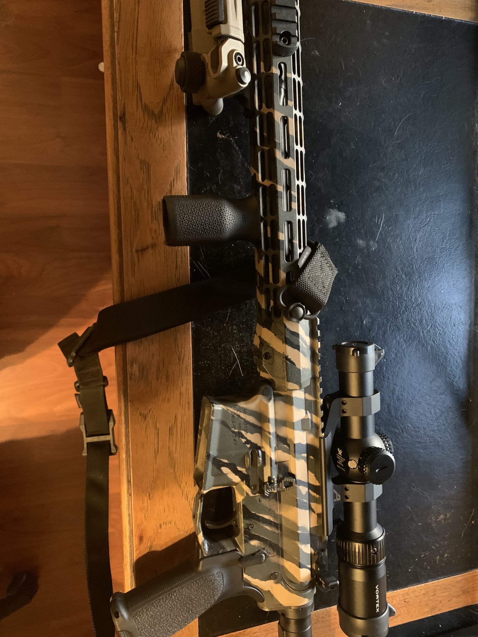

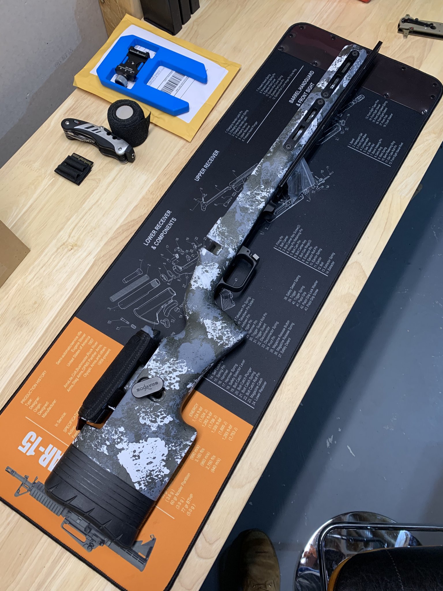

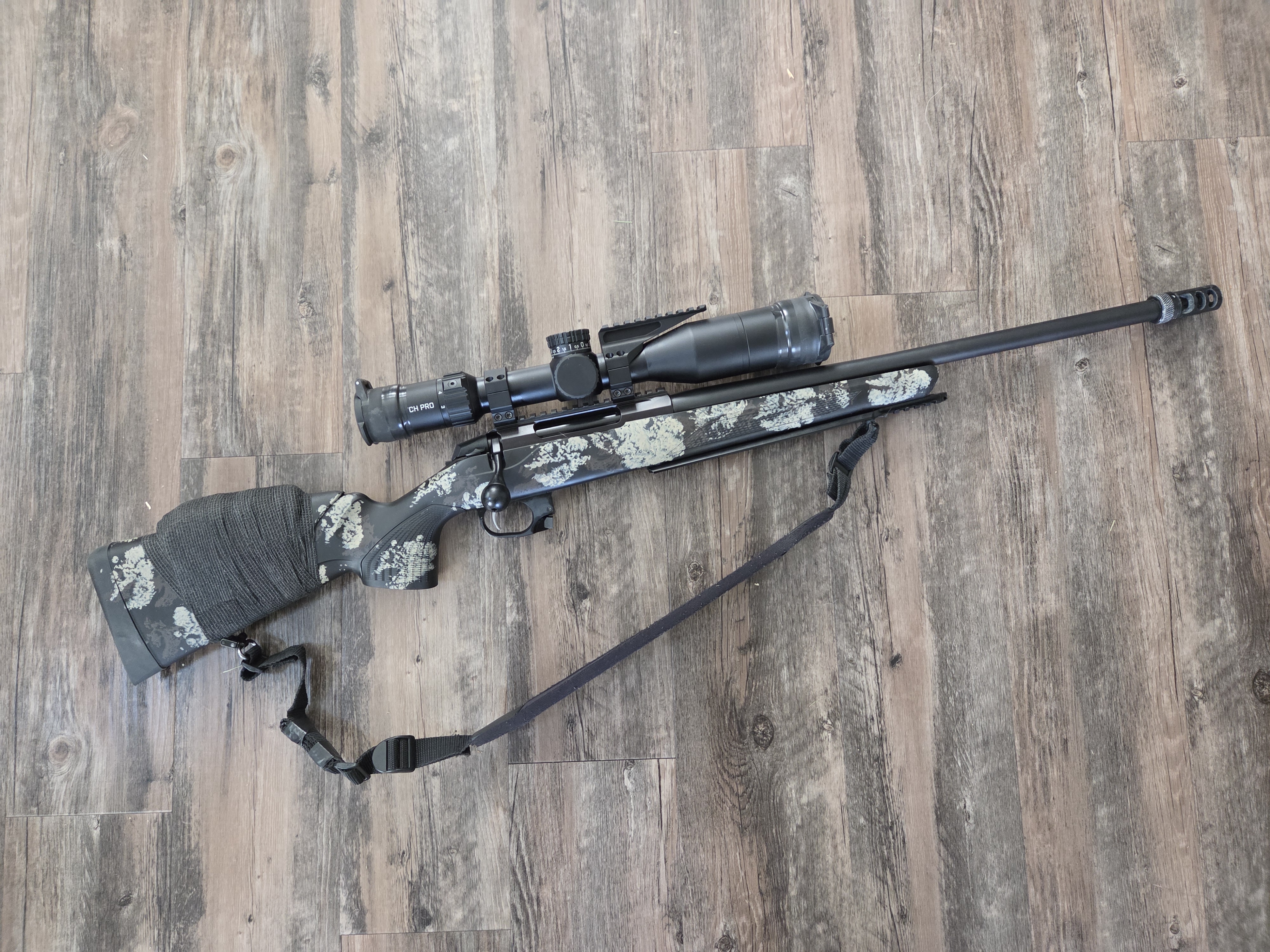

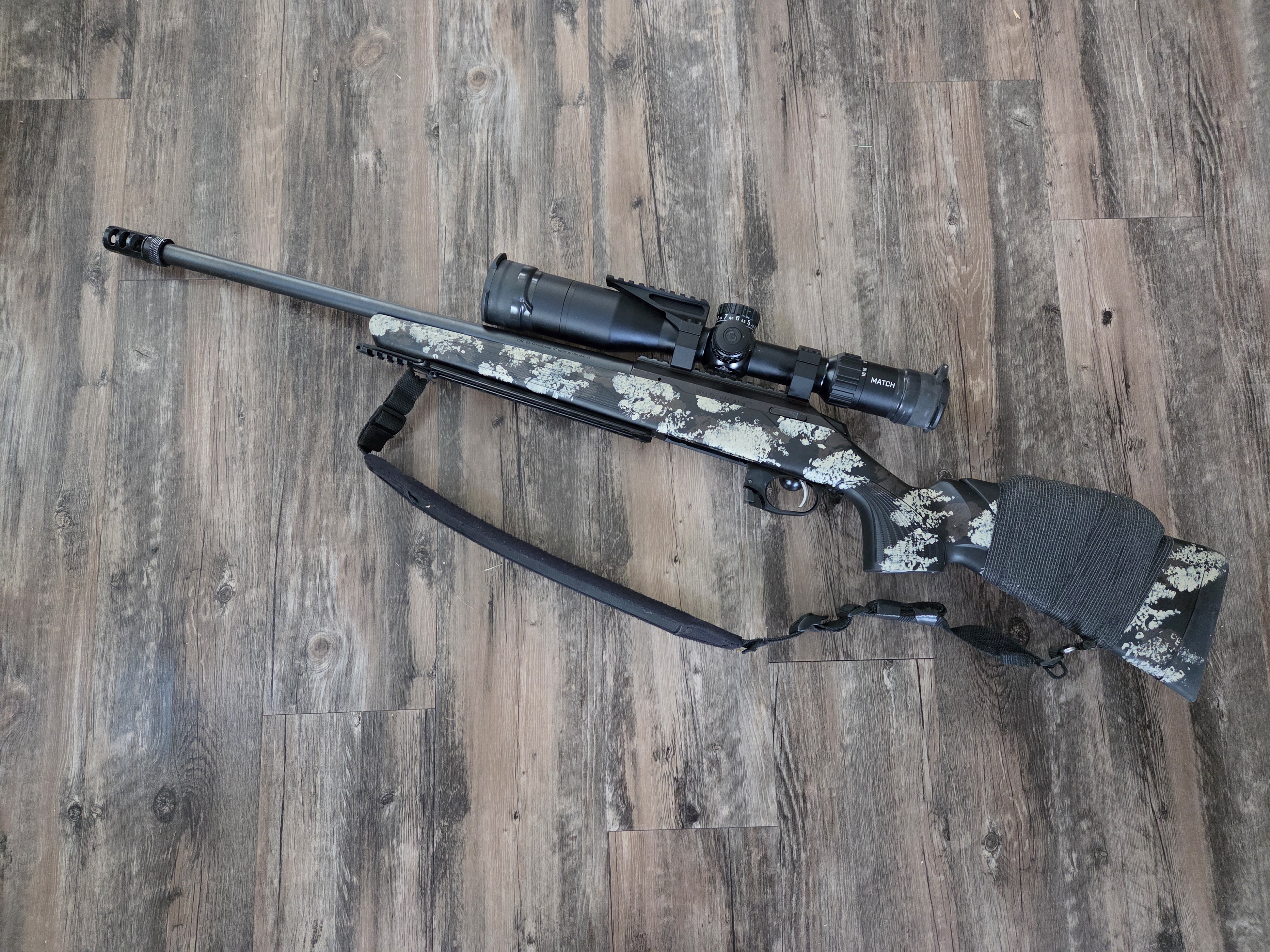

I guess I don’t have any pictures in better lighting on this phone anymore, but this was my attempt at it just using krylon spray paint matte colors. Just used a dish sponge to apply. I liked how it looked and it held up well. I did use a couple coats of clear coat to protect it too

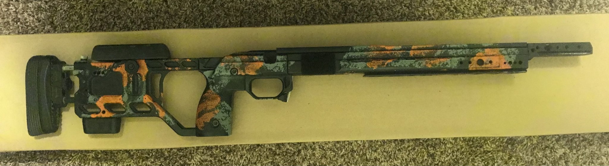

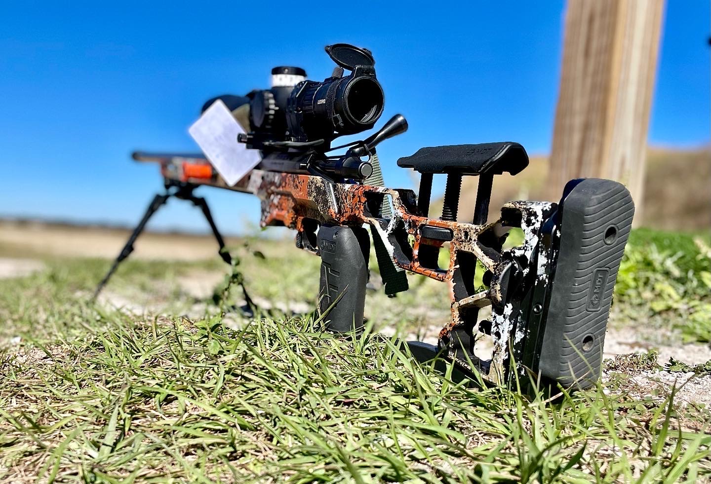

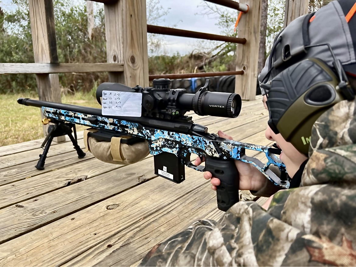

These 2 were done with Brownells Alumahyde.
After a base coat, I use the same method as PU by spraying a puddle onto a paper plate and dabbing the sponge.
If you allow the AH to fully cure it’s a very tough finish.

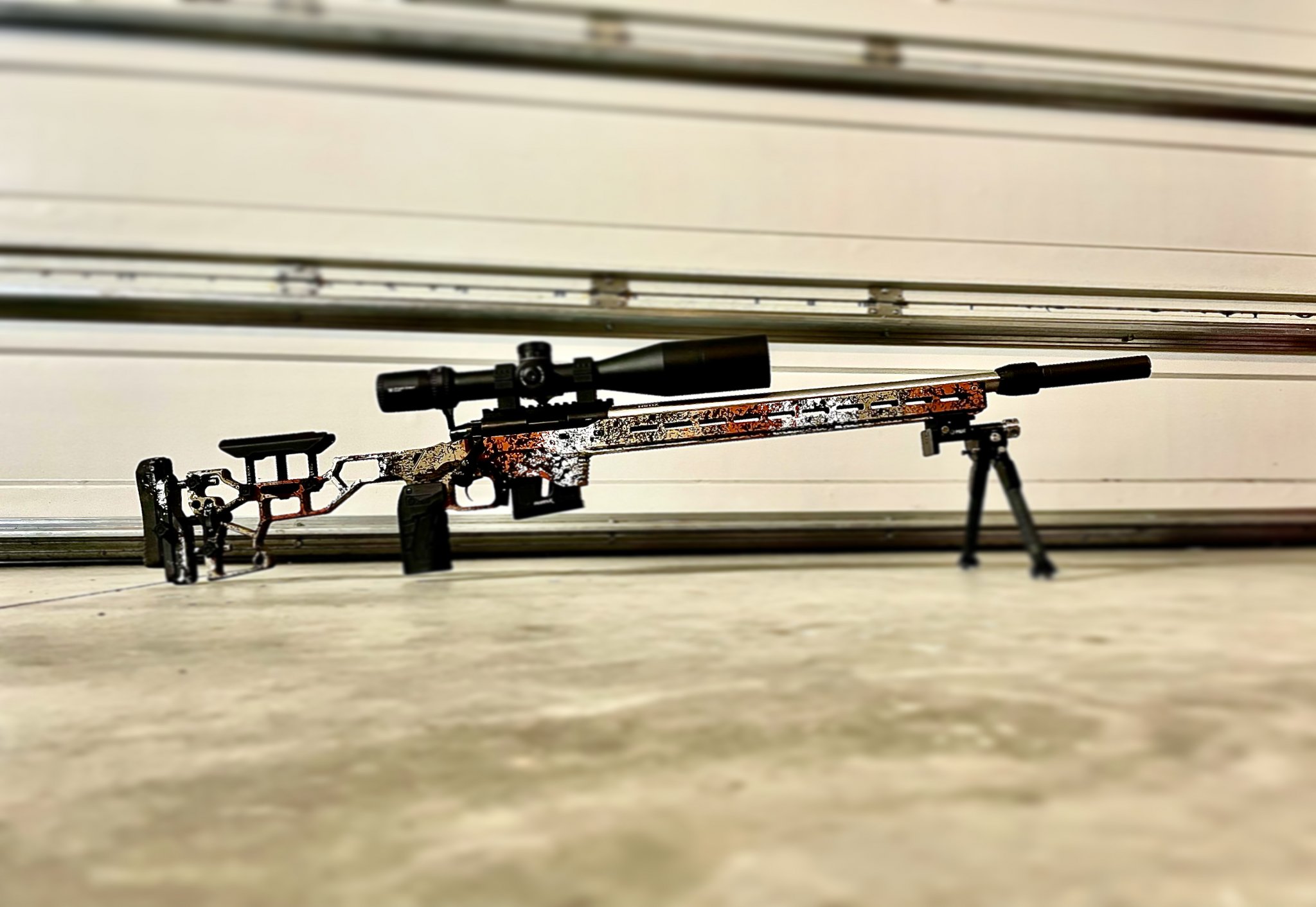

This is more of a tiger pattern but the paint is Brownells alumihyde, takes a while to cure but is a incredibly tough paint for scratch resistance.

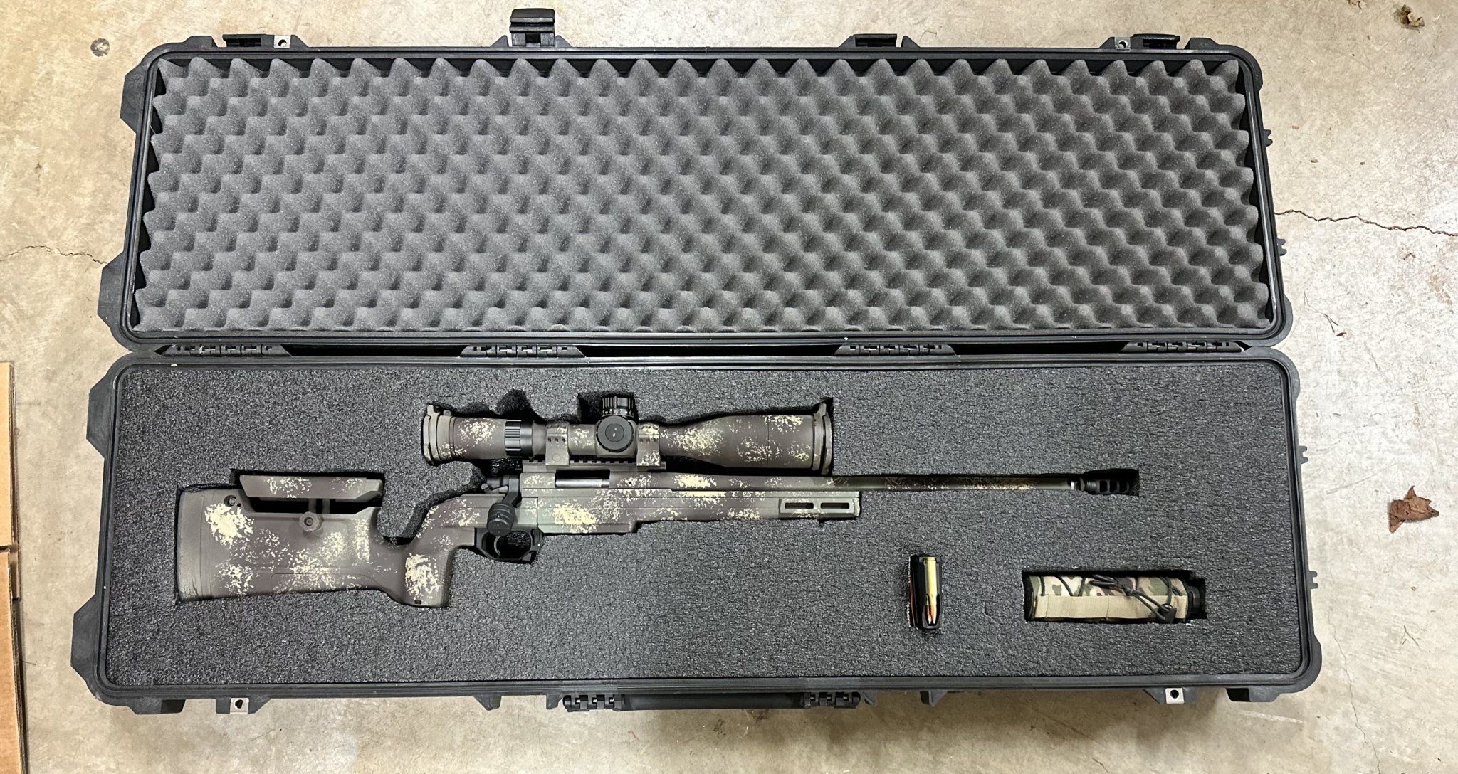

I used Krylon Colormaxx and craft sponges from Hobby Lobby. Sprayed the paint onto some cardboard, dabbed it with the sponge and then dabbed it on the stock a couple times while rotating the sponge. Apply as much or as little as you like.
I didn't bother clear coating the stock after painting it and I haven't had any issues at all.

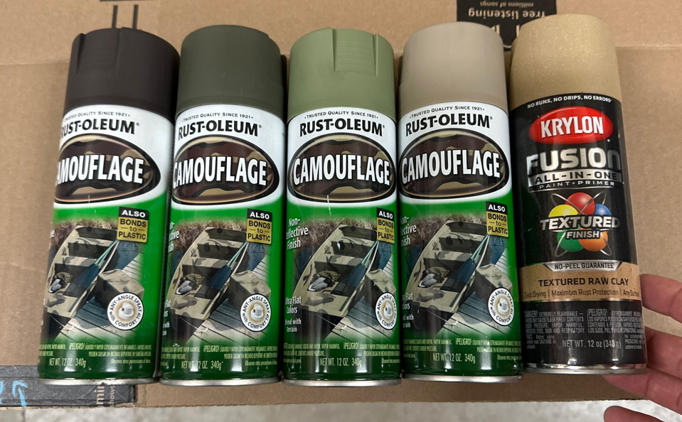

Good Ol fashioned rustoleum spray paint

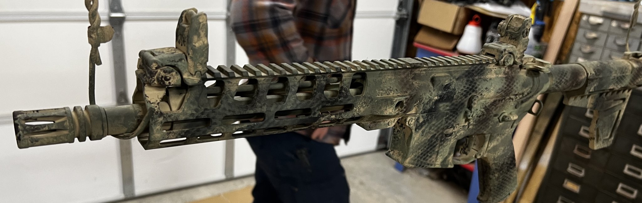

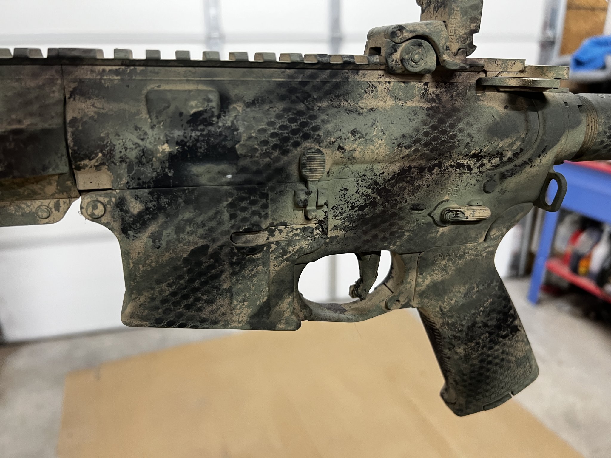

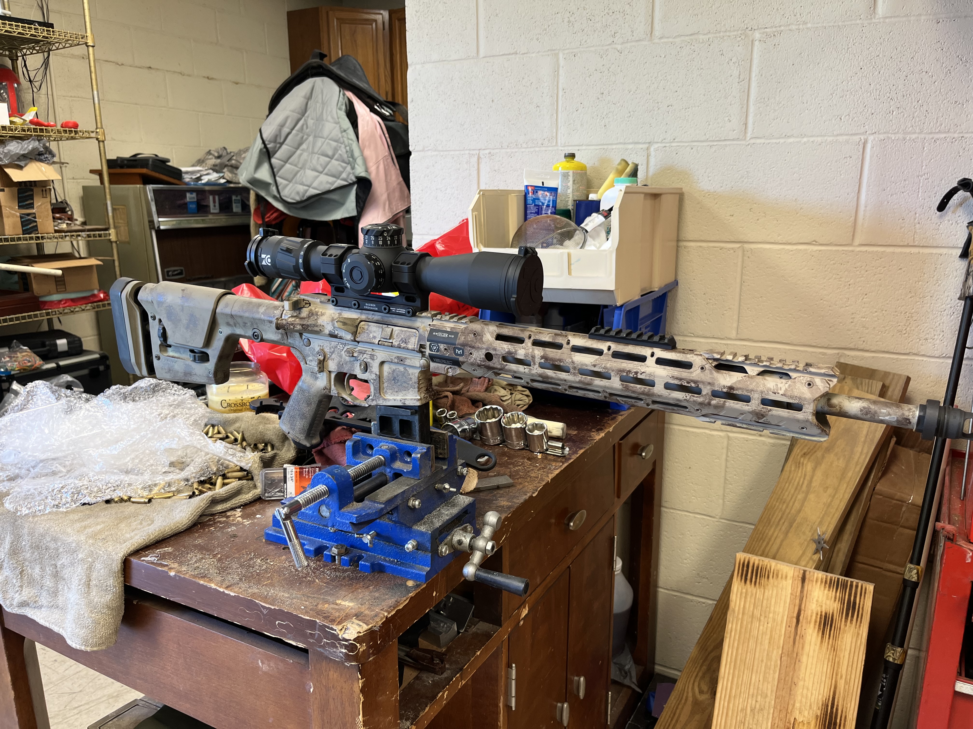

This is rustoleum camo colors and a paint sponge from hobby lobby. I also used a laundry bag for the hex. Just spray a puddle onto a paper plate and dab your sponge. Then dab on cardboard until you have the paint saturation you want, then go to the rifle with it. The hardest part is knowing when to quit.
