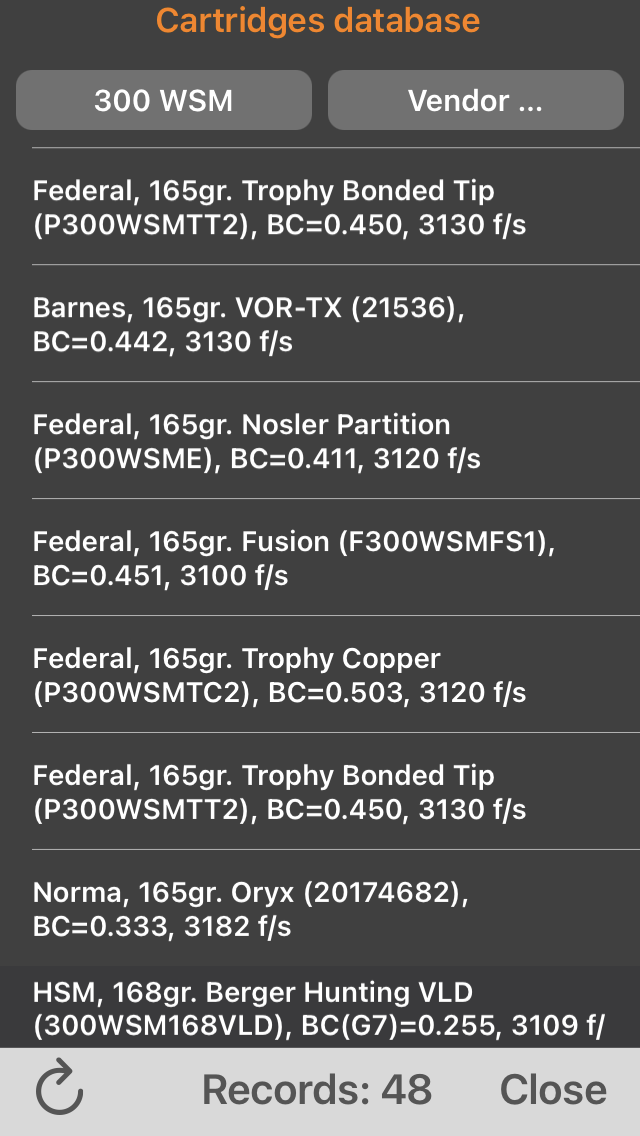

Had a look at the commercial ammo listed in Strelok Pro. The 165/168 gn ammo runs about 3130 fps. The HSM 168 Berger HUNTING VLD runs 3109 fps, almost exactly your number.
Also had a look at the Hornady load manual (11’th edition) and for 165/168 projectiles, it list most powders at 3100 fps max, so very similar. Only W760 at 3150 and Superformance at 3200 fps exceed that, for a 24” barrel.

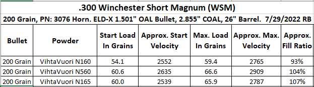

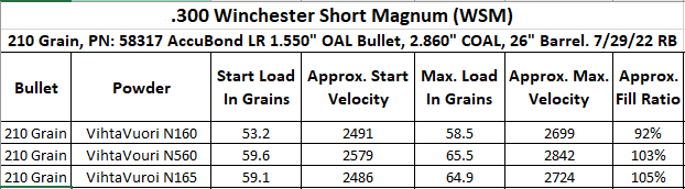

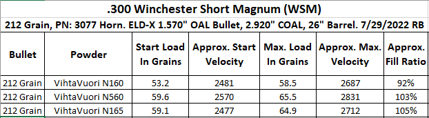

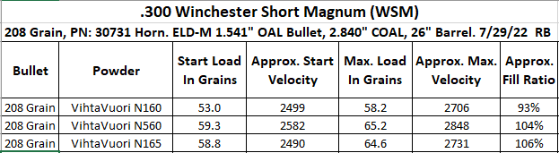

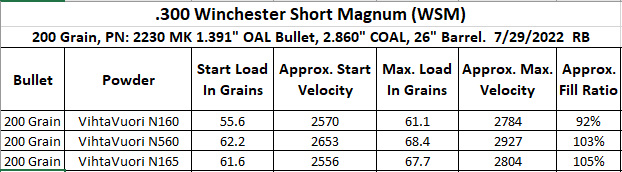

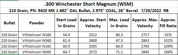

I emailed vihtavuori to ask about data for 200-212 grain bullets and they sent me their data. I hope this helps.
I initially asked for N568 data for those weights but they said there wasn’t enough case capacity to reach optimal velocity.
