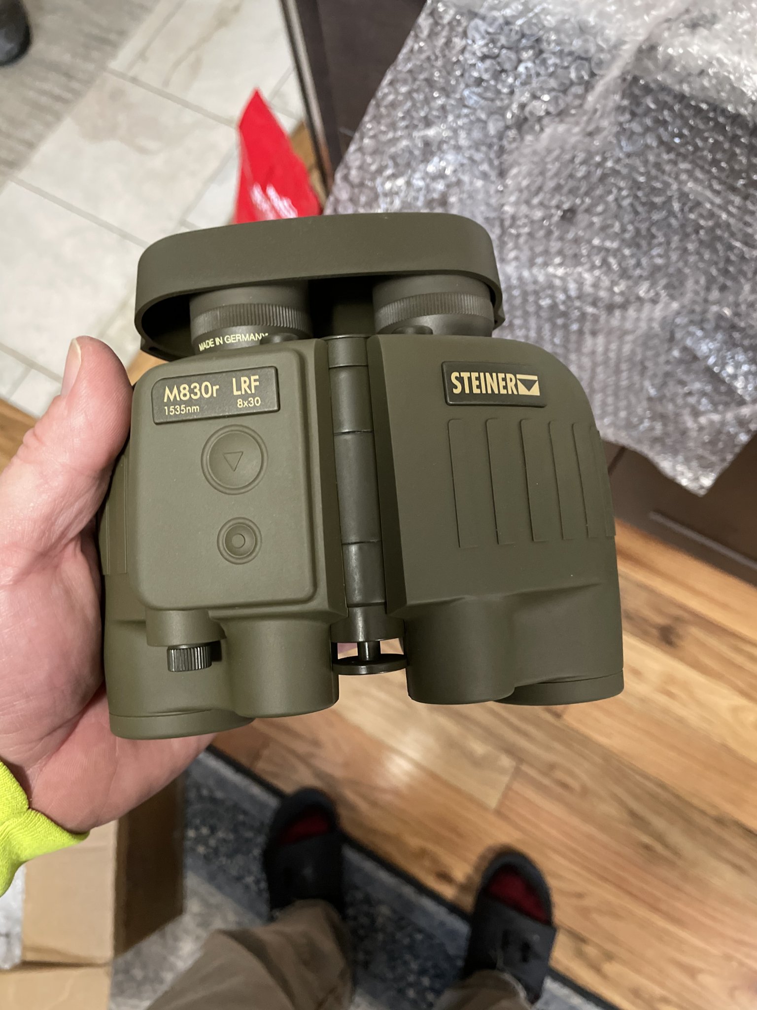

Buy once, cry once. Loving my Steiners! Glass is amazing.
