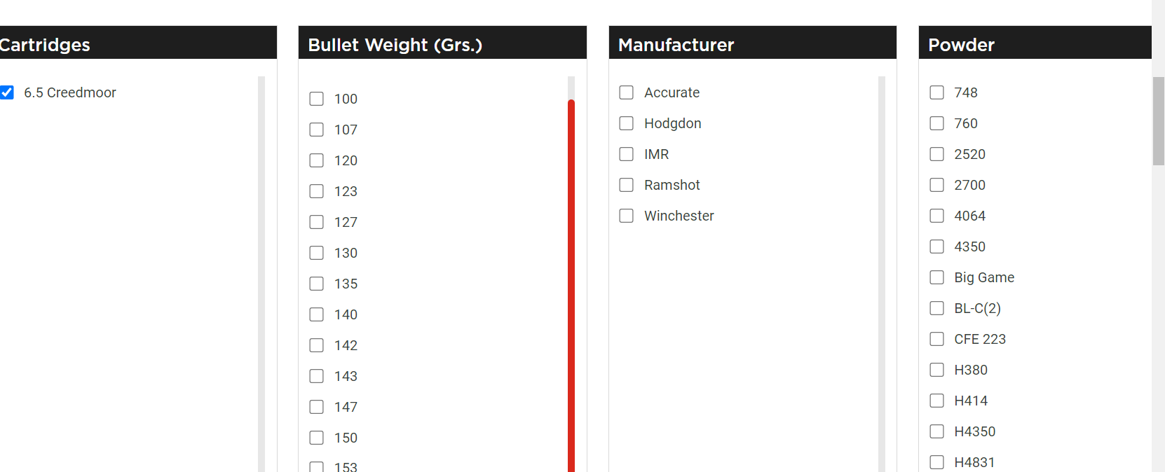

Plenty of powders for the creed . This is what hodgdon lists, plenty more options by other makers .
