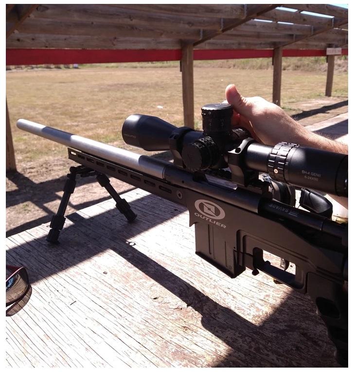

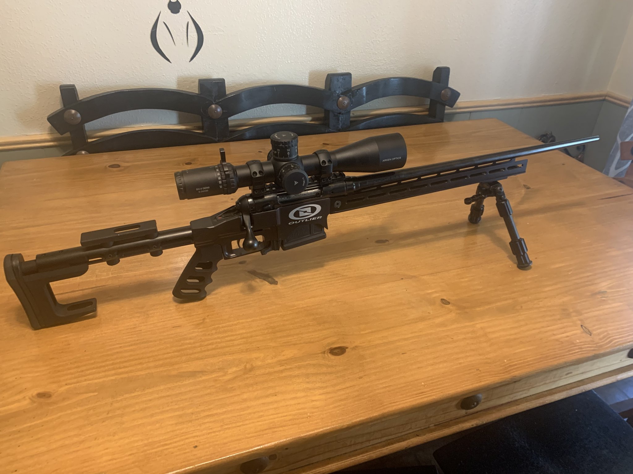

Outlier has a Savage chassis offering as well. Cool lightweight setup @ 2.5#'s.
