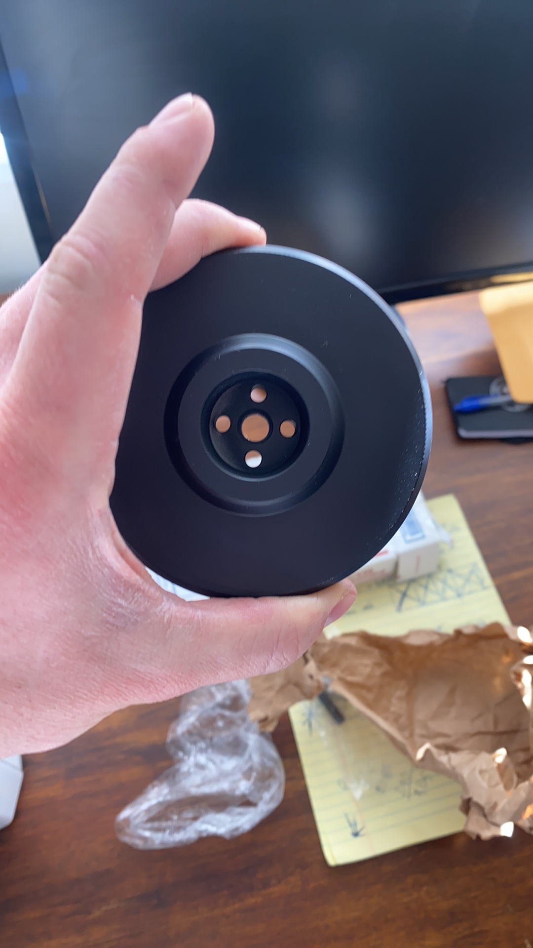

the main issue with the bowl on the rt90c is it only has one screw to hold the ball head to it. It gives the opportunity for you ballhead/leveling head to work itself loose.
The plate @midwestoffroad makes is specifically designed to fit the anvil 30. Maybe others, but idk, I was only interest in it for the anvil. Midwest makes it to fit the screw pattern on the anvil 30’s pedestal so it can’t rotate itself loose and drop your rifle or Observation device.
