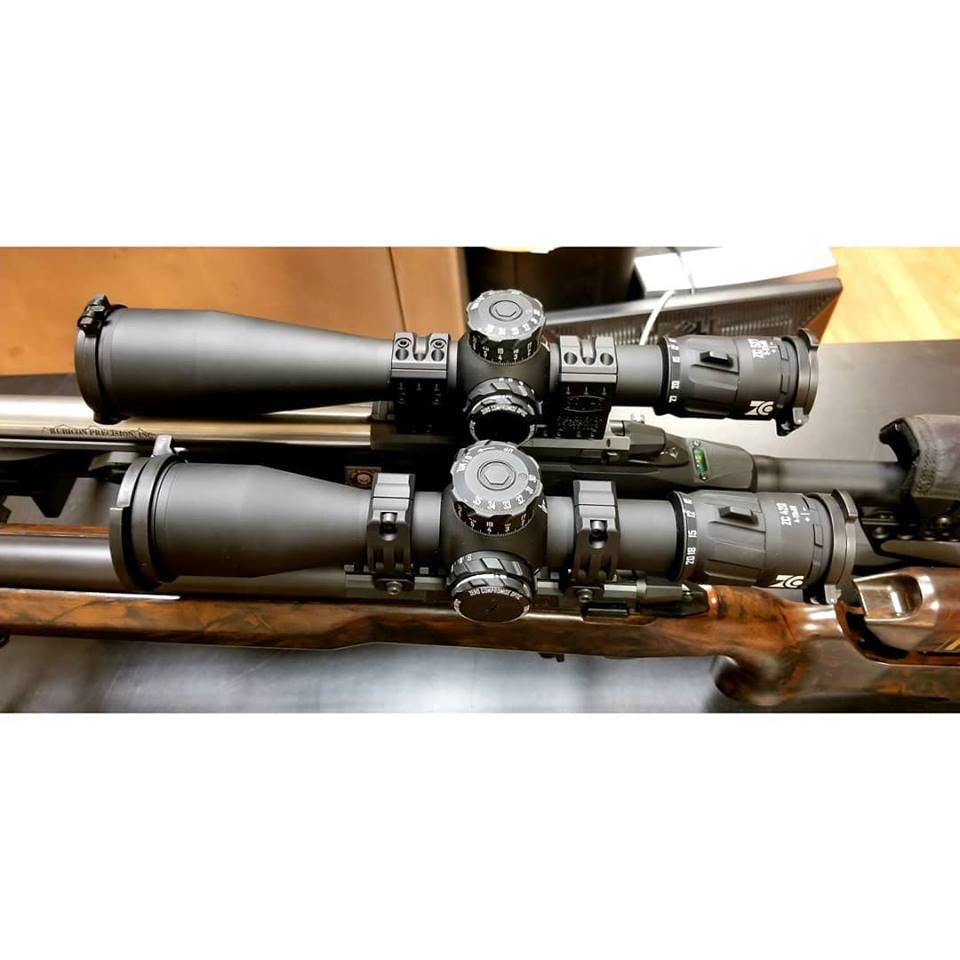

Keep hearing good things about the ZCO shorty, waiting for someone at the range to have one so I can check it out..... but it is several ozs heavier so that kept me from doing it at first.
Which models?
ZC420 MPCT2
ZC527 MPCT1

ZCO 4-20×50 I just mounted up last night. Heading to the range in 30 minutes, but first impression is outstanding. Heaviest of the bunch, a bit longer than the S&Bs, but glass appears amazing, Tangent Theta level, reticle (MPCT1) is the best I have seen, good mounting lengths, perfect seeming tension on mag ring, awesome tactile turrets, and best markings on the turrets I have.
OK, only spent 5 hours at the range today, and only shot 100 & 200 yards.
But the ZCO 4-20×50 is a legitimate contender for best scope ever made.
I can admit that it is clearer and has better color/depth than my S&B PMII 5-20×50 US and 3-20×50 US. I wish I would have taken my Tangent Theta out too, but 4 rifles were enough. I will get out to the desert soon to check them all side by side out to 1500+.
I like the less cluttered reticle, so opted for the MPCT1. MPCT1 vs. H2CMR is no contest. The MPCT1 is finer and has that tiny floating center dot. At 100 & 20x, the H2CMR covers up my .25" center dot targets and fine crosses. The MPCT1 does not. But yet, the H2CMR at 3x or 5x is very fine. It is visible, but not by much at 3x. 5x is better. The heavy outer stadia of the MPCT1 draws your eyes in and even seems to enhance the thinner center reticle and subtensions.
The locking turrets are firm, yet easy to manipulate. And the lack of MTC is easier to dial .1MIL over full MIL, but I kind of like the MTC for knowing when you hit full MILs though.
The ZCO is definitely the best shorty out there, but you are certainly going to pay for it.
