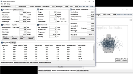

Sure, you can open up as many instances as you want. Just like you see in the store image where two instances are open:

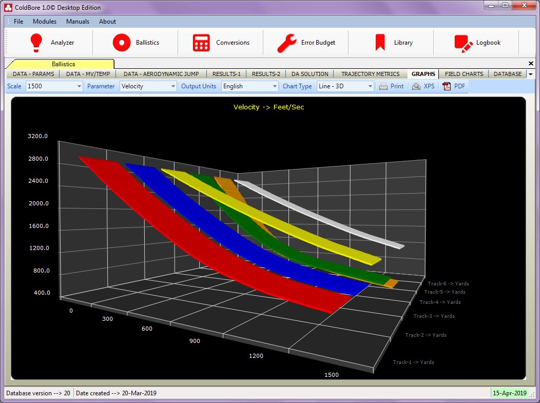

Well, I tought you can do a side-by-side comparison like in Coldbore getting both, a tabular view and graphs, 2d, 3d. By opening multiple instances what you get is a crude way to compare the data, so I wouldn't say AB can do comparisons per se

You can do a side by side comparison. With a dozen or more profiles loaded. Including Weapon Employment Zone (hit probability) and more. Using radar data, and CDMs instead of G form factors.
Ok but how? if you mean opening multiple instances that's really crude, and not what one would expect or understand by "side by side" which is a pretty common scenario that doesn't have multiple but just one possible interpretation.

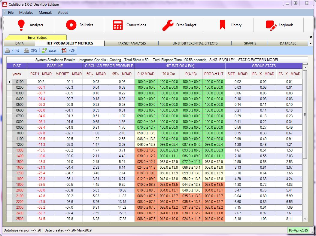

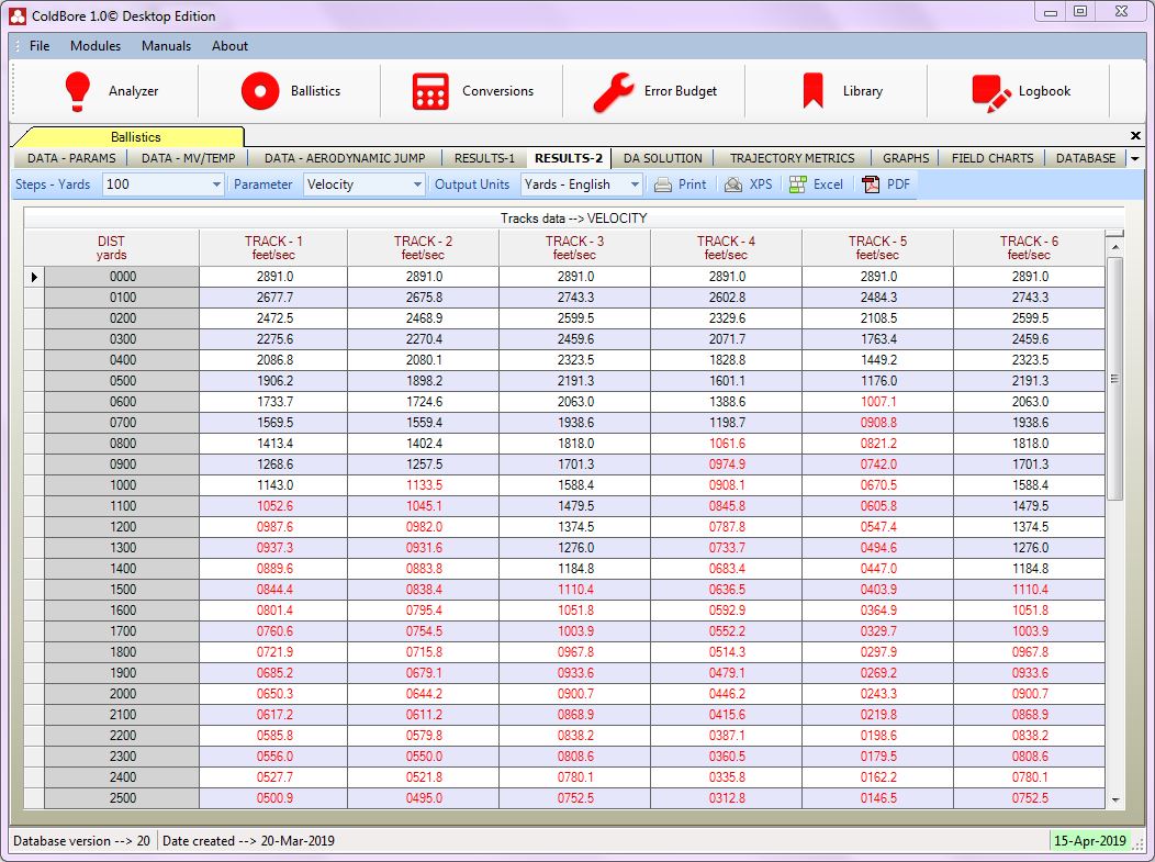

The point is not about the data source (CDM or G) it's all about what the software can do on its own, like exporting a table to Excel ( with Coldbore I can export any data to Excel, does AB feature the same?). In short, it's a feature which is present or it's not. If you have to open multiple instances how can you get a single picture or tabular view of all the data together in just one single view? It's not hard to grasp. If I'm wrong please show a single view of multiple data at once from within the software itself.

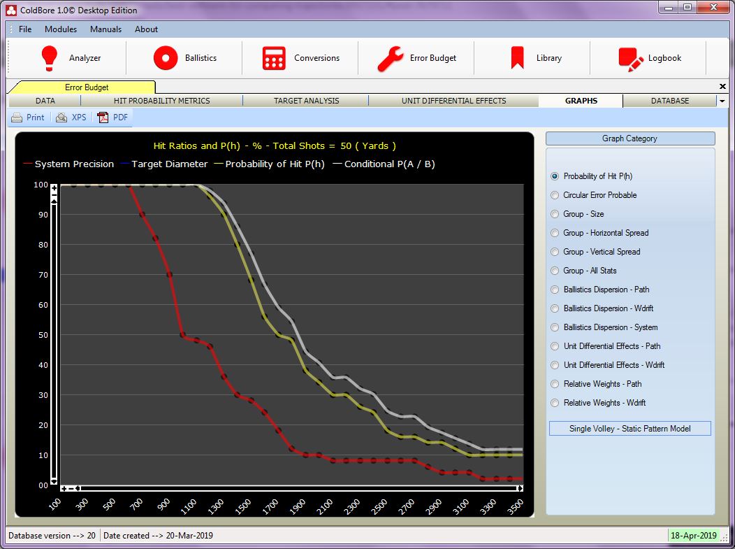

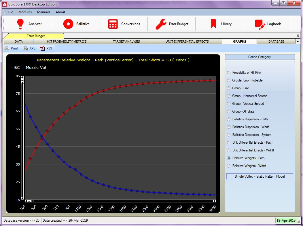

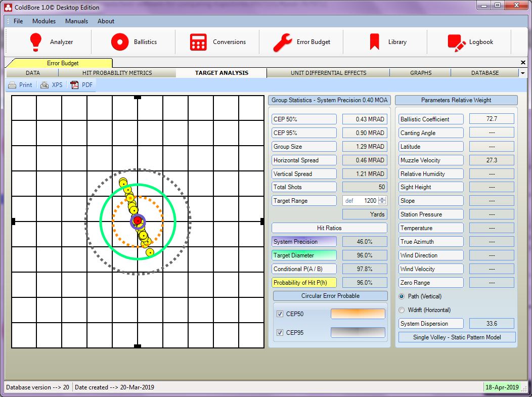

In Coldbore you get the Error Budget module a really powerful to analyze a lot of things, including but not limited to Hit Prob

Well...No, the user asked for "What software is the easiest to quickly compare two loads/bullets/velocities etc side by side graphically and with drop charts? " which is a very simple and straightforward question.
So, CB does up to 6 loads at the same time, side by side, and it's clear that AB does not, being a one-load software not capable of the same.

Does WEZ do CEP, target analysis metrics, Relative Weights, Singe and Multiple Volleys, Unit Effects, Confidence Levels, etc? Interested to know more about because what I've seen so far is pretty limited to Hit Prob and basic additional data.
