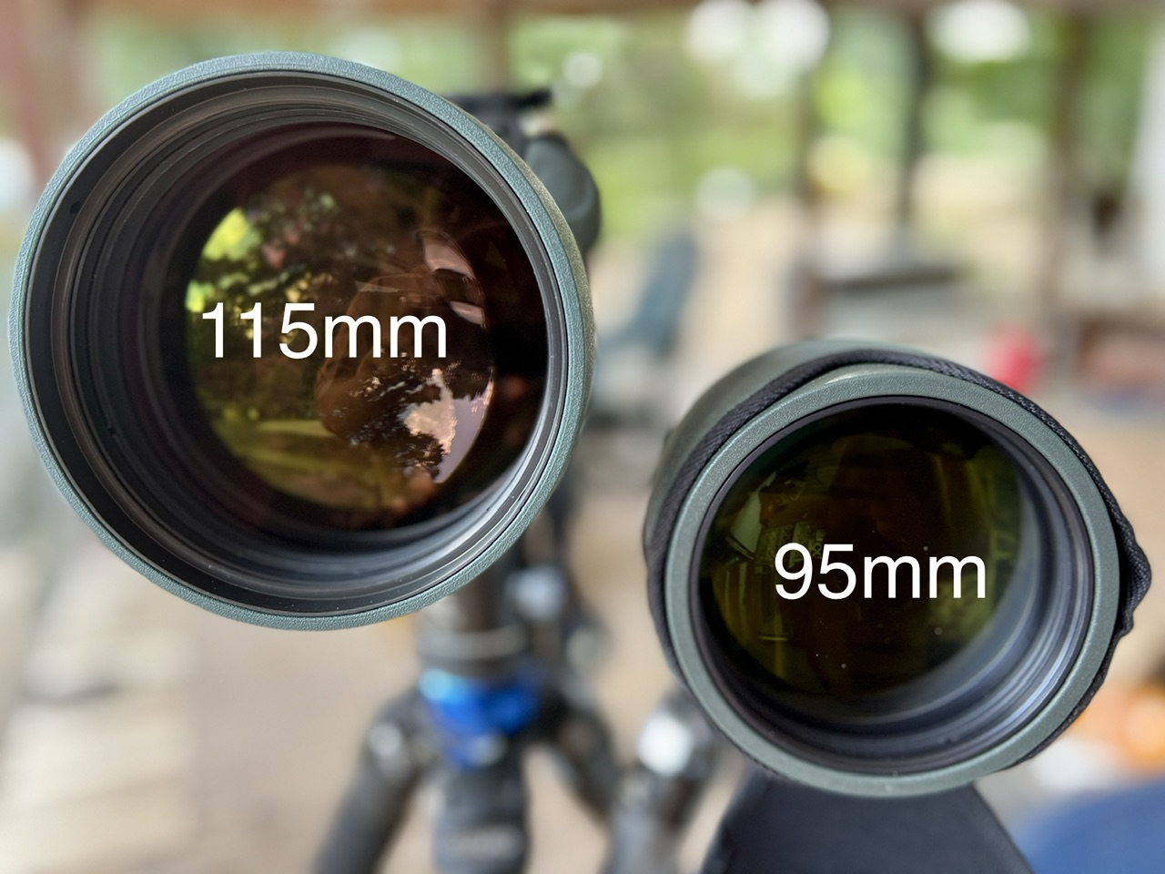

Swarovski has more options and features.
They're available in 85, 95, and 115 mm and you can get a binocular-style eyepiece for them.
I would love to own their 115mm but last I checked, the price was $5,700.00 with the standard eyepiece.

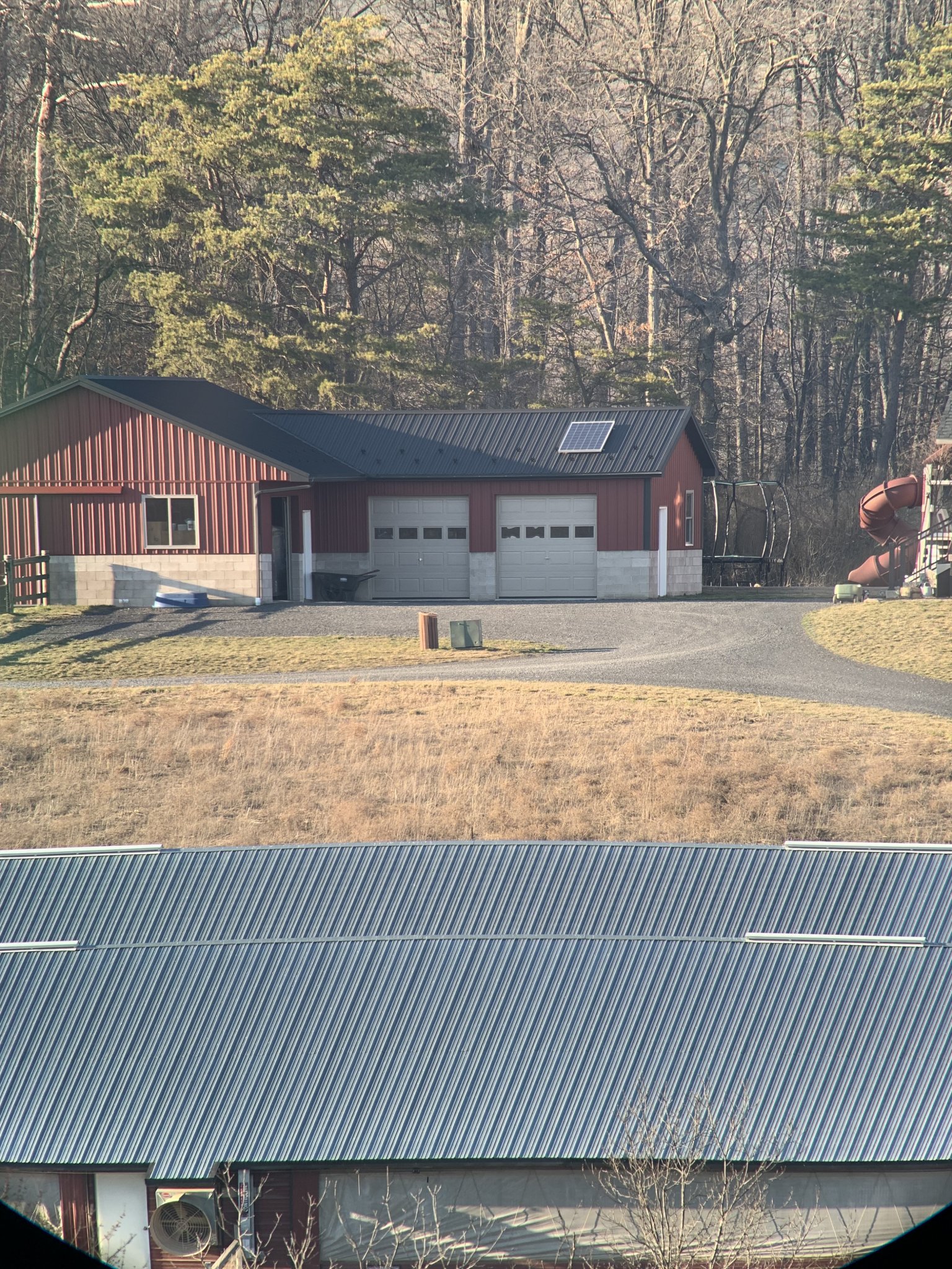

Update (12/16/22): I received the Swarovski STX 115mm scope. Much bigger and heavier than I expected, at least compared to my older Athlon Optics Argos HD 20-60x85 Spotting Scope I already had. In the first test, I set it up in a back room of my house overlooking a field, with lots of pine trees, which block most of the view beyond them, which is followed by a big lake. To see to or across the lake I have to look through a few small gaps in the trees. Trees are about 50-100 yards away and block most of the lake. But in the sparse and limited clearings, I can see across the lake to the other side (at least a mile away according to Google Maps).
I was able to see a 3-4ft white heron stalking prey in the marsh reeds across on the other side of the lake (at least 1-mile away) pretty clearly. I couldn't see the color of the bird's eyes, but the bird itself was pretty clear and big. My wife was amazed. And the bird definitely was not visible in the slightest by open eye. You have to strain to see the other side of the lake at all...it's mostly a blur. So, to see the bird that clearly was pretty amazing. In the Swarovski spotting scope, it was looming large...taking up 1/4 to 1/2 of the entire view (on nearly full magnification). You could easily see individual features, flaws in the feathers, and so on. We could see it get a small fish and hold it in its beak before swallowing.
And this was on a very overcast day, with light rain, and pretty low light. We had a big damaging cold front just finish moving through at the time. So, I would think that this would be among the more challenging days to spot anything long distance (other than mirage issues). At the same time I think if anything is going to get you an image it would be a Swarovski with the 115mm lens diameter objective. And this seemed to be the case...at low light we clearly saw a (big) bird at least a mile away.
After trying out my new spotting scope, I tried to put up my older Athlon spotting scope next to it to compare, but the heron was gone by the time I got the Athlon set up and I couldn't find anything else small to target on...other than back of some houses on the other side of the lake. I added the ME 1.7x to the Swarovski, but in my initial tests I couldn't tell how much magnification it added. It didn't appear to me to add that much (although I'm sure it does)...but the light, was as expected from adding magnification, even further cut down...so I don't know, in this testing scenario, if it improved things. If the bird was still there it would have been easier to see. But I was having to focus on the back of houses on a lake, so all I had was some larger framing, architectural elements, etc.
I did put up my old Athlon scope to focus on the back of the houses and was surprised that the images I saw weren't all that different magnification-wise (with or without the ME 1.7x). I'm sure it was different...but I just couldn't easily tell just randomly moving back and forth between the two scopes. So, that cheaper $350 Athlon scope is holding its own.
With that said, I assume the better Swarovski glass and the far bigger lens objective diameter will make the Swarovski a clear winner over the Athlon when I test it out on the range tomorrow. I'm going to point both of them out to 100, 300, 800, 1000, 1750, and 2000 yards and see the difference. I'll report back here what I saw.

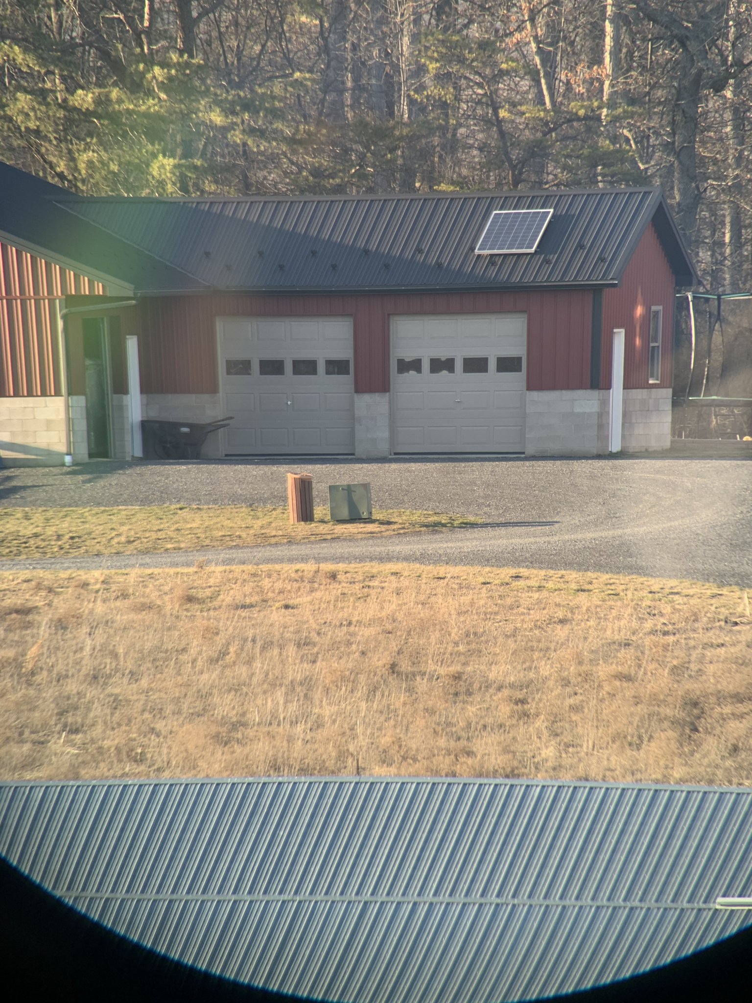

One thing to be aware if you were spotting through window glass. Some window panes in my house are definitely wavy and make good optic’s images look like crap. I open the window and voila, crystal-clear images pop out of the same optic.
Even good window glass is going to knock down the spotter’s resolution and contrast somewhat.
I did another test just now out of window and through the forest and over the lake today. I found a good, what looked like 4'x6' sign with writing on the other side of the lake (again just over 1 mile). Both the $350 Athlon spotting scope (max magnification is 60) and the $5000 Swarovski (max magnification is 70x) easily displayed it. Typical FL weather today...with a fair amount of mirage showing up...which surprised me because I'm viewing over a lake and not over hot ground. New lesson learned. The Swarovski had the better image in both size and clarify. I've seen the sign before with my Athlon rifle scope (Athlon Cronus BTR 4.5-29x56) and it contains a message...with fairly big letters, 6 to 12 inches, but with both the Athlon rifle scope and the Athlon spotting scope I could never read the message. With the Swarovski, I could easily read the big letters and I was able to, with straining, to make out the smaller letters. I put on the ME 1.7X to see how that changed things and it definitely made the sign and letters larger, but it also made the letters slightly less clear and a bit lighter in color. I'm guessing this loss of definition is expected. I found myself wondering which (with or without the ME 1.7x added) I would use at the range for which situation?
That is great to hear. It's all about the size of the objective lens (and glass quality, of course.) At 2000 yards, with the 115mm objective, the smallest object that can be resolved is about 0.35 inch at 60X magnification. Adding more magnification only makes the objects bigger, it will not bring in more detail. More magnification beyond 60X is great for targets and aiming, and all that, but not for birding, as you discovered with the 1.7X extender. The letters are bigger, but they look softer because of lack of further detail.
And as you know, IQ will degrade rapidly with conditions.

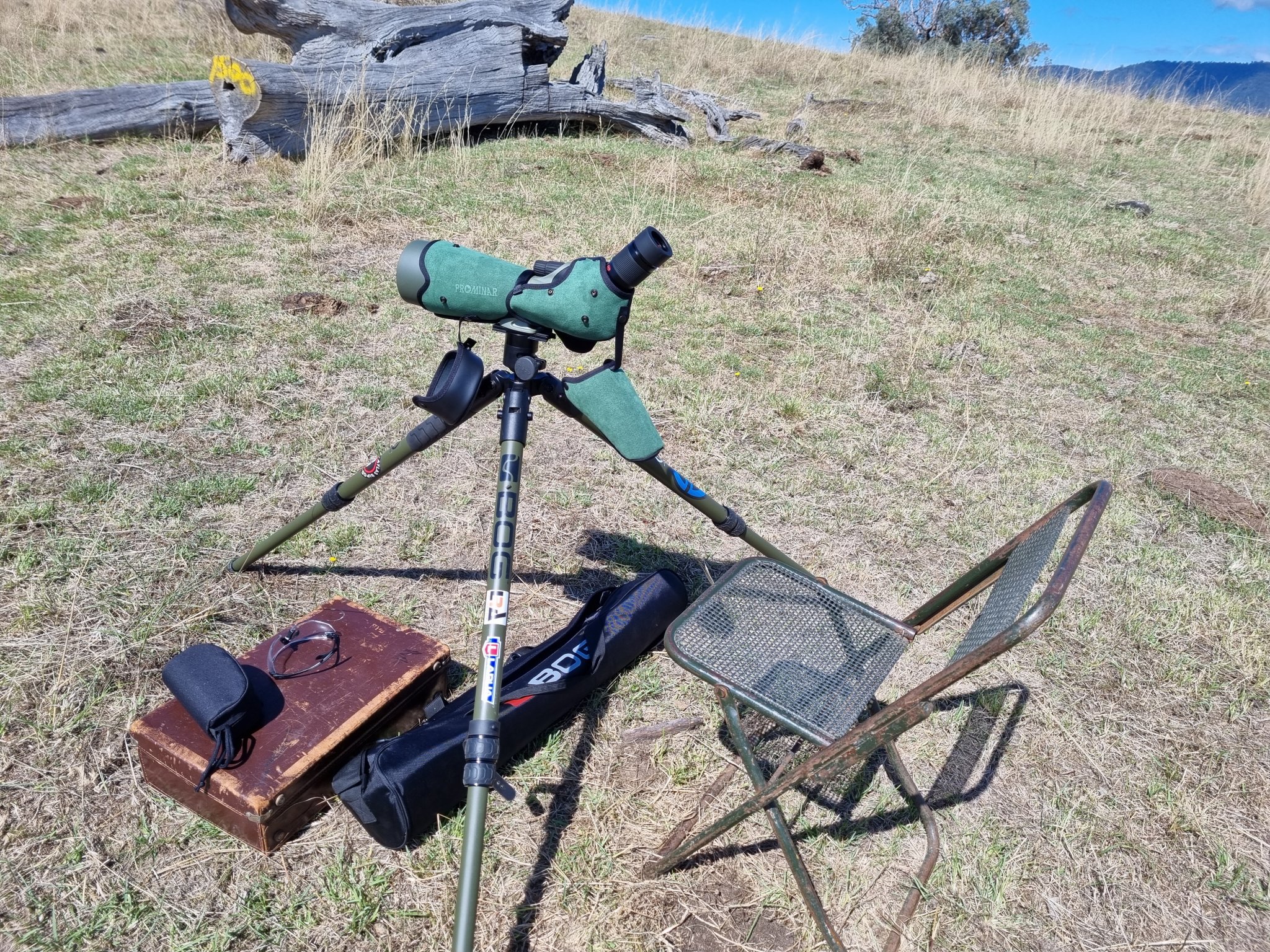

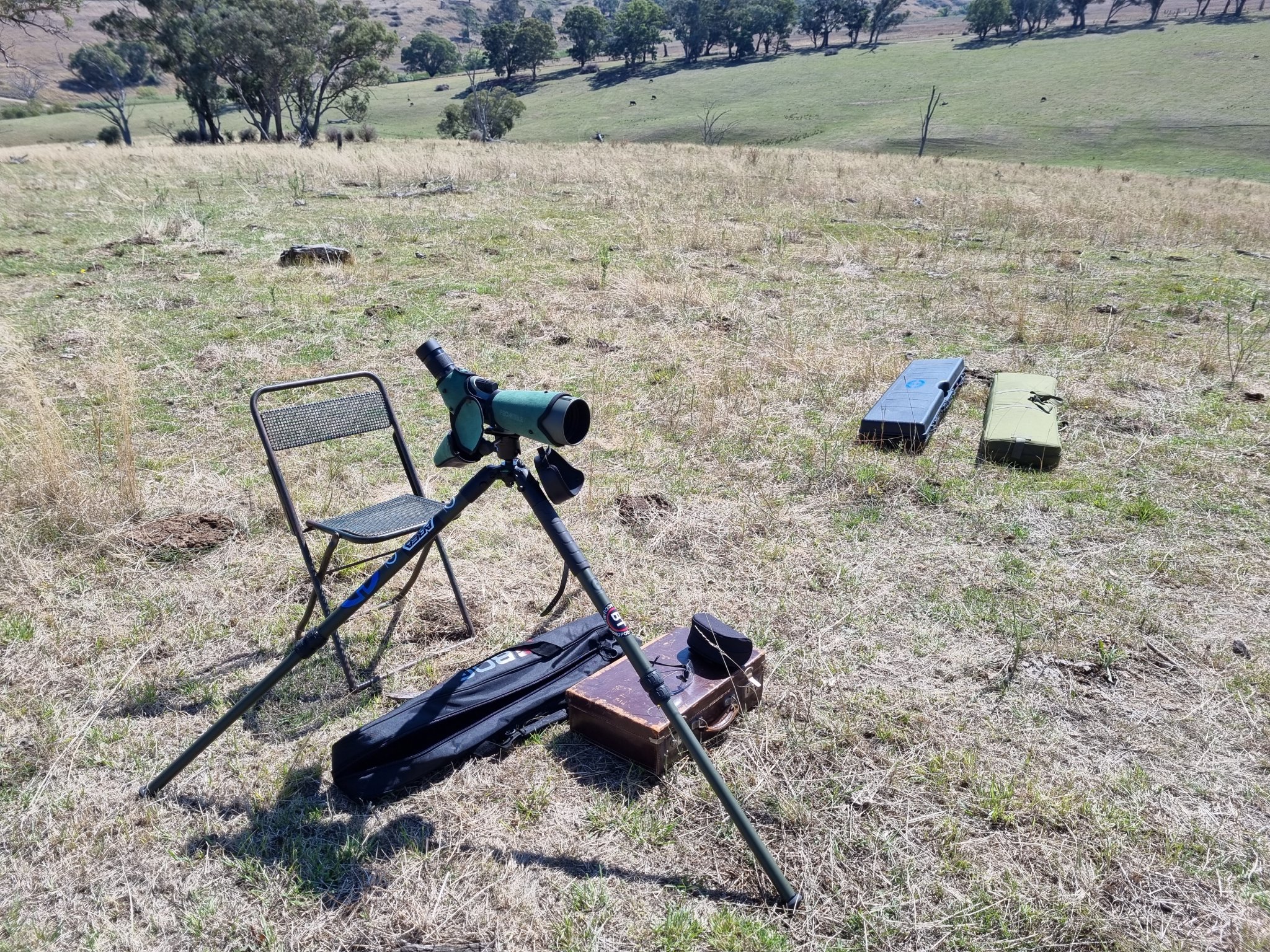

For Christmas, my wife gifted me a 1.6X extender for my Kowa 883, along with Kowa's newest eyepiece, the TE-80XW. This last one is an extra-wide angle eyepiece at a fixed magnification. It's made for the Kowa 88x @35X and the Kowa 99x @ 40X.
I'm very much into digiscoping with my Kowa and my Nikon D7500. I'm looking forward to digiscoping with the 80XW.

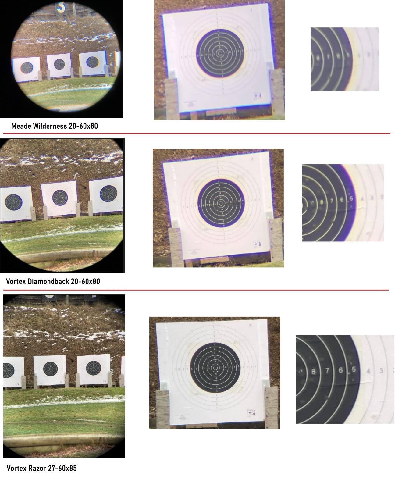

I did some tests on a couple of different spotting scopes people in the shooting club had(300 meters, targets is 1x1m i think). The price roughly doubles between each spottingscope, but chromatic abberation, sharpness and field of view gets progressingly better. Hopefully this can be some kind of guide as to what you actually get with the different scopes.
(images were taken afocaly with Iphone, and were all looing a bit better IRL)
this is an incredible comparison sir, bravo. perfect for showing a newcomer on what to expect from different price points

Swarovski shows up a lot because it is the reference standard by which all others are judged. Kowa is great. Hensoldt is great. Leupold is good. Vortex is good. But Swaro has a Rainbow Unicorn pee on every unit before it leaves the factory, giving it that intangible magic that makes them so damned glorious. No one ever regretted buying a Swaro.
I have both the 95mm ATX and 115mm BTX. They are magical. 115mm wins by a nose, and the BTX eyepiece is magical. You can sit behind it with your face planted to it all day long with zero fatigue. Only downside is size. It’s not something you take on a hike, but something you sit behind from a fixed position.
