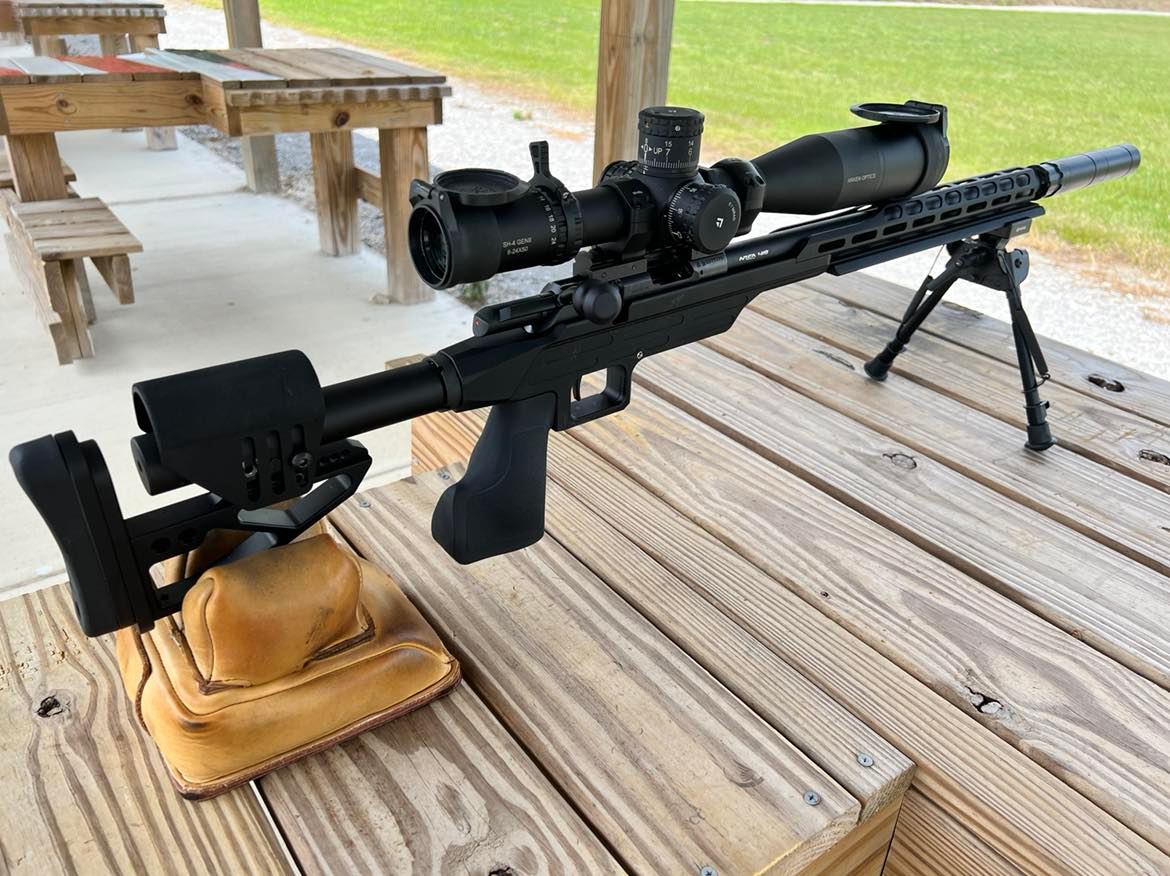

I picked up the XLR Element 4.0. This adds the integrated arca rail in a light chassis. Add the ERGO vertical grip and you have the best rimfire setup available IMO.

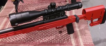

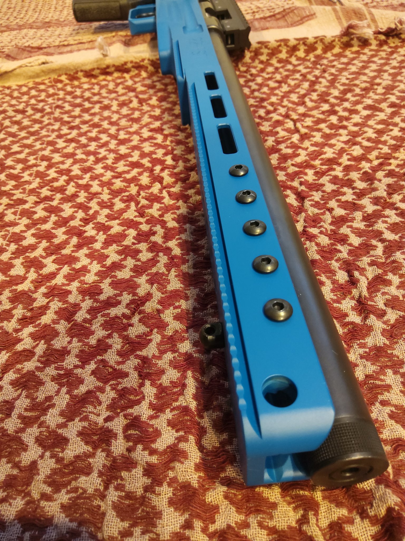

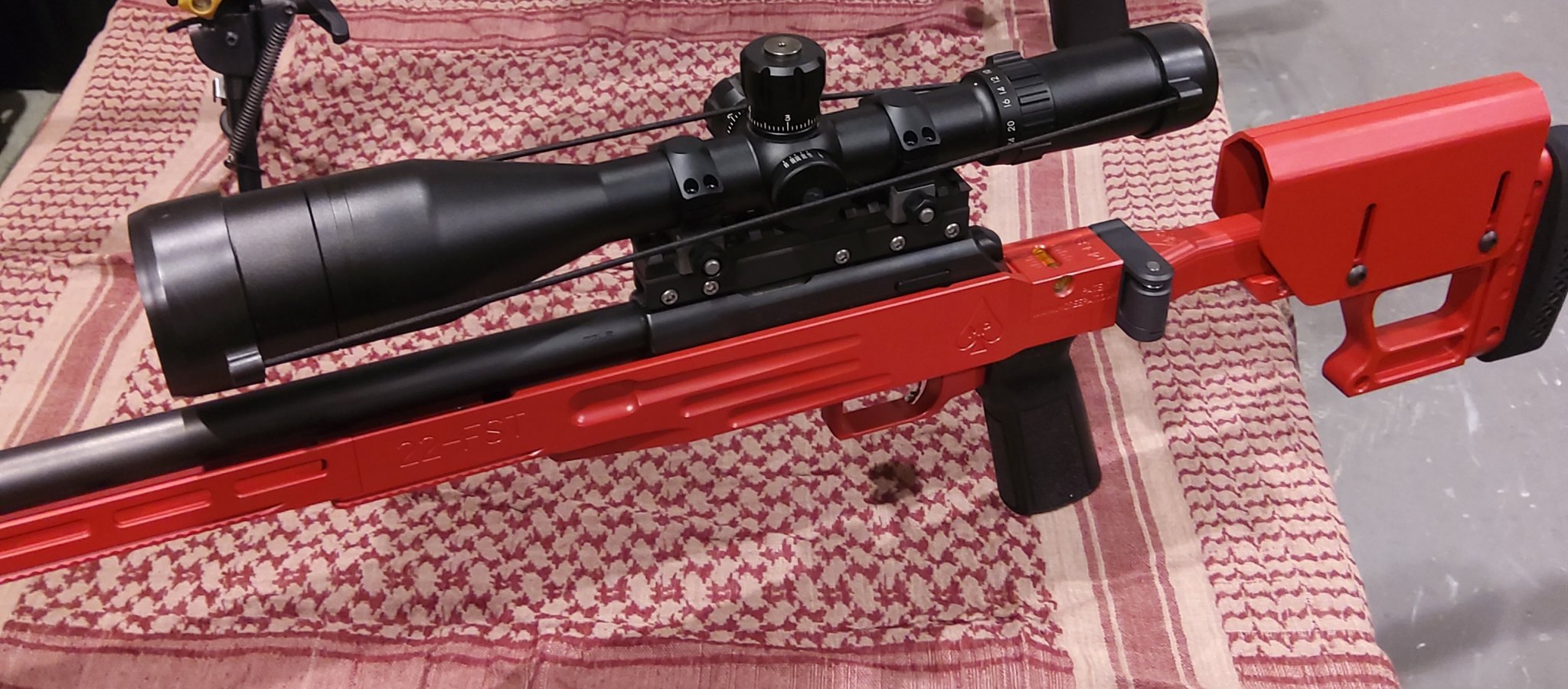

I picked up a great quality chassis from Grey Birch. Fits perfect and great quality.
I paid around $600 Canadian delivered.

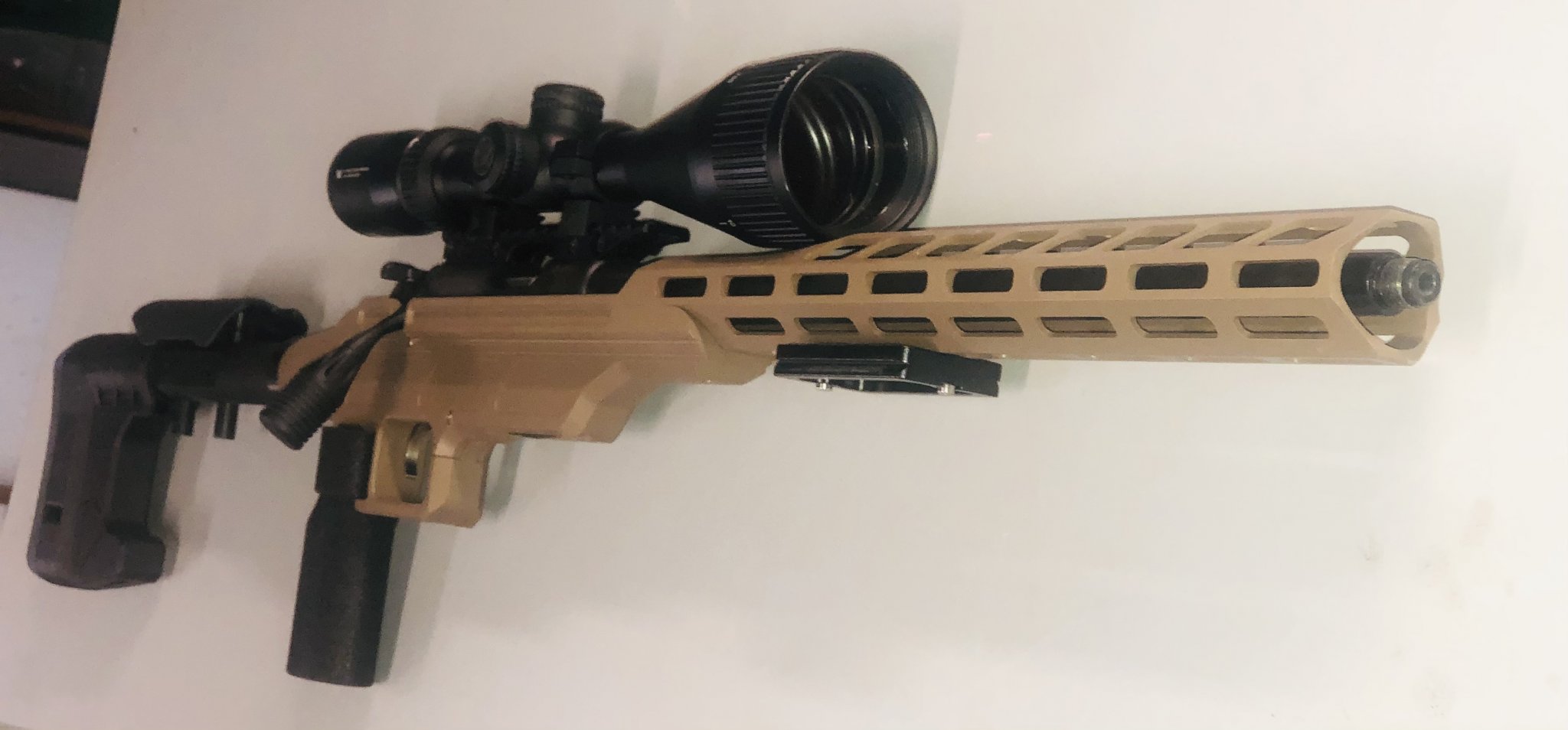

I put my son's 457 in an XLR Element and it's been a great setup. We couldn't be happier with how it shoots.
What's the barrel length and rail length on that? How much room is there between the rail and the can?
I'm Liking the rigid.
The barrel is the Area 419 Lilja 18.5" threaded barrel. The Handguard I picked is 13.6" in length, the barrel sticks out 1 1/4" from edge of handguard. I had plenty of room for the suppressor to be threaded on. There are two choices for the handguard (12" or 13.6").
Reactions: sam4886
Thanks. Looks like I'd be better off with the 12" for my 16" factory barrel.

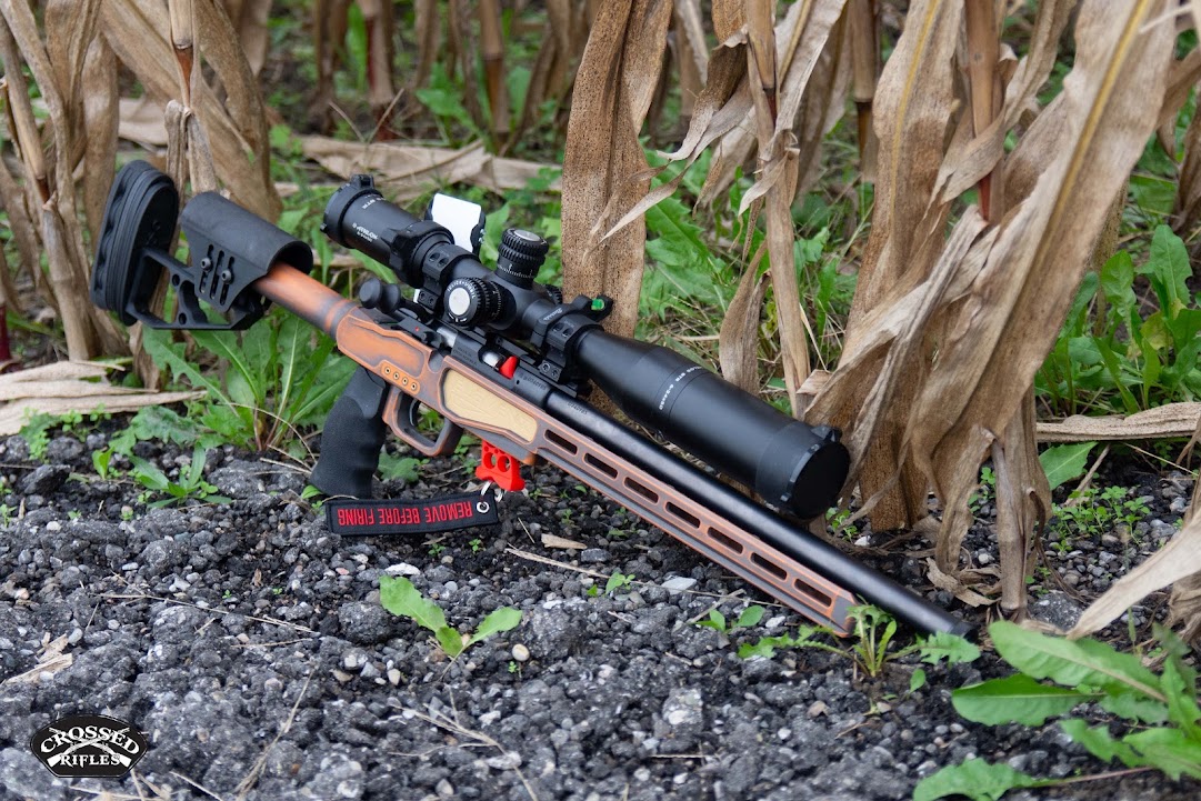

McRee G10 on mine, but they are $600. I sold the factory wood ones to offset part of that cost.
