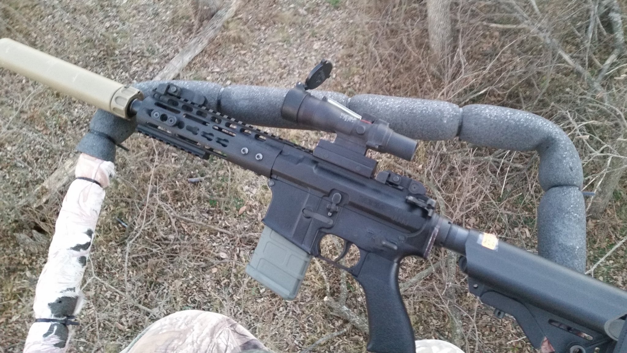

I have had good luck with Hornady 208 A-Max and Armsco which uses the 208 A-Max bullet. My favorite sub sonic load is the Hornady 190 Sub-X. It expands better and has enough penetration without over penetrating.I run it in my 8.5 SBR.

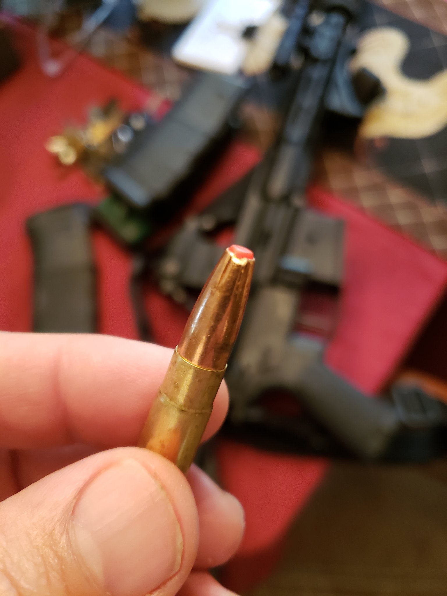

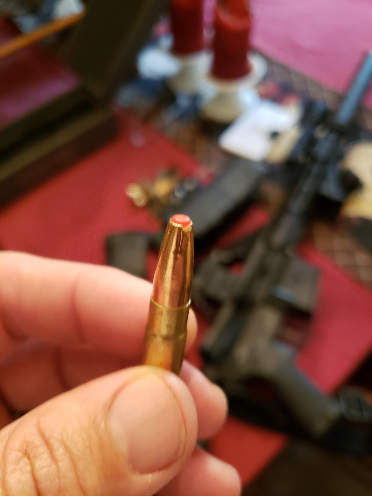

I did not have very good luck with the Hornady 190gr Sub-X like ARx3 did. My Aero M4E1 upper/lower with a Ballistic Advantage 10.3" Performance Series barrel did not like to feed it very well, and I tried three different types of magazine including the P-Mag 300BO mags. My issue was the copper part of the bullet just past the flex tip insert would get caught on the feed ramps and would not chamber. This happened several times including once when I had a huge sounder cornered in a field surrounded by pig fence after they found an opening and could not find their way out. There I sat 10 yards from 20+ pigs with a rifle that hung up round after round... I was not impressed to say the least. They fed when there were only 5-7 rounds in the magazine, but once loaded with 10 or more not very well at all.
I tried filing the sharp edges of the feed ramps and while it did help some they would still miss feed every 5 rounds or so. With that being said they were pretty effective on the pigs that I did hit when it fired, but not much use being effective when they do not feed reliably.

I may do some more work to the feed ramps once I get home from deployment (whenever that may be now). They are just catching on the sharpish corners of the ramps as they try to chamber. Couldn't hurt to round them a little more and the rounds did seem to work well when they connected.
