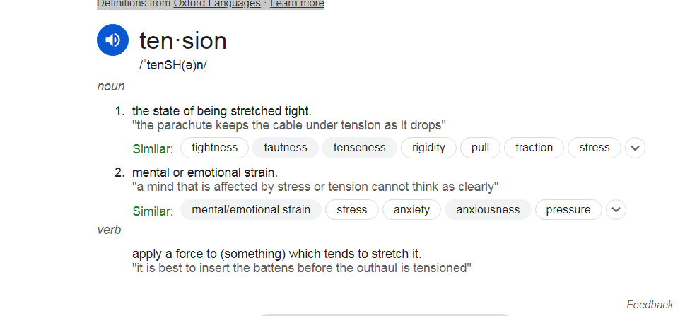

We as a community aren't great with terms honestly. I've been trying to change "neck tension" to the proper term of interference fit for quite a while without success.
My advice would be don't take advice from people on here who have been banned a time or two. My opinion listening to podcasts that pro shooters put out are almost like drinking from a fire hose for free. Lots of great techniques to learn from pro shooters content. Stability will come with time and repetitive practice. Do what you are comfortable with and just go have fun. Remember your biggest competition is yourself.
A STATIC FRICTION fit is created because of TENSION created between the bullet and the undersized neck . A person educated on this laughs at all the other petty bullshit .
A FRICTION fit is created because of TENSION the bullet puts on the undersized neck .
Swing and a miss yet again. The undersized neck isn't the only thing that contributes to the "tension." And, when people speak about "neck tension" in regards to ammunition, they are almost solely referring to the ID of the case mouth. Hence they are referring to the interference fit.
Which is why you can have two pieces of brass, with the same ID, but different neck wall thickness or lubrication, etc, etc. and they will have different seating and release measurements.
And if you want to get technical, tension isn't even the correct word for the stretching of the case neck when the bullet is inserted. Physics 101 definitions at play here. You would never use the word "tension" when referring to a friction or interference fit. Your interpretation of what you think you found on google is completely incorrect. Tension does not have anything to do with the friction. Tension force is only a pulling force. So you need a rope, chain, cable....etc. Since tension force is unable to push.
Friction and plastic deformation would be the two major things going on when you insert a bullet into an undersized neck.
Though I'm sure I'm mixing something up here. I'd defer to someone like @308pirate who is formally educated in such matters.
Thanks for playing.
Thanks for playing.
Nice try , and nice spin . Funny , you have been quiet lately . Sucks when people realize you are a fraud . Great business strategy . :ROFLMAO:
