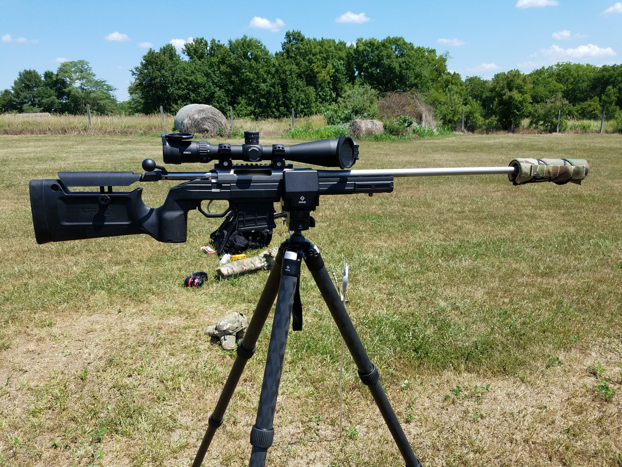

Anyway, I can shoot sub moa groups very consistently off of my RRS setup, but I want to know if anyone can shoot consistent .75 or better. Anyone down in the .5 moa range normally? I occasionally manage .75, but can't say it is a legit capability of mine. I test this on paper at 100 and 200, as well as on sub moa steel at 337. I have shot much further on a tripod, but it wasn't my range and I don't believe any of the targets were sub moa. Probably more like 2 moa.
The RRS is awesome, as all I have to do is clamp my gun in and go. With my old setups (Manfrottos and PIG's) the only way to get moa was with a sling and more practice than the RRS takes. Furthermore, with the RRS, it doesn't seem to matter if I use the Vyce, or go direct to the Anvil 30. Same results either way. I had hoped that the Anvil 30 would get me a little more precision, but again, maybe I'm not optimizing what I'm doing.
So, for those of you who love shooting off tripods, how precise can you regularly be? What technique allows you to shoot your best?
The pic is of a loaner tripod that convinced me to switch to RRS. Pricey, but awesome. First time I ever shot sub moa standing without having to sling up to the tripod.

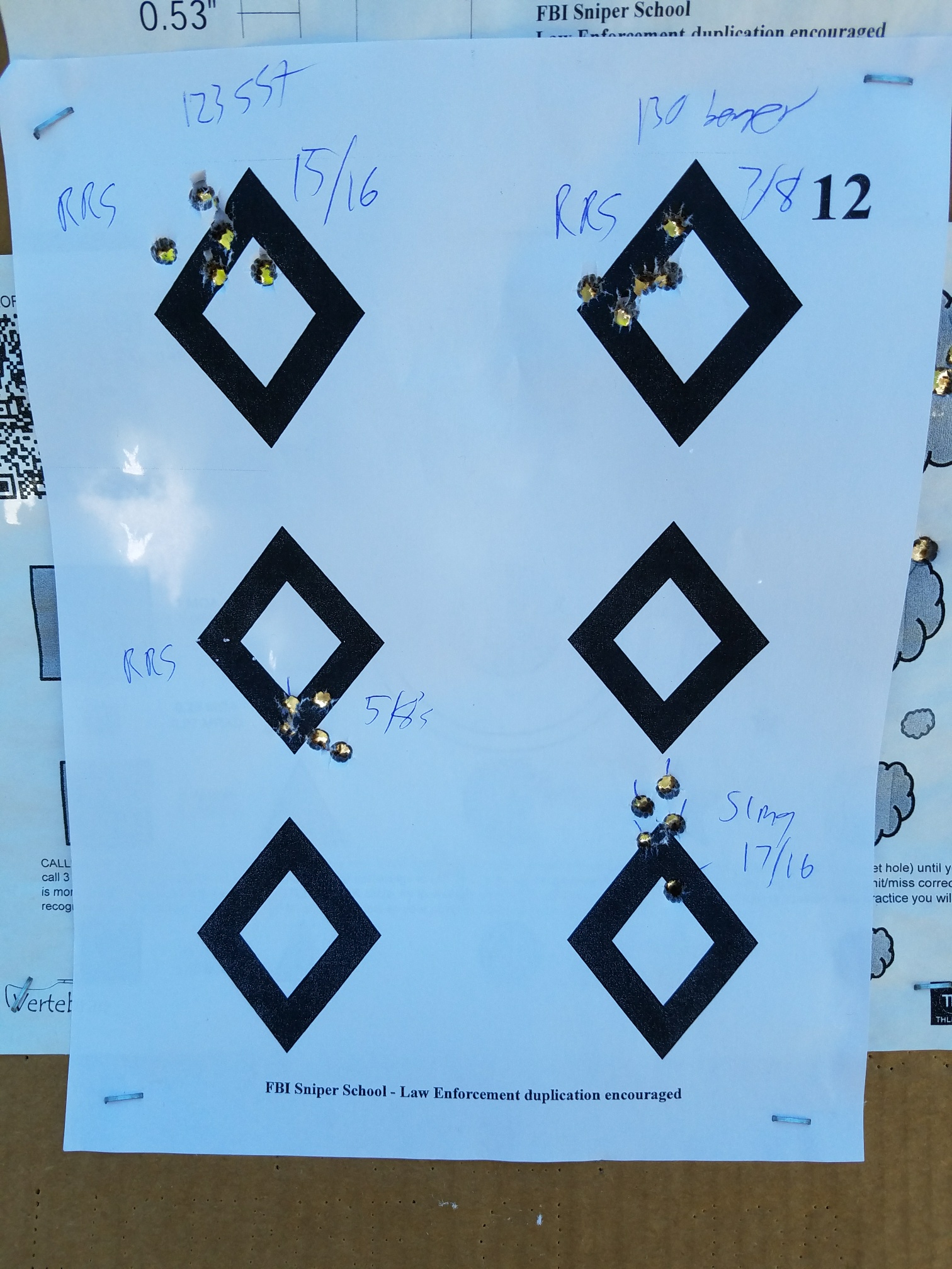

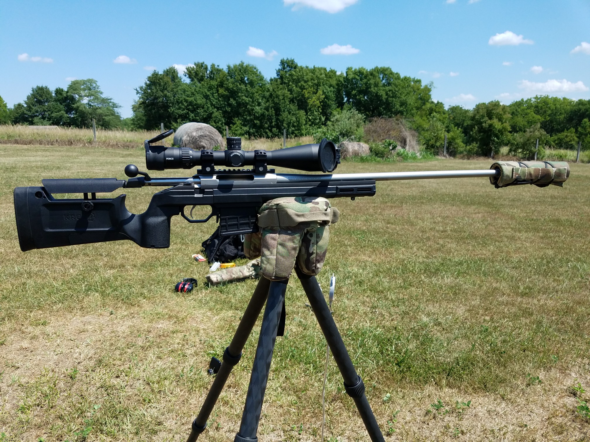

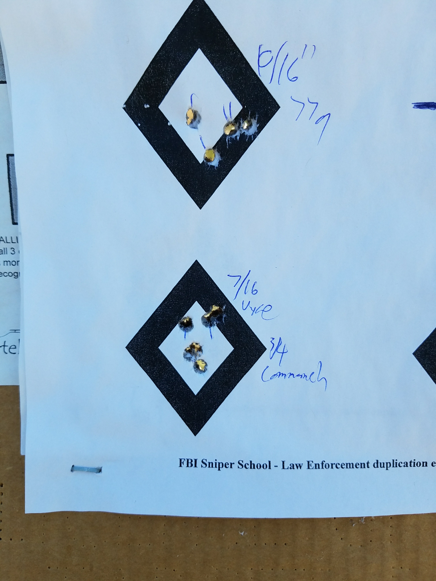

Went out a few minutes ago and shot this target with a 6.5G gas gun. Should be readable, but I know I should have been a Dr:)
This was done at 100 yards, standing with the Vyce on top of the Anvil 30. I'll have to throw a pic rail back on the rear of the handguard and see if there is any meaningful difference with just the Anvil. Based on my other guns, probably not.
The top left group was 123 Hornady SST. The top right was 130 Federal Bergers, the 2nd down on the left was 123 SST's, but loaded from Precision Firearms.
My sling group was with a Tab Gear sling, and it was really too tight. This was traditional prone shooting with a sling, not off a tripod. used the 123's from PF. Shifted my group pretty far down from the diamond I was aiming at.

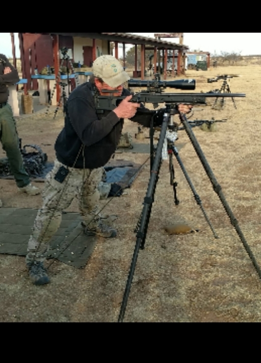

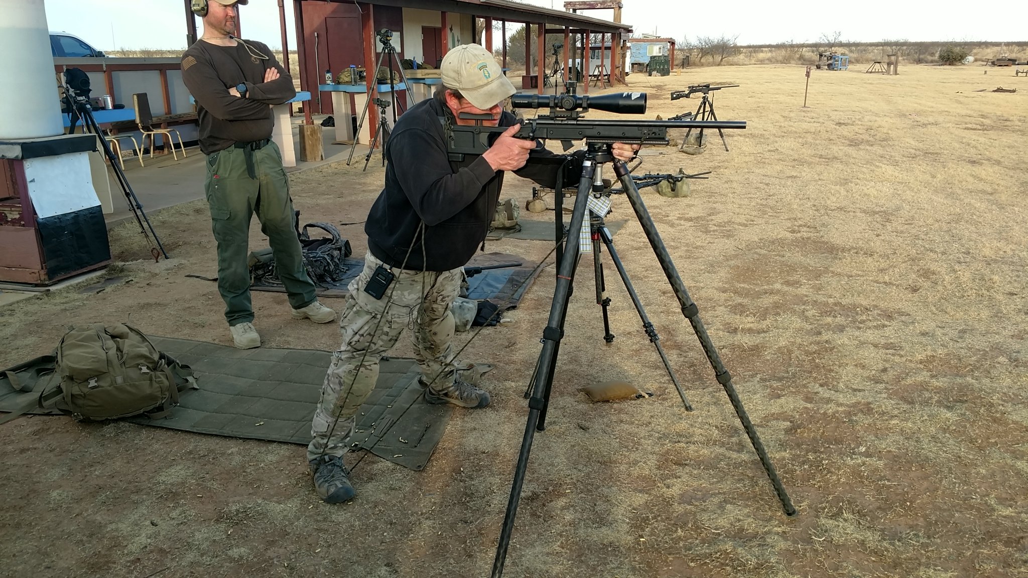

That's my buddy shooting off the tripod sitting at 600yds. We hold the opposite side of the tripod as shown, to keep US steadty as we are usually shooting off the sides of hills and it is either use a lot of torso muscle to keep us upright or grab the tripod. I invented this technique on that day, to keep myself from rolling down the hill. But subsequently, I've seen pics of others doing it. I've also been told it is a bad idea. But, we unfortunately, stick with what works for us, bad idea or not.
The farthest I've been able to get on my land sitting, is 730yds. Can't quite see the target from 750yds unless I go standing.

ETA: Just realized your tripod, you have on leg towards you and the 2 legs towards the target. Turn it around to where the 2 rear legs are perpendicular to the target, the recoil comes straight back versus diagonally.
For some reason, I can't see pictures in Wig's posts. They came through on my email notifications though.
Kopfjager1,
What is the size of the dots you are shooting at? IIRC, they should be around .75 moa. Does that sound right? I'll have to try them with the tripod.
If you are referring to my photo (in regards to leg positioning), it is actually set up a bit differently, but the picture is deceiving. That tripod is George Gardner's, and he uses a technique where he off sets the legs, so that his right foot can be on the inside of the back right leg, and put tension on it. That is what I was trying at the time, and though it works, it doesn't seem to work better than what I'm already doing.
Also, though I agree with you in theory about the one leg forward, in practice, up to 308, I can see no difference in accuracy or recoil control with one leg forward or with two legs forward. I usually go one leg forward, but for various reasons, I switch it up from time to time.

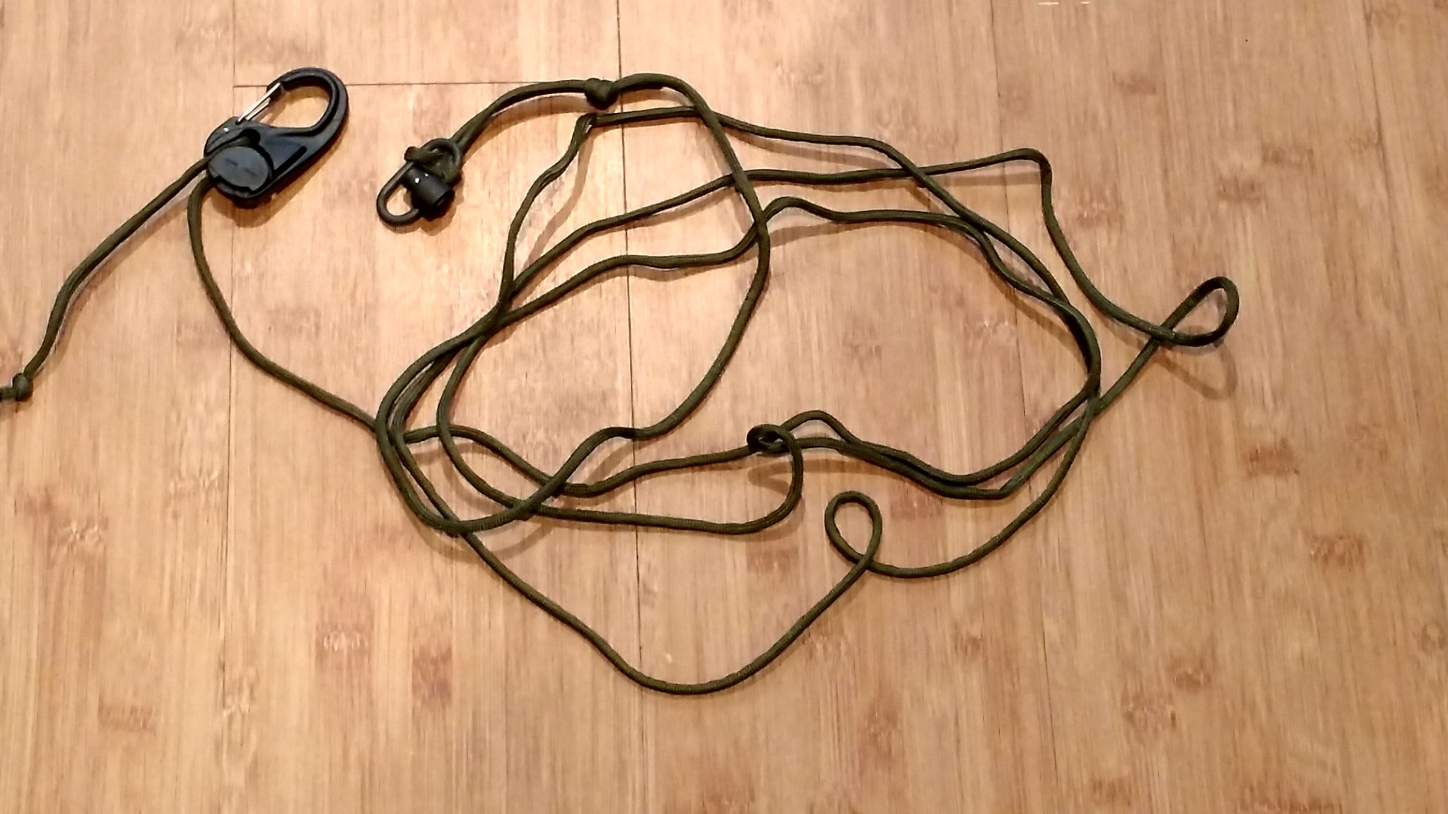

There are lots of good slings out there, but you do not need a riggers belt or biner to make them work. You can usually just slip them through your belt and tie a simple knot. Given the level of performance I'm seeing from the RRS setup, as well as the cons you mentioned, I no longer use a sling for any of my tripod needs. If I had to go back to a hog saddle on another tripod, I likely would go back to using a sling in some instances.

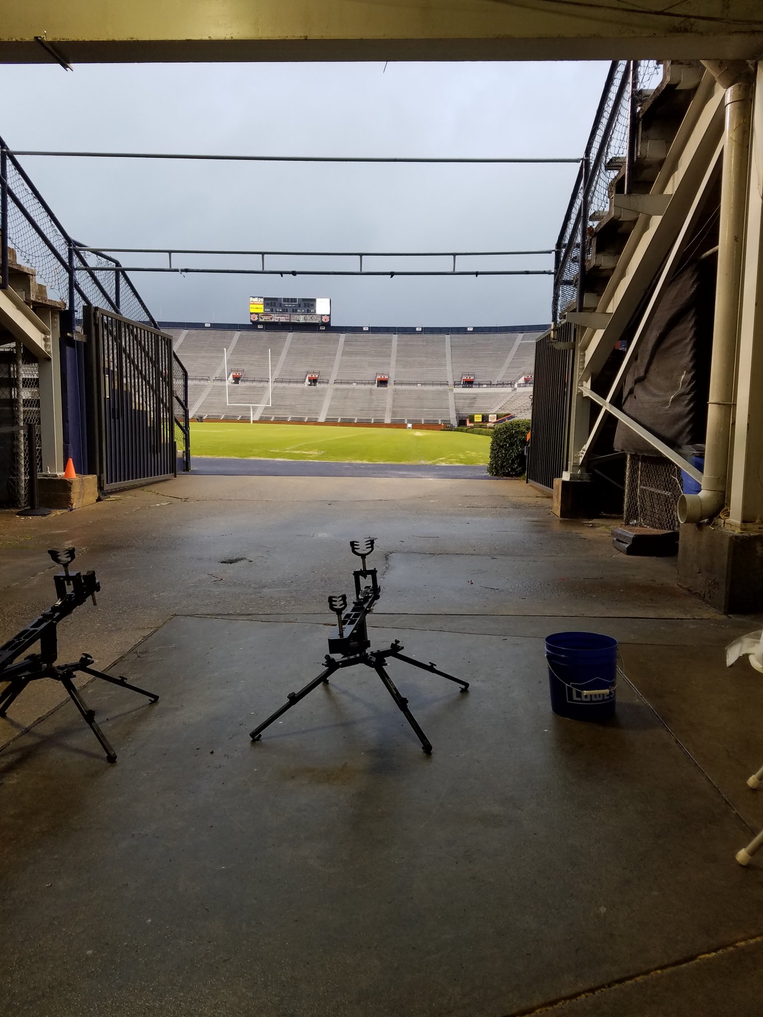

We took an advanced class by TACFLO, and........
Barrett m82.......
We used a tripod and a quad pod because....
The m82 was too heavy to hold up for any length of time...
Every shooter had to find the recoil control method that worked best for them, based on their strength and body mass.
It's one thing to use a "great" tripod technique on a fixed range straight on target.
However.... when you have to sit in a place watching for the target to appear, here or there, bipod, tripod, or quad pod, being able to shoot the system left, right, or straight very quickly, depends on the shooter and their ability to perform the fundamentals quickly.
With that said...
The barrett suspended by rope from above, was the most challenging, made us appreciate the tripod or quadpod.
What worked for my 200+ pounds didn't work for my runt team members 165.

The class was about "public venue".... like a football stadium or whatever.... there were a lot of high angle shots involved. Bmg didnt go in stadium though. :- )
Quad pod is a pain in the ass. 4 legs to set. Tripod is 3... unlevel ground and speed, does not compute.
Uncle Mike's bipod shooting sticks are the fastest thing we've found for unlevel ground. Set rides in the cart every trip. Been that way almost 3 years.
For us it's not about shooting groups off a stick-thing, its hitting 'and killing' the target in 3 seconds....
A solid set of fundamentals using two hands, two arms, two legs, and one body and being able to put the weapons system on target and bang in 3 seconds beats the use of any "crutch" gear.
Use of any gear as an "assist", versus a "crutch" is an asset, much dependent on mission requirements, need of speed, and terrain difficulties.
The quad and tripod worked much better for us on observer duties versus field. I never found any competition that really gave us time to use quad or tri, and in thick junk, the uncle Mike's stick bipod was a pita, but in a pasture or crop field, was the best deal.
Bogen monopod and hog saddle next choice. That's our mileage.

MarkCO, can you elaborate about your paracord cam lock technique? It sounds familiar, but I'm not sure I'm picturing it correctly.
I have shot off my commanche bag, on top of the tripod. Didn't really notice if it was actually better or not, as when my groups are smaller than usual, I often attribute it to luck, as in the pictures I posted above. I'll have to test again and see.
Been busy putting a .223 trainer together for my 10 year old. Loads of fun.
It is not mine SLG, I learned it from Brian Whalen. This is an actual picture of Brian from class. He is a great instructor and really improved my shooting tremendously.
You can see he has a piece of paracord attached to the front of the stock and the rear of the stock. He has a cam-lock, tightens it up so it hangs freely on the ground, then puts his foot in it compressing the tripod. I have a QD sling mount with a NiteIze clip as shown in the 2nd photo. Works great with my rifles.

Ok, thanks very much! That is what I thought, but I have typically used a sling to do that, and anchor it straight to my belt. Tension comes from the adjustable nature of the sling, as well as where I put my hips. With my older tripod setups, this was necessary to make good hits on small targets at distance. The RRS has spoiled me, and I'm trying to skip the sling stuff for now, but if he and you find that it helps, even with the RRS (as in the picture), then I'll at least try it for a bit.
Reactions: MarkCO
I found it helped a great deal, especially if getting pushed some by the wind. That is his .22Trainer in the photo, but I also tried it with Brian's .223 out to 600 yards and my .260 out to 1045 yards. I tried the sling and belt thing too, but it felt maybe 50% looser than the foot on the paracord.
The parts to make the paracord were all of $15, so in the world of precision gear, dang cheap. :)
Reactions: SLG
Well, then maybe the forces are different between the two techniques. I'll try the paracord, as shown, and see how it goes. $15 is way to cheap! Can you provide me with a custom ceracoted, titanium cam lock to go with some kevlar/spectra cord, in an elite tactical color??
Reactions: MarkCO
The forces are different. Part is in the triangulation strength, and part is in the angle direction of the pull force and recoil force.
Down force gives less recoil movement. Belt attachment enhances rearward recoil, you are pulling back and you recoil back.
Those forces disrupt npa, forcing you to be the "consistent" constant npa and fundamentals otherwise provide, and muscle strength erosion in a string removes your consistency.

I personally think this type of tripod or quadpod is useless.
Sure, it holds the rifle in position for overwatch.
Just like any clamp vice head does. Or m-lock or key mod attach head.
I have used them all with very unsat results.
More typing follows.
First problem.
Any bipod, tripod, or quad pod head that attaches, grips, or holds, or restricts, adds the bi-tri-quad into the recoil equation, added weight that changes everything your previous training taught you about how your rifle recoils in every other "human controlled" fundamental rifle presentation to firing.
The attached head, fights every attempt by you to create relaxed controlled npa, causing you to have to muscle the rifle into ffp. You guys in this discussion do far know this is not good. Muscling leads to muscle fatigue and inconsistency.
Bullsbags in prone or benched create the same opposing forces when muscling is forced with the same negative results.
So, the pictured quad pods should show the potential for loss of accuracy when firing for groups. Hope the above written is sufficient to provide helpful information.

Ran out and tried the Vyce again vs. the Commanche bag. I have the Saracen coming, which is heavier, but haven't tried it yet.
Not a practical difference, but the Vyce was tighter for the few times I tried them. May be my lack of practice on the bag, but I felt like the wind was blowing me around more with the bag vs. the Vyce. Only 3 shot groups, given the skinny barrel I was using today, so again, not worth drawing any meaningful conclusions off of. The bottom groups are with 73g Bergers, which is what the gun is zero'd with. The top group was with 77g SMK's which I am testing. That is 5 rounds of 77g, but only 3 and 3 of the 73's.

Diamond target looks suspiciously like from 11 page fb1 qual package...?
Bottom diamond looked pretty good.
Well, it does say duplication encouraged on it... Proper use of a work copy machine :)
I thought the top target looked better. Shows what I know. :-(
camloc ordered, but it looks like it will be next week before I get to give it a run.
