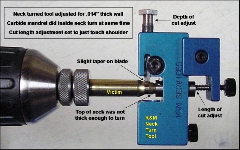

I like the K&M neck turn tool. They offer the carbide mandrel that inside neck reams at the same time you outside neck turn. It was good advice to go this route. In this pic I'm resizing some 223 brass to 221 and doing a final neck turn.
