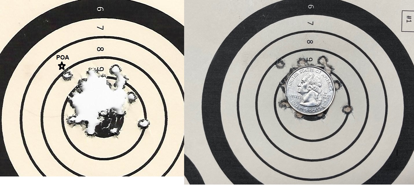

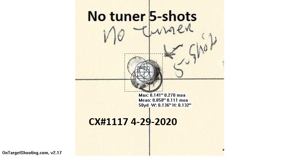

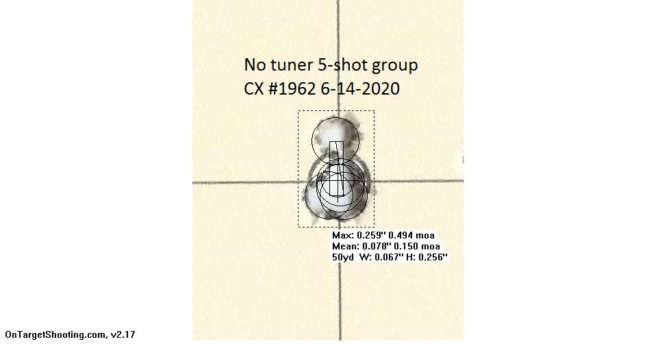

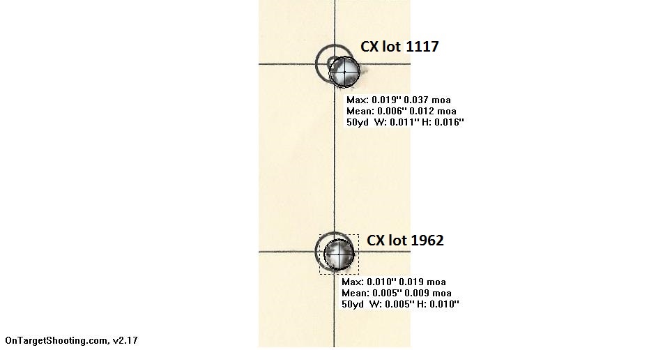

Here is a tuner test on Saturday of a 23.5" 1.25 krieger. You can see what a tuner will do to a straight shaft barrel. Tuber is a Gen 1 EC Tuner.
I'm thinking the target shows results of two or more shots at different settings, presumably settings that are incremental.
At the risk of missing the obvious, what does this target show? Is one or more of the settings showing the correct tuner setting? If so, is it repeatable?
The target test shows what 2 line movements per movement does to the groups. Most are 2 shots or 3 shots per setting. nd showing per revolution of the tuner. There are people that say Fat 1.25'" barrels are not able to be tuned. This target shows just the opposite.
