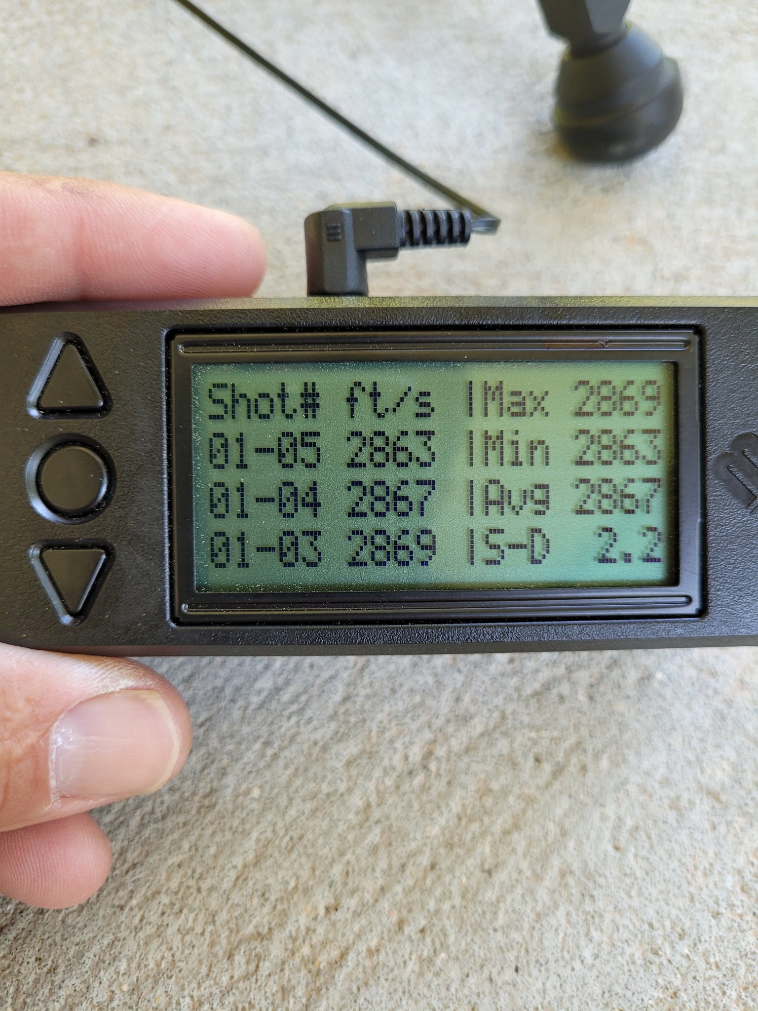

My Lyman does not have any slop, it did have a small amount of the box, but I saw a video about removing the slop on a turret press and then did the mod myself.
There's a spacer the center bolt goes through, in I think all turret presses so they can be tightened yet still turn. The tolerance on that spacer determines the amount of slop. If you take a piece of 1000 grit sand paper on a nice flat surface, and rotate the spacer every few strokes, you can remove just enough material so that you have virtually zero slop, but the turret still turns. If you go slow and test fit many times, you can get it extremely good while keeping a smooth turning turret. Good enough to make this ammo that I just shot.
