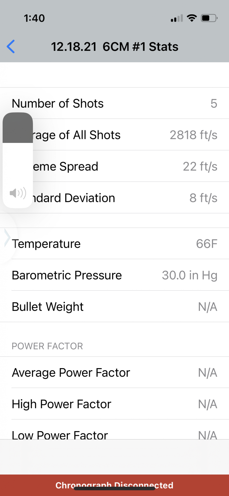

Turns out the shitty thrifty ProChrono DLX has a way better App than the expensive ones and gets the job done (for my rifles as well as my USPSA blasters).
I just use it like a tool to measure MV and ES/SD stats (which I then true up with a Kestrel/StrelokPro anyway)… which means I shoot my chrono rounds into the dirt (berm).

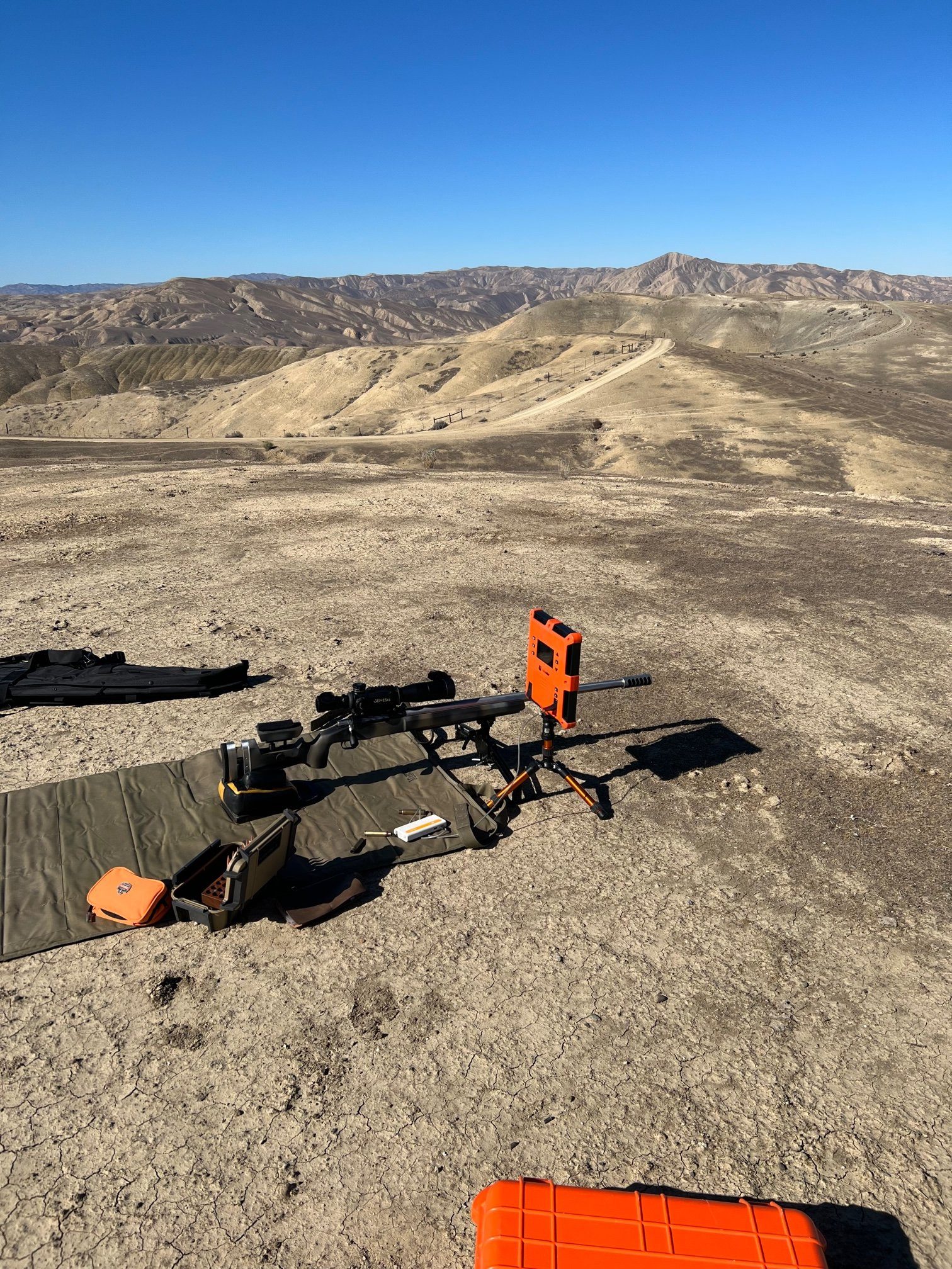

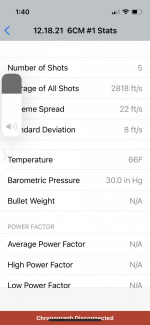

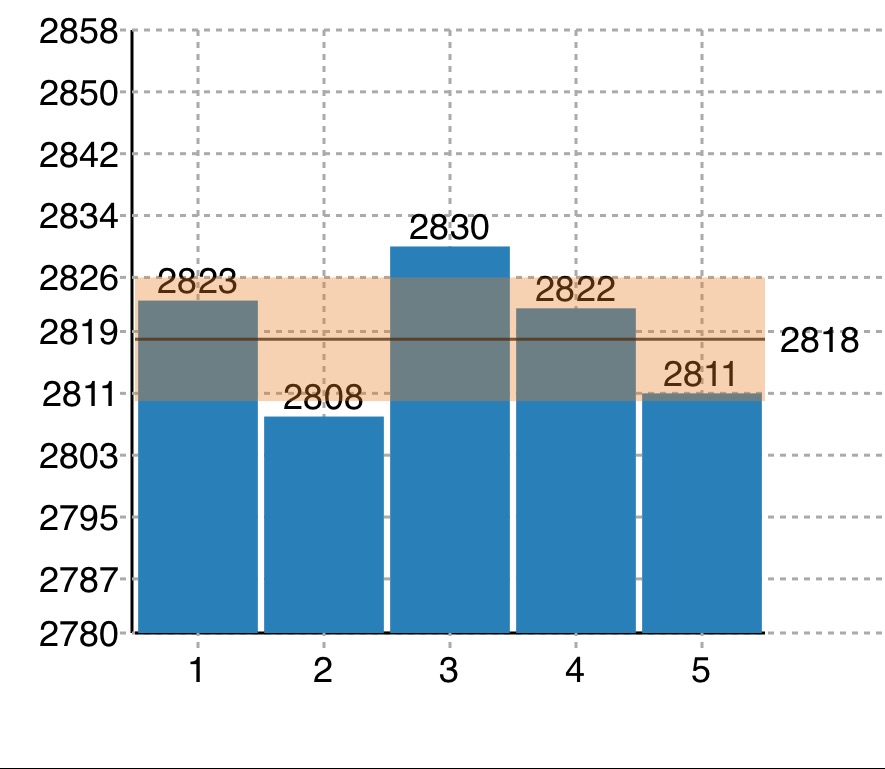

Under $200 with cheap ass Amazon tripod, examples of some of the stat sheets the App will spit out:
E239BA49-F426-4AD8-A9D6-ED8AF69A43BD.jpegF669EB30-B378-4D21-9BFC-A5418C65FB3C.pngDF9521EA-BD7B-42A1-9ED2-5E68AE61C50F.jpeg
View attachment 8014284View attachment 8014285View attachment 8014286

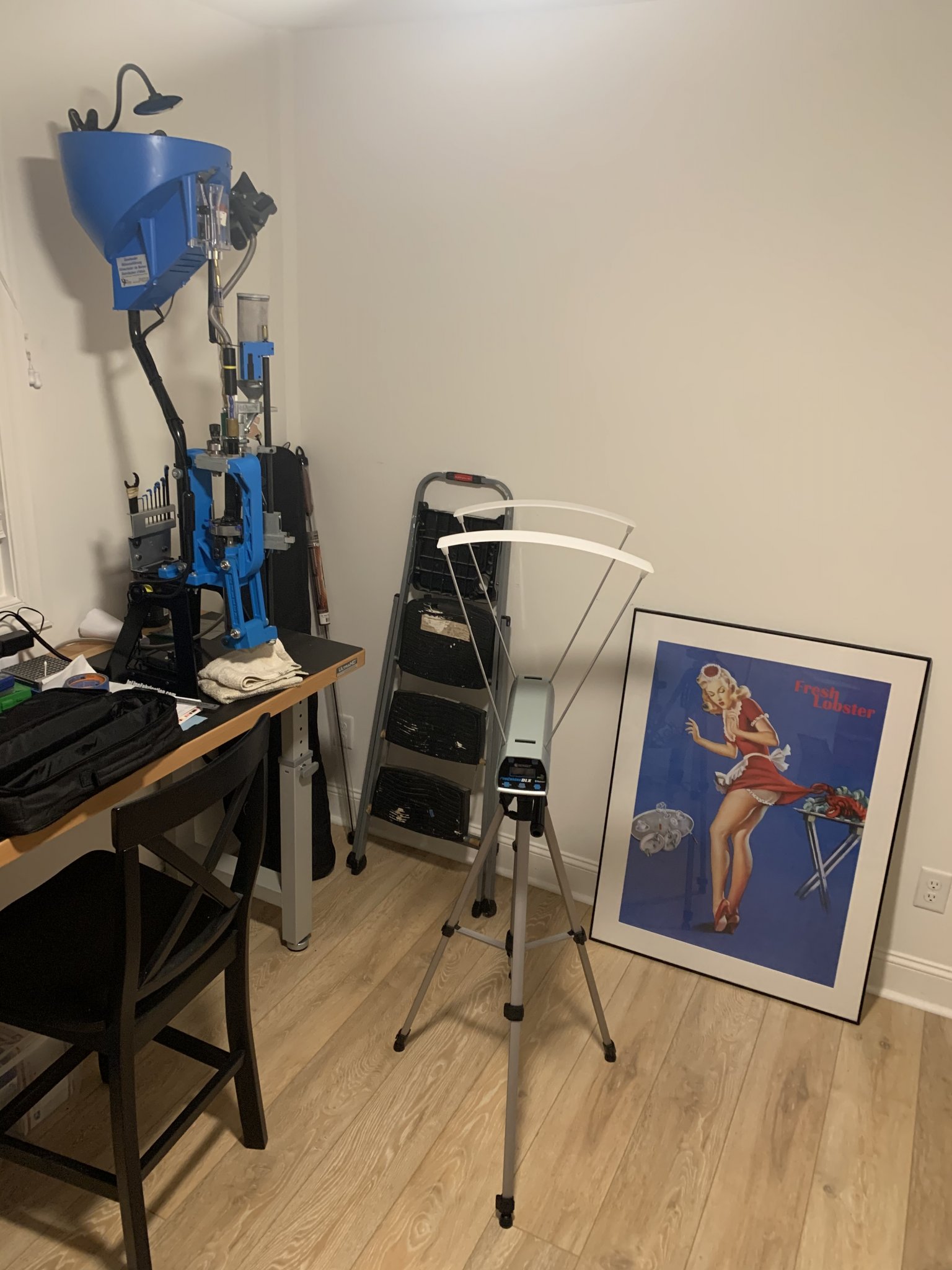

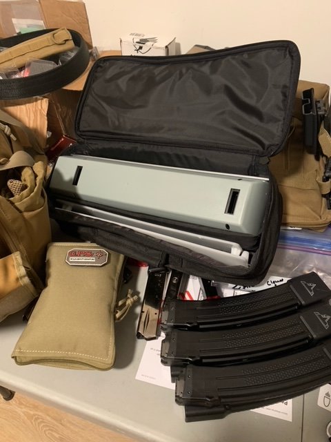

ETA: This is how small a Prochrono DLX and cheap little Amazon tripod packs (https://competitionelectronics.com/products/prochrono-carrying-case):
View attachment 8060714View attachment 8060715
