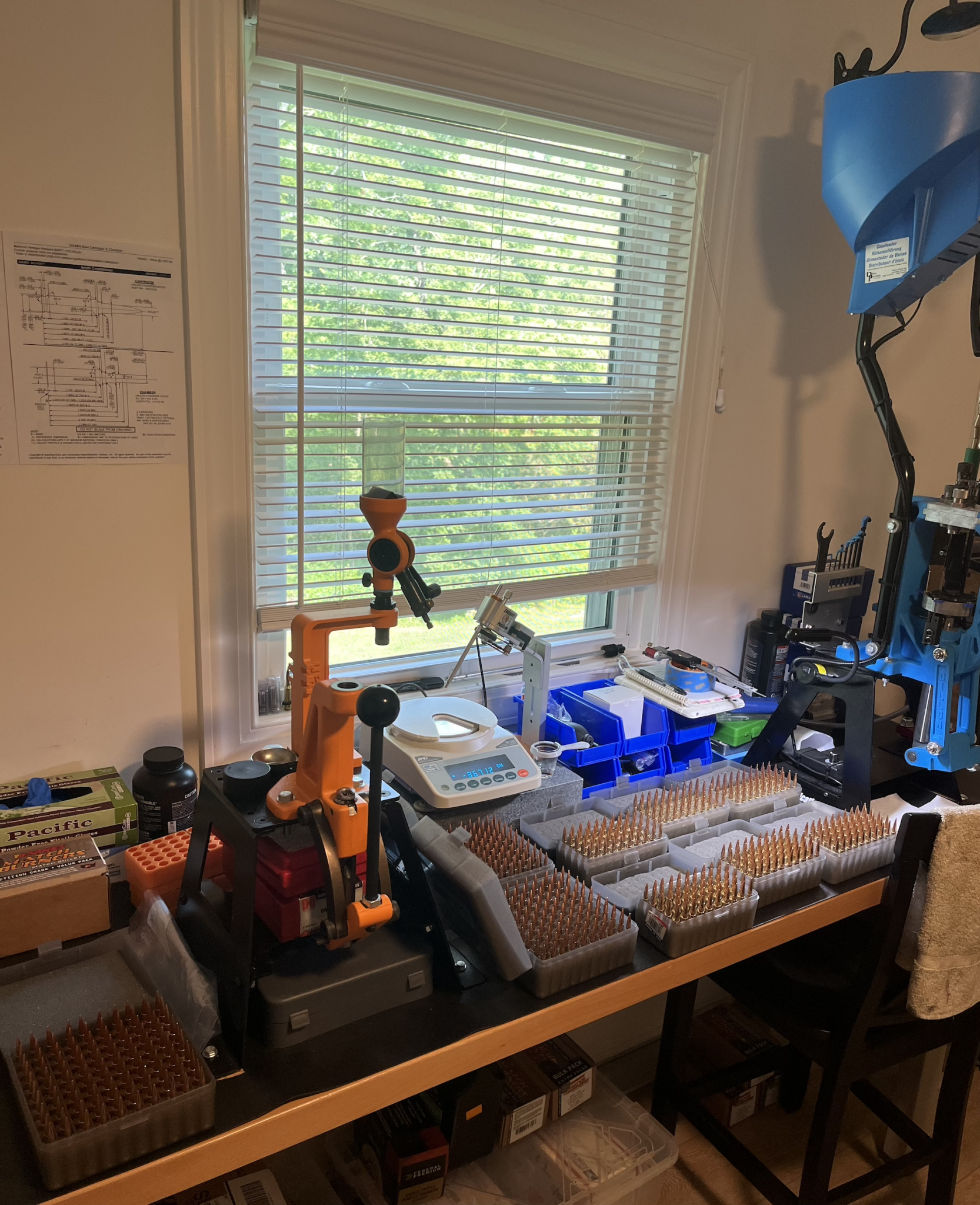

I've only ever seen people rave about the Co-Ax. You've used one and do not like it? Can you be more specific about why you don't like it? I'm sure I could 3d print or make a new handle out of wood if that's an issue.
A coax pivots in a different position than others that are hinged below. He didn’t have the bench located correctly so sure, it’s weird if you mount it wrong, but there is nothing wrong with the press.
With my table couch set up the ideal press he recommends would hit the handle on the floor but the coax is perfect.
Get what you want, just mount it correctly.
I don't have anything to say about the ammo a Co-Ax makes, that's not it. They make great ammo.
I've just used 3 different ones, each mounted a little differently (different heights, with and without Inline Fab risers), and still haven't encountered one that was mounted in such a way that was ergonomic for a human to use comfortably. The over-the-top stroke is just weird, and while no single-stage press is going to break any speed records, I just think it's best to pick one that will let one work a little faster while not wrecking their shoulder (and I'm 6'2", so if you're shorter than me, then it probably is worse).
When cranking out rounds on a progressive press (like a Dillon), getting the handle close to the same height as one's shoulder is a huge pain saver over time, and the same thing applies to a single-stage press.
Getting the press to the right height so you can work efficiently is more important than many think/know, whether one of Inline Fabrication's or the universal one that Lyman makes (I have/like both), IMHO getting a riser isn't an option, it's a must.
This is a counter-height bench (36") with the little Lyman on a Lyman riser (Dillon on an Inline Fab).
@CK1.0 Thank you for elaborating. Hopefully other people with the same questions I've had will find this thread, so it should help more people than just I.
I'm a 5'10" midget, but I can fit into racecars easier so it's an alright trade. lol Car guy first, guns come second...
One of the things that was appealing about the Co-Ax was the shell holders not being necessary, but it seems that I need shell holders for multiple uses and not just the press so I'll end up buying them anyway.
Also, do you happen to have the a link to that diagram on your wall? I'd like one for 6.5cm.

The best advice I can give when it comes to reloading tools is to consider how you'll use them and how simple and solid they are in their most basic form (be weary of gadgets). The longer I do this, the more I'm impressed with stuff that does one specific job kick-ass over stuff that tries to do a bunch of different stuff doing it half-ass.
With some things (like fancy powder droppers that drop every charge to the kernel in seconds) you're going to have to open your wallet to get the best performance... but a lot of the other stuff is caveman stuff and it comes down to what you like and what works for you. Remember, there are dudes winning golden bullets while loading their shit on $100 Lee presses.

How many rounds do you shoot in a month? Year? If you are just a casual shooter and only fire a few rounds here and there, you can load really good ammo on some really cheap equipment. If you shoot hundreds of rounds a month and are training like crazy and shooting every match you can find you will want equipment that is faster. I think a lot of people spend money on reloading faster.
There is no "issue." Some people seem to think that you're required to stand squarely in front of the press like you would with a Dillon progressive press. You're aren't.
Place the Co-Ax press on a counter-height bench and stand slightly off to one side of the press. The motion to operate the Co-Ax is so easy and smooth that you don't even have to grasp the handle with your whole hand; you can operate it with just your fingers.
