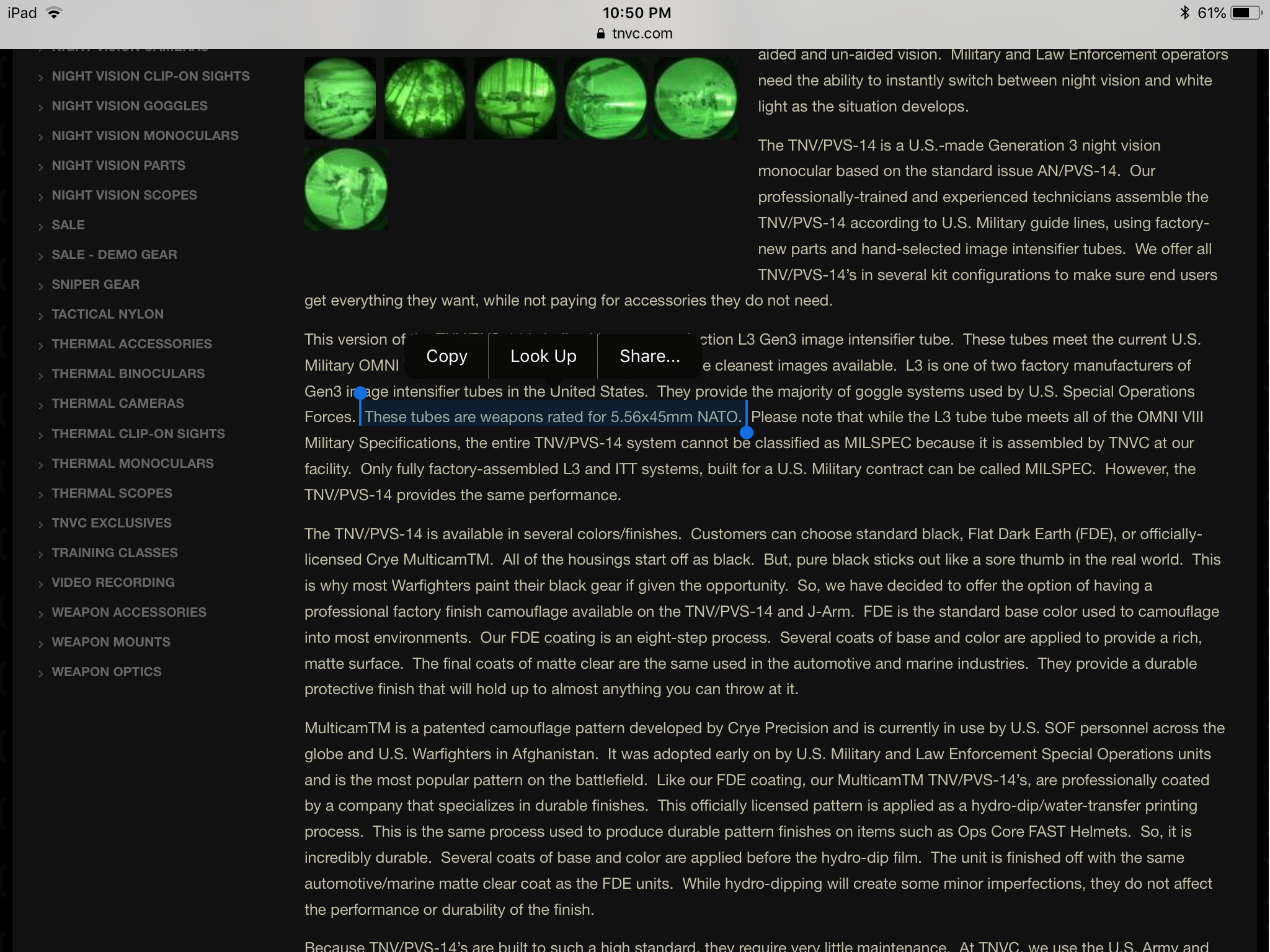

I would agree with this to a point. 5.56 recoil should not hurt a good PVS-14. I’m sure that is to a point. What that line is, I don’t know. I have no problem putting one on my 5.56 and hunting hogs or coyotes, however I would not mount one and run 4-5k rounds thru it.
Now, how to get a company to believe that a failure was due to 5.56 recoil, and not a drop or fall of some sort, I don’t know. That is nothing against Vic or anyone else, but I don’t want the warranty hassle myself.

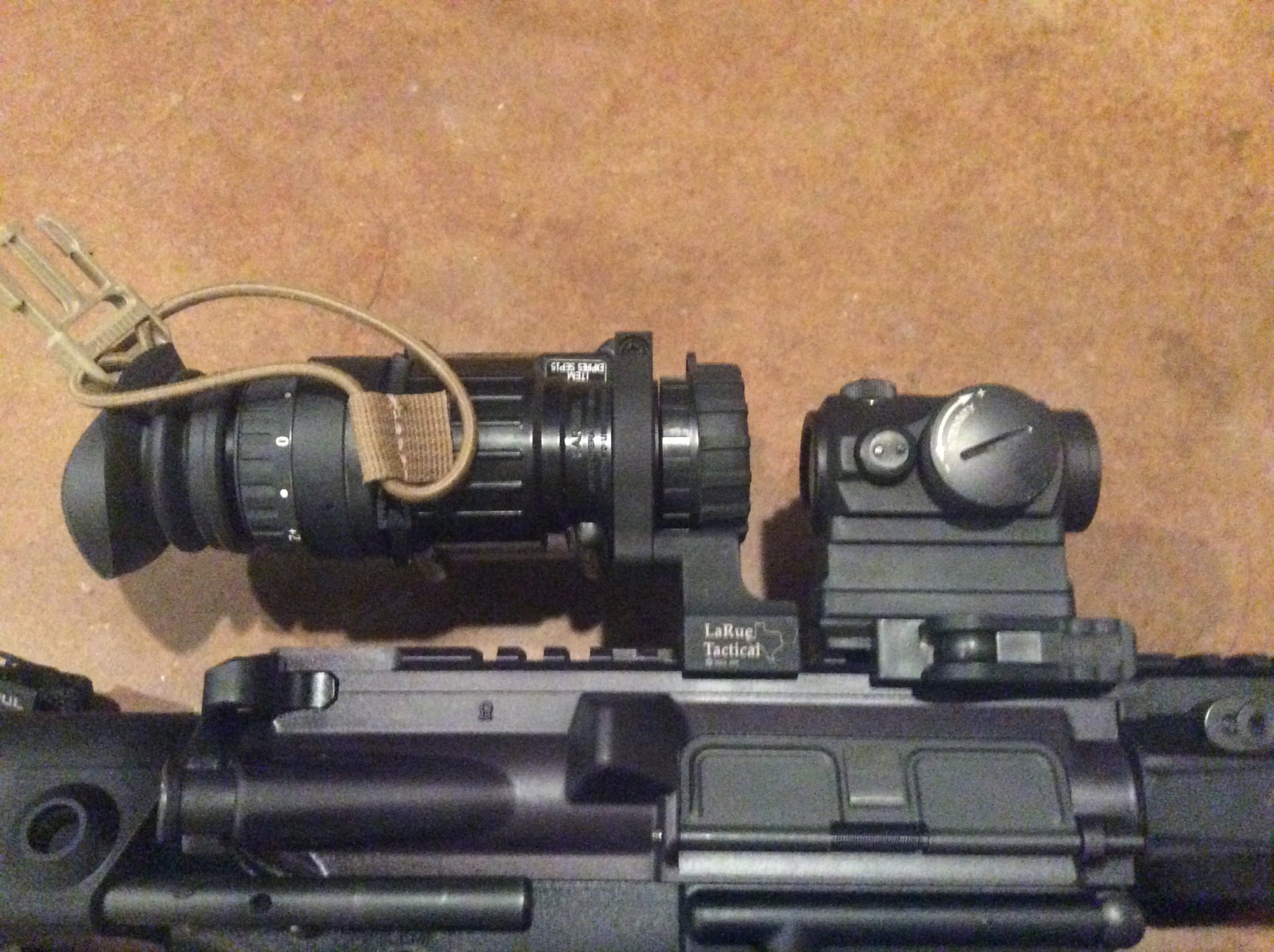

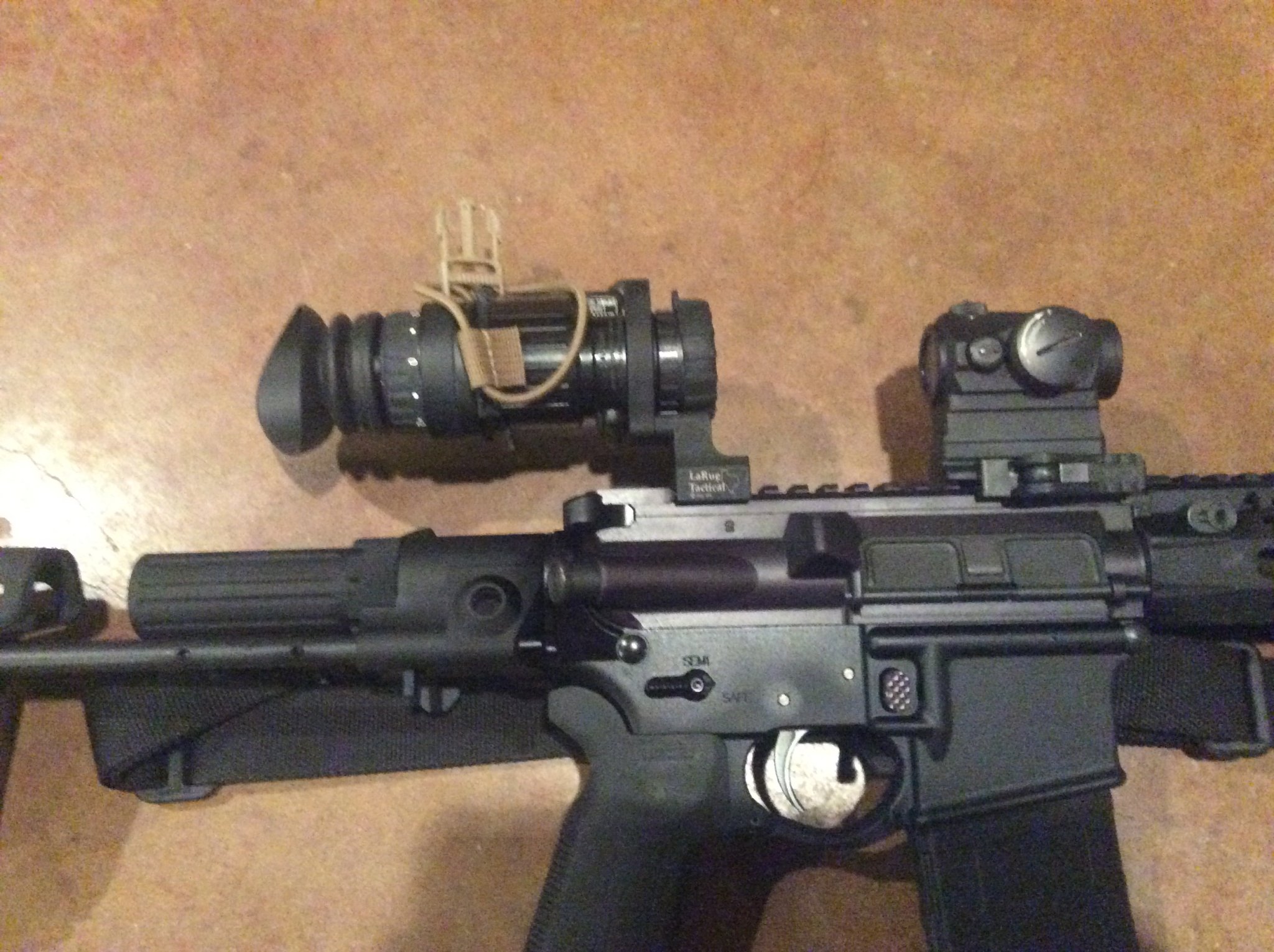

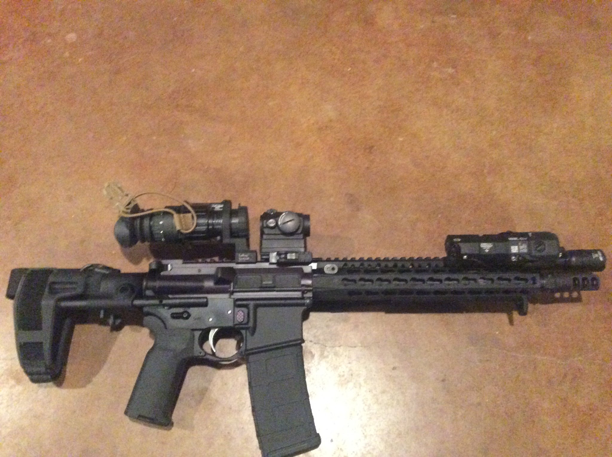

Here is how I use to run mine.
I used mine on a large mount that stays attached to my tube. There is enough room for me to run a 3x magnifier behind it if I want to.
It does work, but from what I have seen, it works better with an EOTECH than it does with my T1.

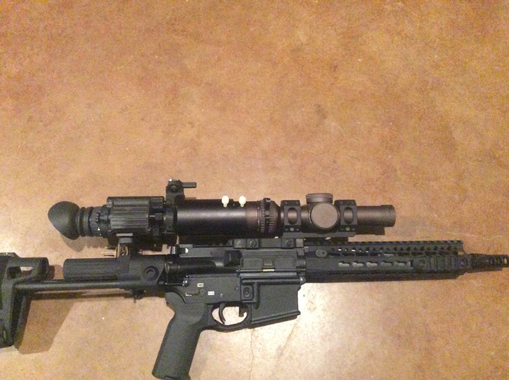

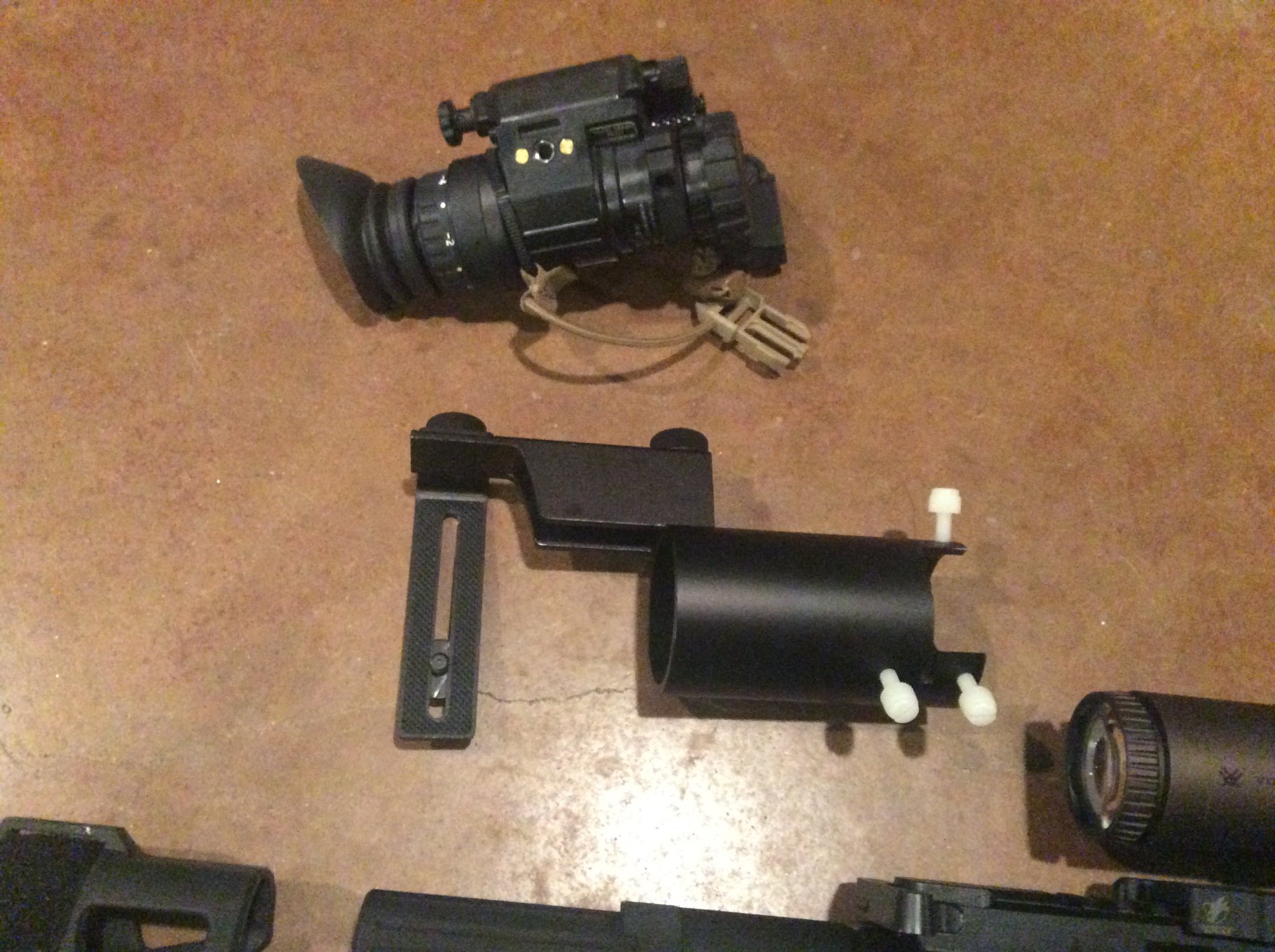

For mounting it on a magnified optic, I use a camera mount.
This mount is made so you can attach a point and shoot camera to the optic and take pictures thru the scope. It does however have enough adjustability to allow you to mount a PVS 14 on it.
I would not run anything more than a 1-6 with this setup as it drastically reduces its use. The 14 in this scenario can only amplify that amount of light which passes thru the lenses on the scope.

i run one of my 14's behind an eotech and I have the 3x magnifier. My 14 is the RC model which is higher recoil rated. Keep in mind that the 14 was NEVER designed to be weapons mounted. It was to be helmet mounted and used with lasers. And it is very accurate used in theat fashion.
