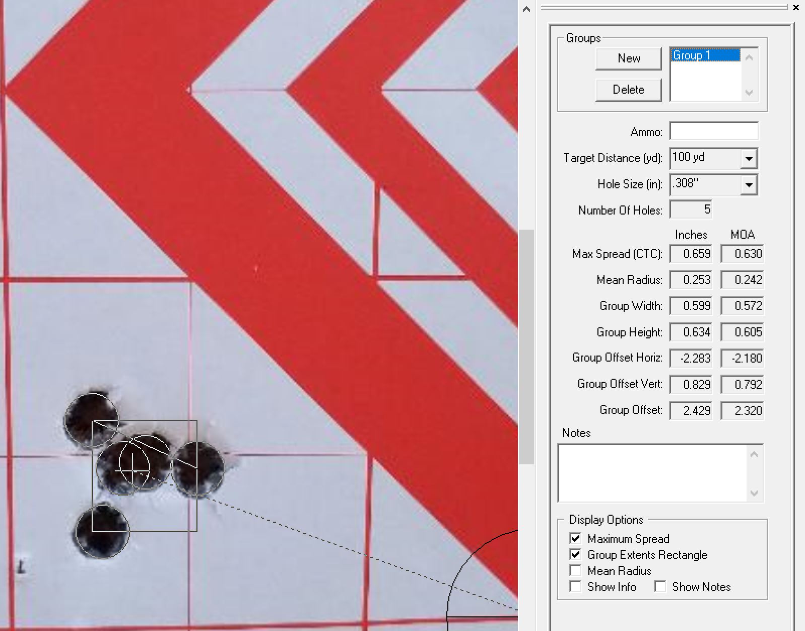

Finally got a chance to get back to the range with the MDR yesterday; part of the delay was sending in my bolt to DT to be fitted with the large extractor, but the long pole in the tent was breaking my leg which has in turn made the 200 yard round trip to hang targets a PITA. In any event, the leg has healed enough to allow for such a trek with minimal drama.
As for the MDR, the only modification or even maintenance it has seen to date was around the installation of the large extractor. When I received the bolt back from DT with the new part installed, I lubed up the friction points on the bolt, lugs, cam pin, and carrier with lithium grease (as DT had done from the factory) upon reassembly. I have not cleaned the barrel, barrel extension, op rod, or gas valve, nor have I adjusted the gas valve from it's as-received position when new. The round count is at exactly 100 rounds, and out of the 47 rounds that I shot yesterday, I had not a single malfunction. Everything worked just as you'd hope.
The condition of the brass after extraction shows some definite marks (still seeing some slight extractor marks on the forward face of the case rim despite the larger footprint of the new extractor), mostly scratches along the length of the case body (I presume from the mechanism that holds the spent case after extraction, before the bolt pushes it forward along the ejection chute). Additionally, there are a few mildly dented case mouths, but I cannot rule out that occurring after the case is ejected.
Anyhow, most of the groups I shot yesterday were in the 1.5-2 MOA range, but I started playing around with other shooting techniques (I was at a bench, shooting off of sand bags), and found that if I used my off hand to tightly pull the bags back towards my body while using my shoulder to push the rifle into the bags, the rifle started putting up some somewhat respectable groups (for what it is). These were my last two groups of the day with this gun, and were fired when it was plenty warm; the second to last group was just under 1 MOA for five shots, and the last group was .630 MOA per OnTarget:
7107511
Still not the best grouping in the world, but given the limitations of the trigger (not to mention the shooter), it's not too shabby. While this group certainly isn't representative of the average group I shot yesterday, it was also fired using a different technique than I had used for the bulk of my groups; continued experimentation will be required in order to see if this kind of group is within the norm, or a planets-in-alignment type of thing.
