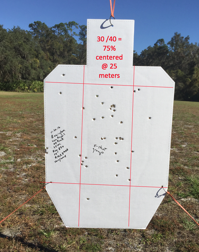

I have used Ghost Ring sights on an old Remington shotgun and like them VERY MUCH! These are a definite 'desirement' for me. A RDS or Reflex is probably a good idea too but, on a tractor or rifle rack in a UTV or pickup would likely be covered in dust. If it was propped up beside my nightstand in my bedroom, an electronic sight would be an obvious thing to add.
If I can't hit a paper plate size target at ~50 yards with iron sights I need more practice!
Yes, if you're shooting slugs at 50 yards ghost ring rear and post up front will be more accurate. A dot will be even faster. And I'm pretty sure you can get a 1301 in this configuration. Plus, as someone else has mentioned I believe the new 1301's come with an extended mag tube. Shouldn't underestimate the value of this feature. One of the problems with semi-auto shotgun vs. something like an AR is limited ammo capacity. And fast reloads can be challenging without a fair amount of practice. Given your scenario of multiple dogs coming at you having even 2-3 extra rounds in the tube is a good thing.

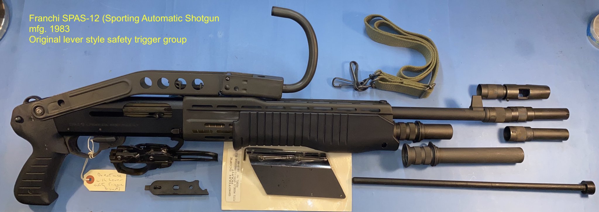

Someone mentioned the semi-auto -pump Franchi SPAS 12. The most clumsey shotgun I have ever handled. An accessory shown is the 2-piece muzzle shot diverter device widening the lateral shot pattern 4:1, allowing getting several pigs / dogs in the same sight picture.
The SPAS 12 with the lever style safety was recalled as it could fire when the lever was toggling the safety to the Off position. Only shoot it with the cross bolt style trigger group.
