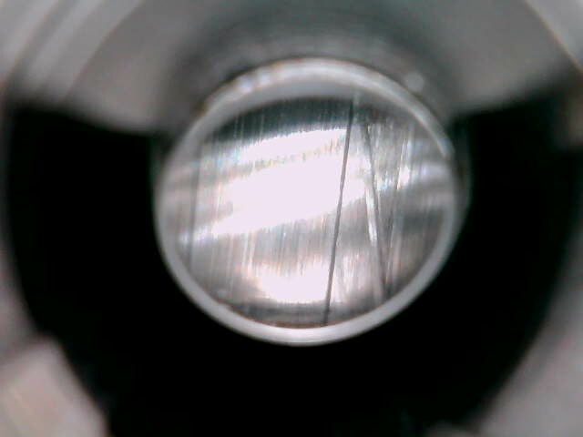

PSA FOR PROOF PREFIT BARRELS!!

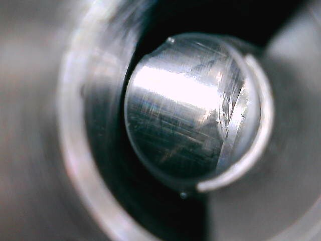

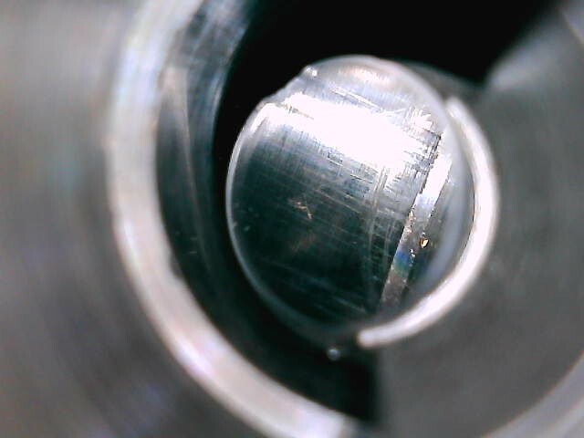

I recommend to everyone after this fiasco to look other places for barrels. I have 2 barrels from them previously that shoot really good. But this 3rd barrel is only capable of 1.5 MOA and Proof has left us with a $900 piece of junk. After testing all shelf ammo we could find for this barrel and it not being better than a 1.5 we sent it in to proof. We received a call a few weeks later stating that it shot .5” with the exact ammo we told them it would not shoot and would not provide pictures. Being that this chambering has been discontinued by them I figured they were giving us the run around so they do not have stop their process to bring out old reamers.
We then took this barrel to a custom ammo manufacturer in our state to see if he could go to bat for us. Immediately he had his doubts as he has had many problems with them in the last few years. He then measured out the chamber and found that there was over .300” of jump. (photos below). He sent this info to proof and requested a replacement and they stated that those chamber specs are not right and they would warranty it.
We heard from proof 2 days ago now and they sent us pictures of a mold they took of the chamber and measured it out stating their was only .06” jump and met SAAMI spec and would not be replacing the barrel. They could not provide us with which bullets they were using to spec the chamber and did not provide much information at all.
So now we are stuck with a $900 barrel that shoots like shit.
After talking with this custom ammo manufacturer, he stated this has been very typical of proof the last 3 years and has had to send in over 50 barrels to the warranty department due to not shooting and chamber dimensions and currently has 4 of them he is trying to make a load for because they won’t shoot good. The size of groups for each one were provided, 1.8, 2.2, 2.5, and 3 MOA.
I will no longer be buying proof barrels and hope to steer people away from their prefits so they don’t waste that kind of money on them either.

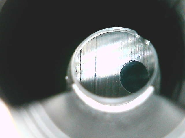

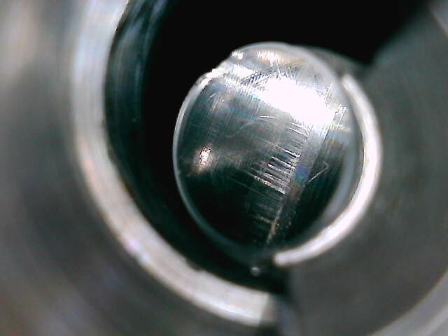

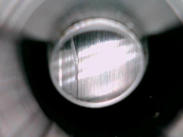

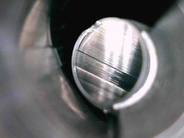

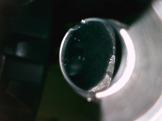

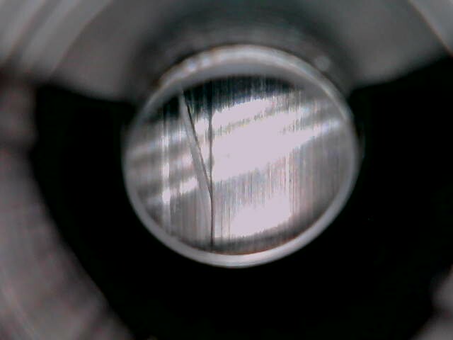

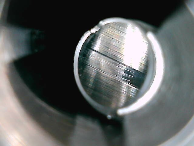

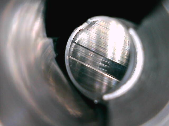

Two barrels that I had purchased through ExpertVoice looked like they were chambered with a broken reamer and because I purchased through EV I had to deal with PR directly, not a pleasant experience!
Also when dealing with PR Customer Service keep all communication strictly to email so that you have a black and white paper trail, what they tell you on the phone and what they tell you via Email are two different things.

So they sent you photos of a complete cast of the freebore with measurements that fall into spec? Problem with these post is that it is always one side of a story. OP you are acting like they did nothing. It sounds to me like they provided photos and some details.

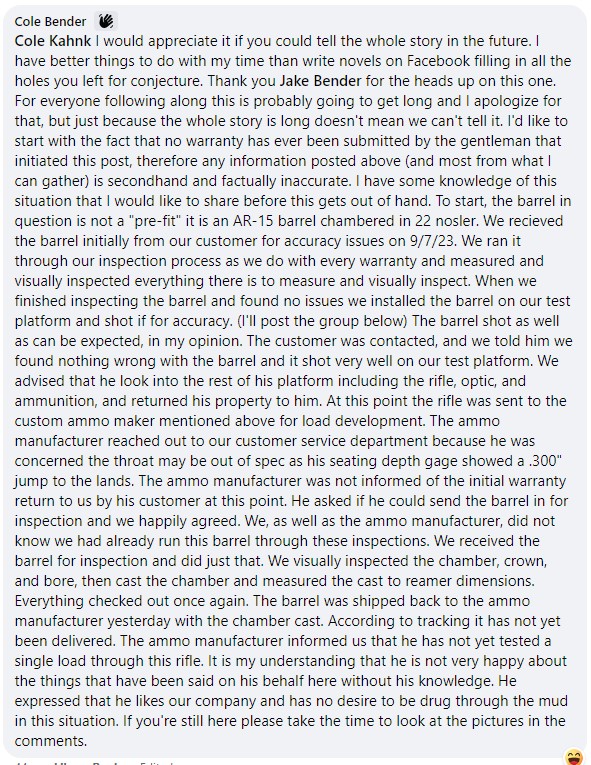

Man oh man…. Apparently we belong to a couple of the same Facebook groups OP. Looks like you have made your rounds of trash talking. I am just going to leave this here as a response I saw on one of your post. Having trouble with screen shot uploading into my comment but I will attach the file.
Two sides to every story.
But doesn't it seem beyond coincidence that the customer thought the barrel had an issue, and when it was sent to the ammo guy, he also thought there was an issue, without having knowledge of the first claim? Unless the ammo maker doesn't know how to measure distance to the lands? I still don't think we've heard the whole story on this either way, unless I'm missing something.
Damn. So I guess I was right, dude doesn't have a fucking clue what he's doing, and the custom ammo manufacturer doesn't know how to read seating depth and Proof did the chamber cast they should have done.

The ammo manufacture and Proof need to clarify. How does one measure a .300 FB and the other says its .060 or whatever their spec is. So either Proof or the Ammo manufacture, or both are incompetent.
The damn thread poster is the one incompetent. proof did there part of accuracy testing and doing a cast. Barrel was sent to proof first for accuracy and sent back with test targets to OP. OP sent it to a bullet manufacturer and bullet manufacturer received a chamber cast from proof.
And they sent a cast of the chamber to the manufacturer with results of their findings. I am just getting the vibe that OP is out to start drama. Pretty suspect that the bullet manufacturer didn’t even have knowledge of the accuracy warranty.
