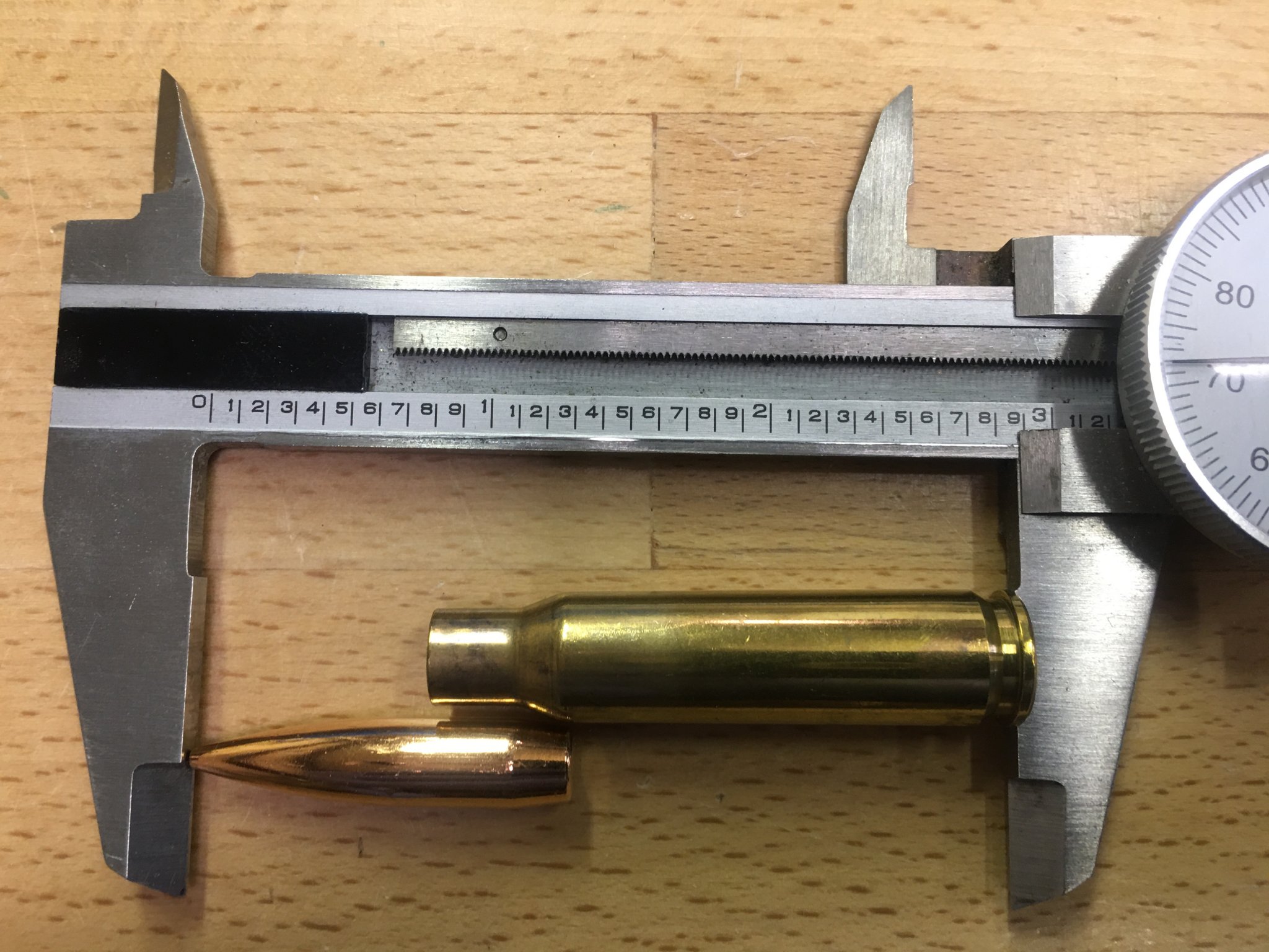

Because…? Will the bullet be too long in avoiding compressing the powder or…what am I missing here?
You will be longer than 2.800” OAL, will not fit in 700 BDL magazine. You’ll be longer than 2.870” OAL, won’t fit in an AICS magazine w/binder plate.
Even at 2.900” OAL, you’ll still be jumping the 185 Juggernaut over 0.060” in factory Rem 700 chamber; Juggernaut takes jump just fine.
Longer OAL, plenty of jump will also lower your pressure vs 2.800” OAL and chamber with less freebore.

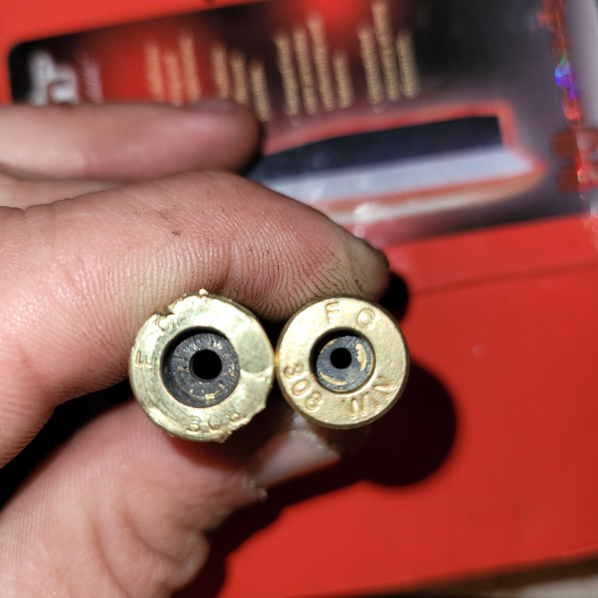

My understanding with the jugs and other heavier class bullets. It's not the speed that gets you there, it's the bullet to bullet consistency and high bc. While you would do well to try for the highest safe velocity in your gun. You also have to worry about temps swings. Which can drastically increase pressure depending on your powder choice.
All the advice above is good advice. Double check you info and components, then start low and work your way up.
Or be in a hurry to find a wonder load and fuck it all up. View attachment 7884661

The photo is what came to mind when I saw the thread title. 2000mr i think is the current king of FPS with heavies in the 308. I shoot 175s at 2612 {Varget} and 2735 {RL15}. My factory remington 308 barrel couldnt touch the lands and keep a 208 a max in the case even.
I am always kind of surprised we don't see more 168s pushed faster rather than going heavier.
Reactions: camocorvette
Yeah that was too much CFE223 in a soft FC case. Like probably 1.5-2 grains over max for that case.

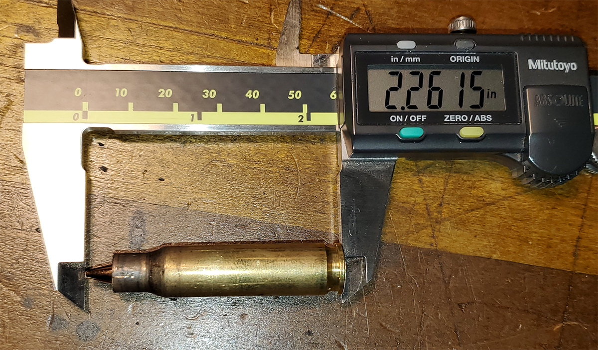

Ive had no problems my load is
43.0gr varget
185gr juggernaut
Lapua brass
CcI 450 primers
2.260 oal
Getting 2658fps
I was even told i could go up to 44.2gr and not have any problems because i should be getting 2750fps from that load
Whoever told you that is incorrect.
...or maybe they were thinking in terms of an FTR specific chamber, where that bullet would be seated *way* further out, & you can (generally) get away with putting a lot more powder behind it. And a lot more barrel to burn that powder in.
...me thinks your OAL is off a fuzz 😉
And that’s a problem with handing out reloading advice. 308 chambers vary and what works for one may not work for another especially when running hot loads. I got major pressure signs with 42grs of Varget under the Jug in a Lapua case at 2.920” coal in my TRG22. So when I see 44+ grains being discussed I cringe.
