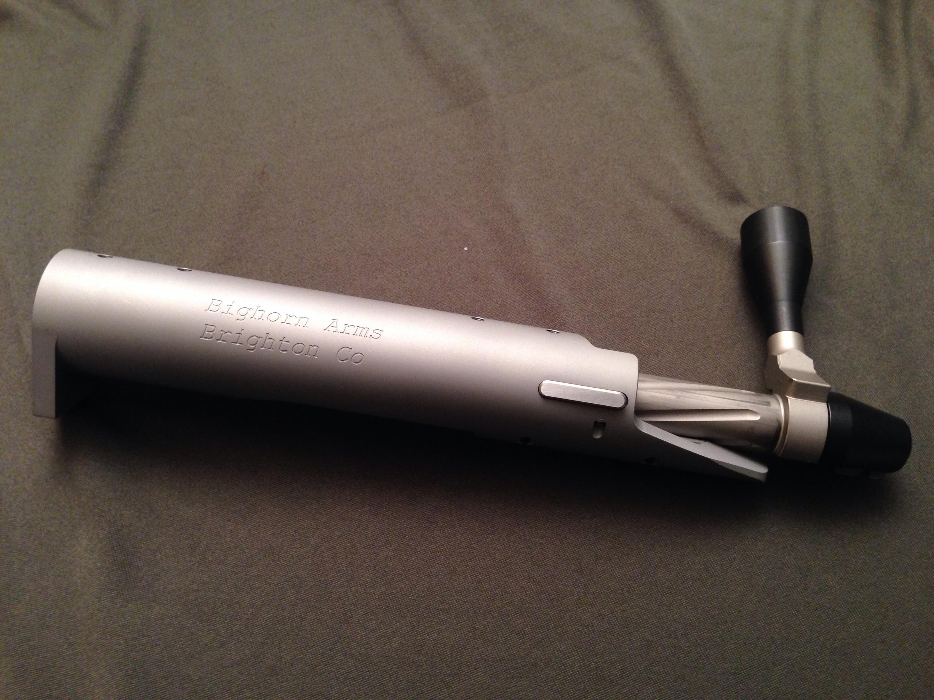

Finally able to pick up my Bighorn Arms TL2 SA that was threaded for savage small shank barrel. I plan to set this in a XLR Carbon chassis. Only thing I have not decided on yet is what pre-fit barrel to use. Looking for suggestions on prefit barrels. I plan to start out with a 6.5 Creedmoor chambering and experiment with a second barrel in a different chambering to see if this may be a less expensive alternative to going with a rifle from Desert Tactical or AI. I have one pic of the action and will add more as I collect the parts for this build.
