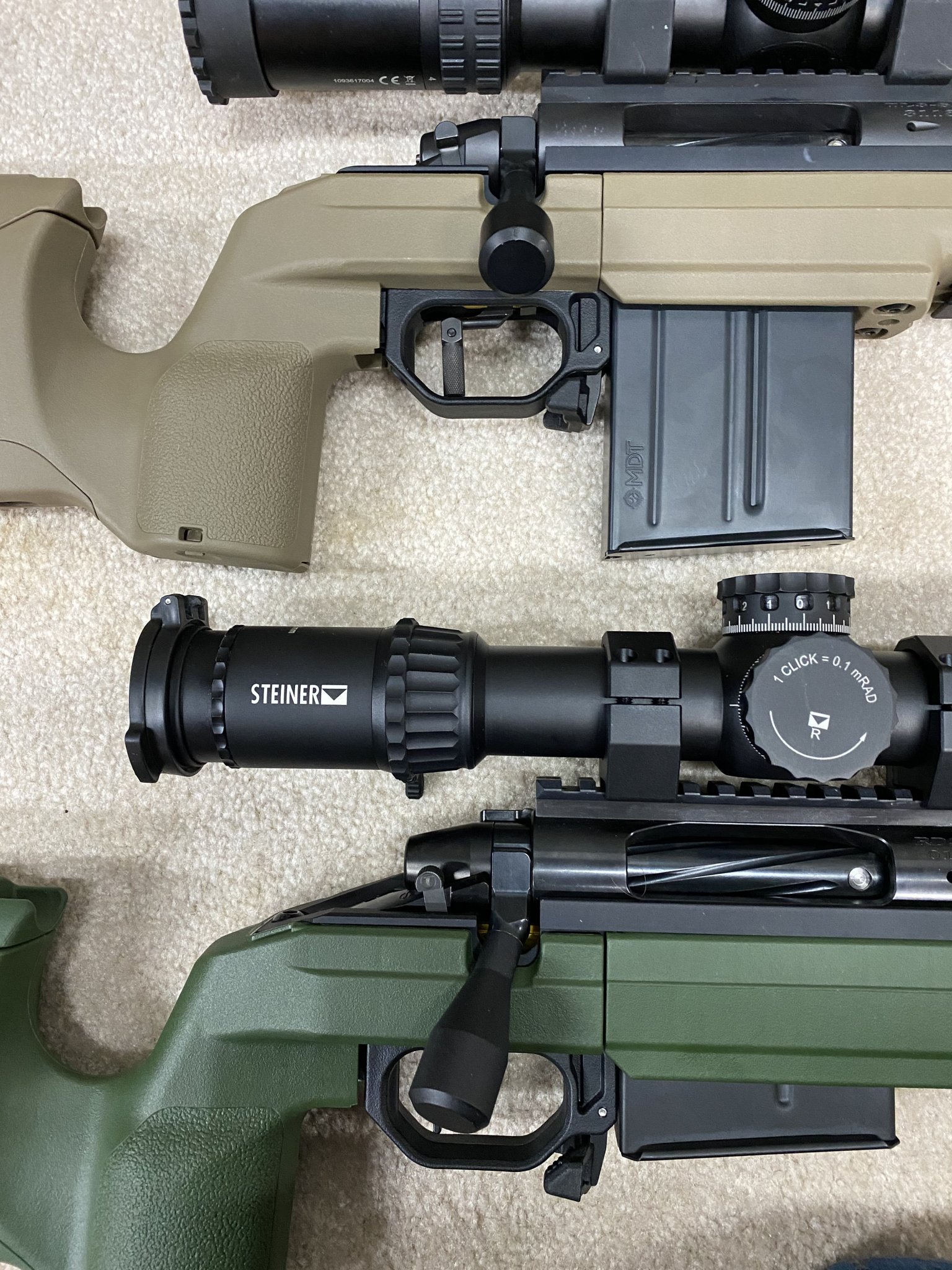

I just got my second Bighorn / KRG Bravo rifle built - The first has a 6.5 CM Steel and 300 WSM Proof Carbon barrel with a TL3.
The second is a Origin / KRG Bravo with a 6.5 PRC Proof CF barrel - Both are extremely accurate and have Tactical Bolt Handles and Timney Calvin Elite Triggers.
Much to my surprise the Origin Bolt sweeps back 45 degrees and raps my trigger finger knuckle (it is a light rifle with the proof carbon) and the 6.5 PRC makes it jump a bit when I fire - It is like a catholic nun rapping your hand with a ruler in school.
The fine folks at Bighorn will help me fix the problem as well as my gunsmith so I am not worried it will not get resolved - we are first going to swap out the tactical bold handle for a teardrop that has a smaller circumference and see it that fixes it. If not perhaps one of the smaller bolt handles like a spiral - but I want to avoid the small handle as I think it would make the follow up shot slower.
I did quite a bit or research on the Origin and never identified the substantial difference on the bolt angle from the TL3 or I would have just got a second one of those. I consider it a design flaw although they got a ton or requests asking for it.
Has anyone experienced this, why would someone want a sweeped back handle instead of straight like the TL3 and am I alone in the way I have my trigger finger placed where this would happen - just curious and would appreciate commentary

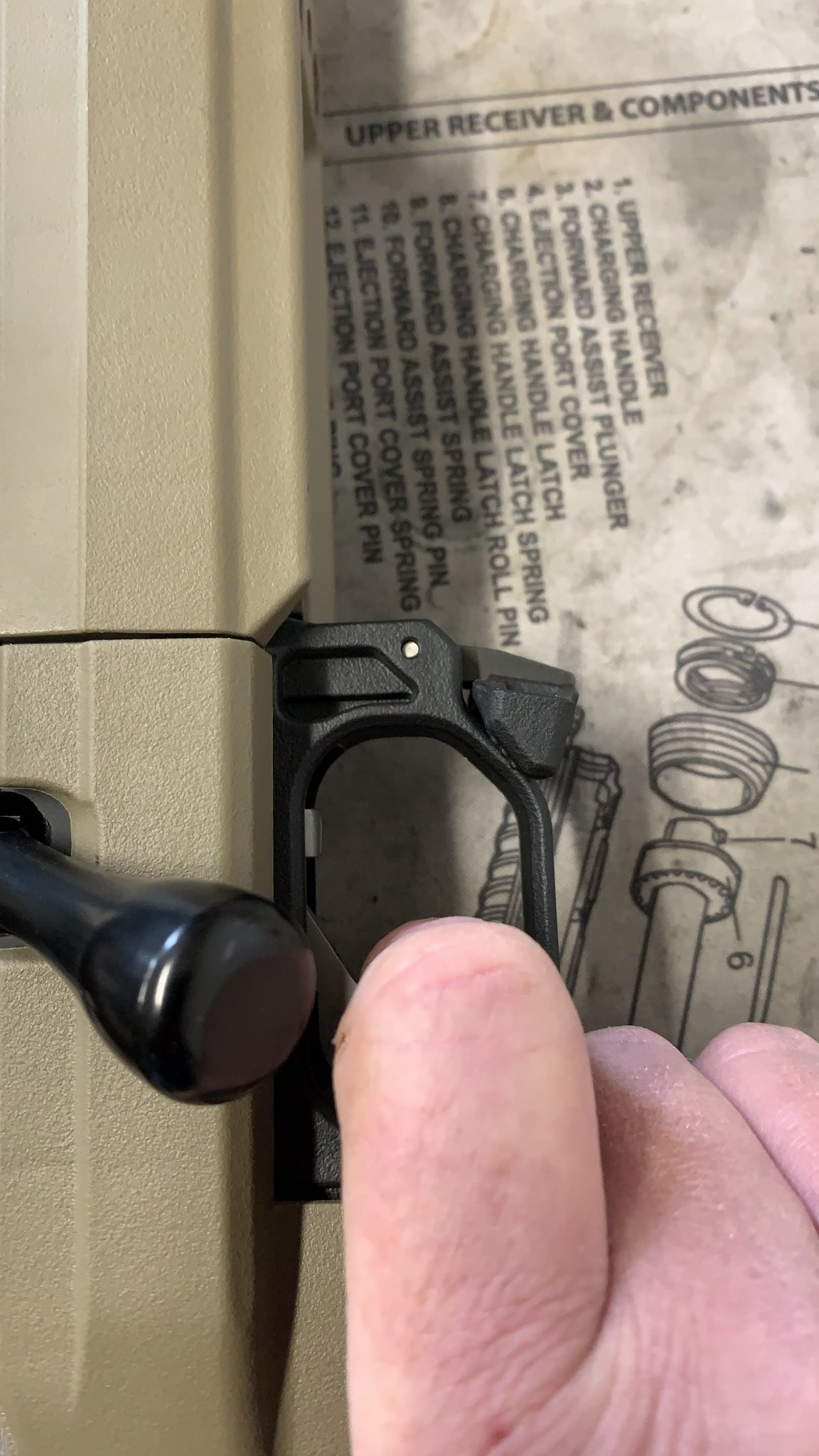

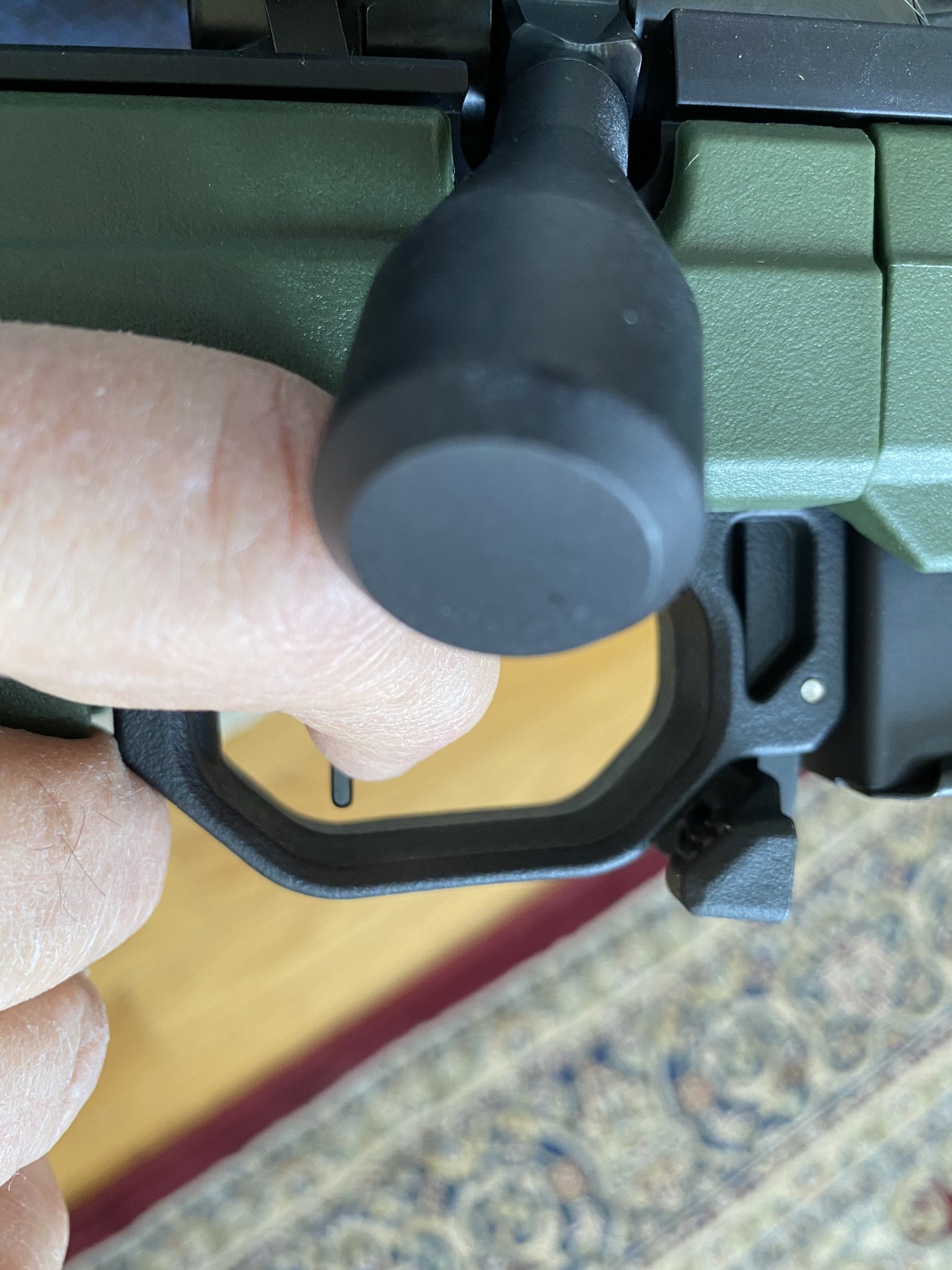

Thanks for the responses - The Bighorn pictures - clearly show the difference, so my miss, although I did not for-see this issue, and have never had a Remington 700 to see what mimicking their bolt angle meant.
Here is what threw me off from the FAQ's on their website

I posted this because I enjoy sharing and learning on this forum, and was curious as to whether I am the only person that has an Origin with a KRG Bravo and has this issue - meaning I am holding the rifle wrong. There is also a possibility that the KRG Bravo is just not the best match for the Origin. My TL3, Sako 85, Browning A Bolt and Winchester 70 bolt handles do not come any where near the trigger and while no I am no expert I am easily capable of shooting MOA when my rifles/ammo are up to the task. (My AR's are a different story :))
I will get into the shop this week where they have a tear drop handle waiting for me and it will hopefully fix this issue - I like for my rifle set-ups to be consistent, but at this point - 9 months for a new barrel, new action, new stock and then no PRC ammo to shoot anyway and I will learn to live with it. The other option would be to sell the KRG and try a different light weight stock. Although I really like the chassis and avoiding the expense of bedding - the KRG's with the Bighorn and Proofs are my most accurate rifles.
I guess I know what I like, learned the hard way.
To reiterate - the folks at Bighorn and my gunsmith are totally supporting me - so no issues.

Based on the second picture with your hand, IMO your grip is high with your thumb in the tang area which is common with hunter style stocks with high grips angles. The bravo and other chassis/stock with 90ish grip angle are design to wrap your thumb or float them which will bring your hand down thus make your trigger finger parallel to the rifle and clearing the bolt. I can post a pic later if you wish.
Reactions: Schütze
Thanks - that explains a lot - my first 20 years with rifles were with wood stock hunting rifles - also with my pistols I use the tip of my finger. A picture would be very nice of you.
Like drwood96 said, you're grabbing a handful of grip. Theres a vid Lowlight did with Jacob of Rifles Only years ago. Jacob is establishing his grip on a rifle, and dropping fired cases down between the rifle grip and his palm, and the cases pass through and fall to the ground. In yoir second pic with your finger, you have so much of the grip in your hand, you're reaching for the trigger. Build the grip from the trigger back, what remains of your hand on the grip is just a product of that.
