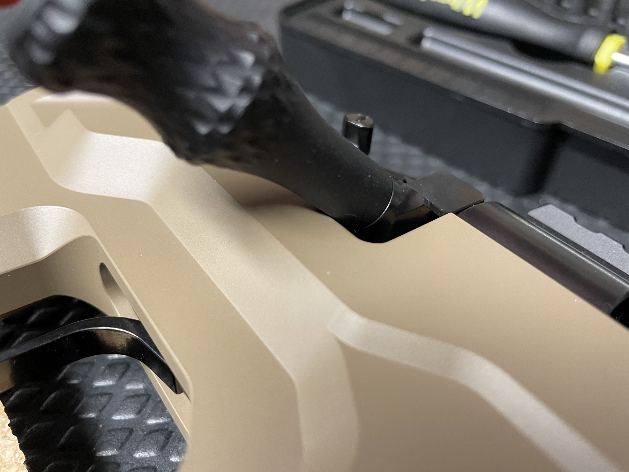

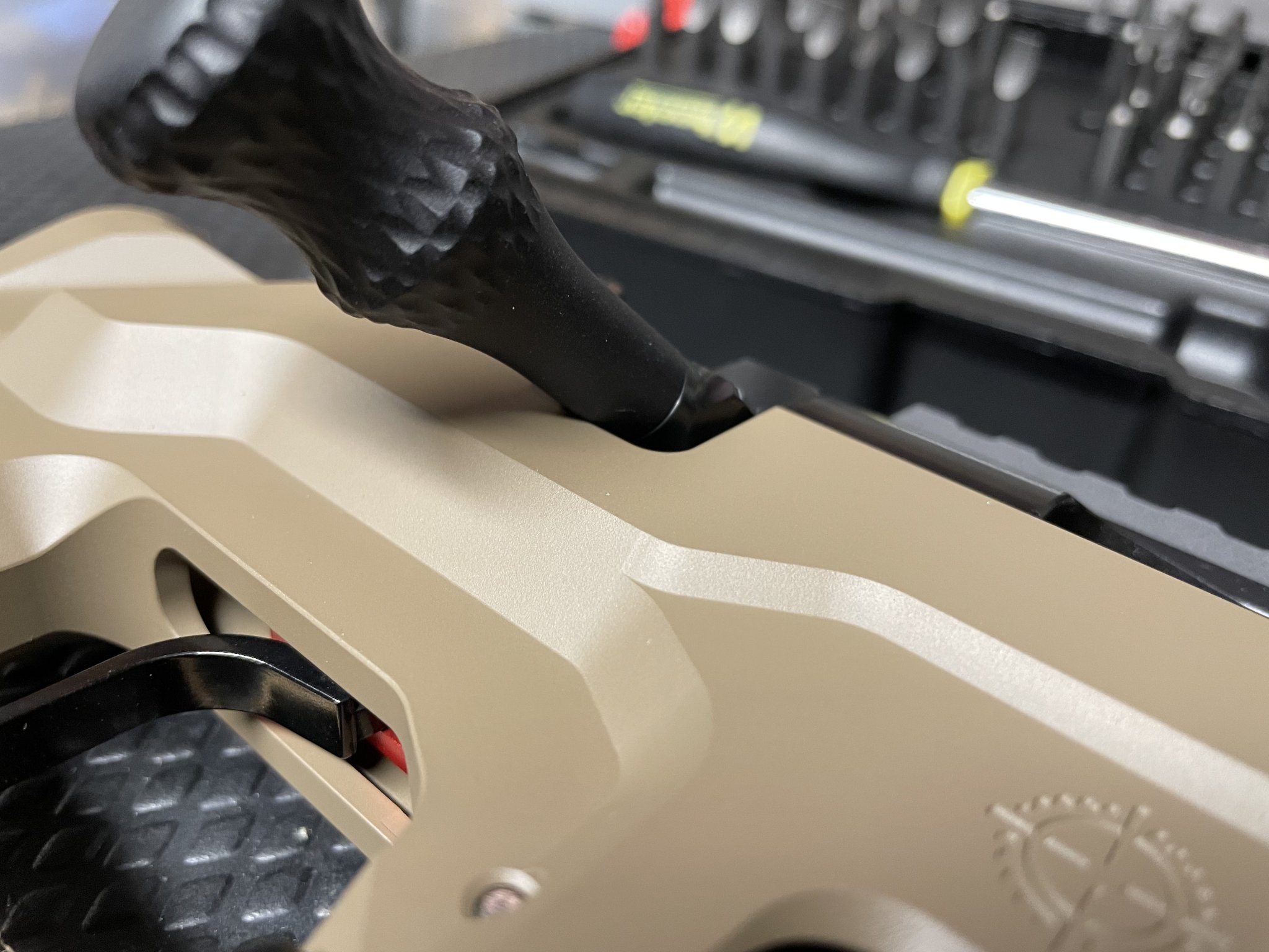

I’m putting together my first “build”….. really just a parts assembly . But I’m running into a problem.
I have a Bighorn origin SA barreled action with Triggertech diamond trigger and I’m trying to install it into an MDT LSS XL gen 2 chassis.
The bolt handle shank is hitting the chassis and won’t allow full lockup of the bolt, as per the attached pic. A bit disheartening as this is the chassis I was hoping to run for a lightweight option.
I can obviously hog out the chassis’s handle slot but I hate to do that on a new cerakoted piece.
Has anyone run into this? Am I missing something during install that would remedy this? TIA

It is definitely a Rem 700 chassis, the action body itself fits perfectly, but the Origin bolt shank is round and is thicker than a standard Remington.
I am using the action screws that came with the chassis, they all appear fine.
I’ll look into the washer idea, but I’m not sure how that would work as the washer would need to sit between the round and v-block chassis. Thanks
