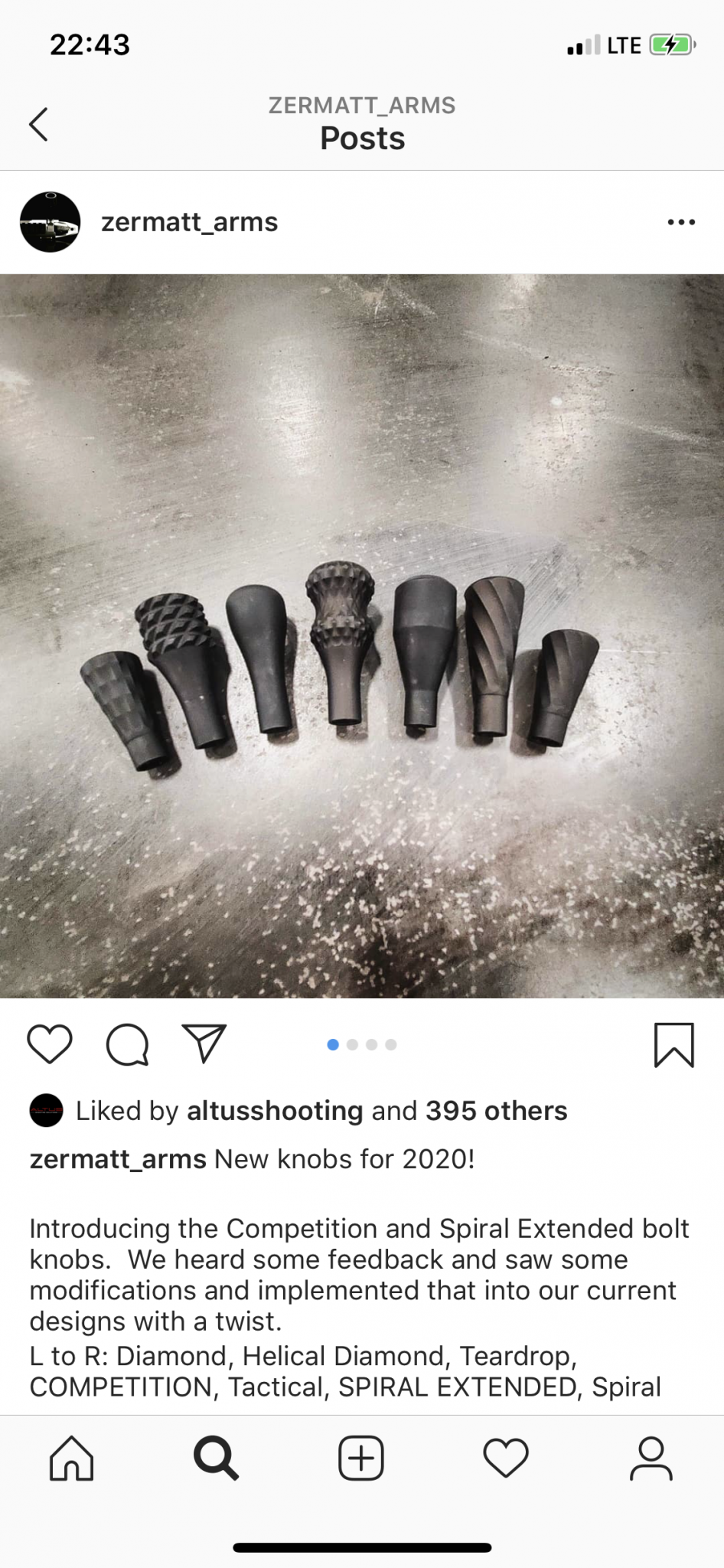

They just put out a few new options on ig if that helps. The competition (in the center of photo) looks awesome to me, too bad mines permanently attached.....
On their web site under the bolt knob additional info they still list the 5/16-24 as an option but if you look at the actual drop down menu all options including the new Competition, and Spiral Extended versions are only available in 1/4-28 thread. If you're unsure which you've got, I read a helpful answer they provided on their facebook page: "... If you remove your bolt knob and the threads have an Allen key at the end, it's 1/4". If not, it's 5/16". "
