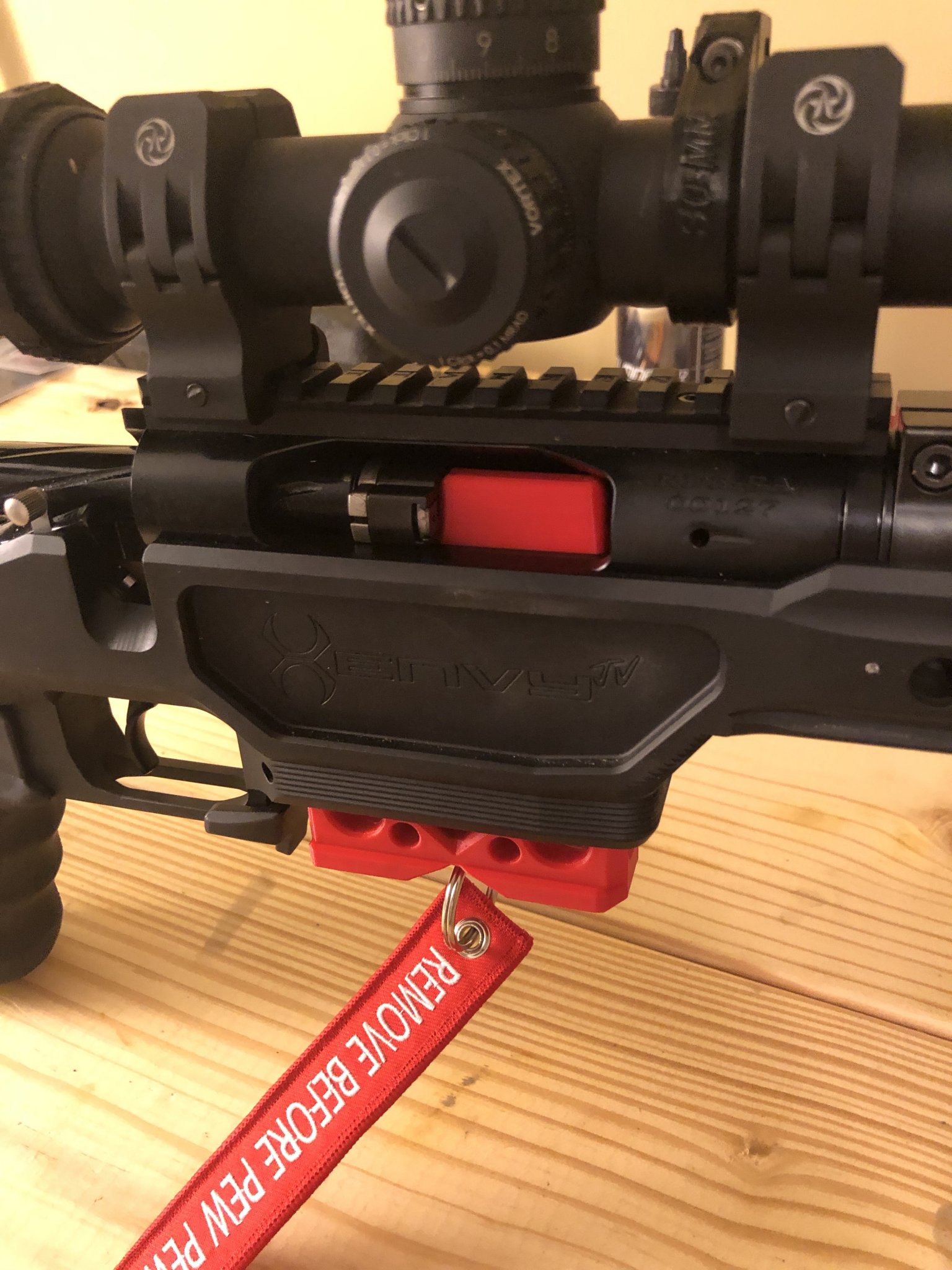

I currently have the barrel nut Barloc as I got it before Origin prefits hit the market (Photos below). You'll need to order the action with the shorter rail or contact BigHorn to exchange it. It works but I would not call it a quick changing and the return to zero is about 1.0 mil. The shoulder version is a little faster but there’s a slight change in zero (0.1 - 0.2 mils).
After I shoot out this barrel, I’ll dropping the Barloc and go shouldered prefit exclusively. With action wrench and viper barrel vise, a barrel change takes 5 minutes and better RTZ.
