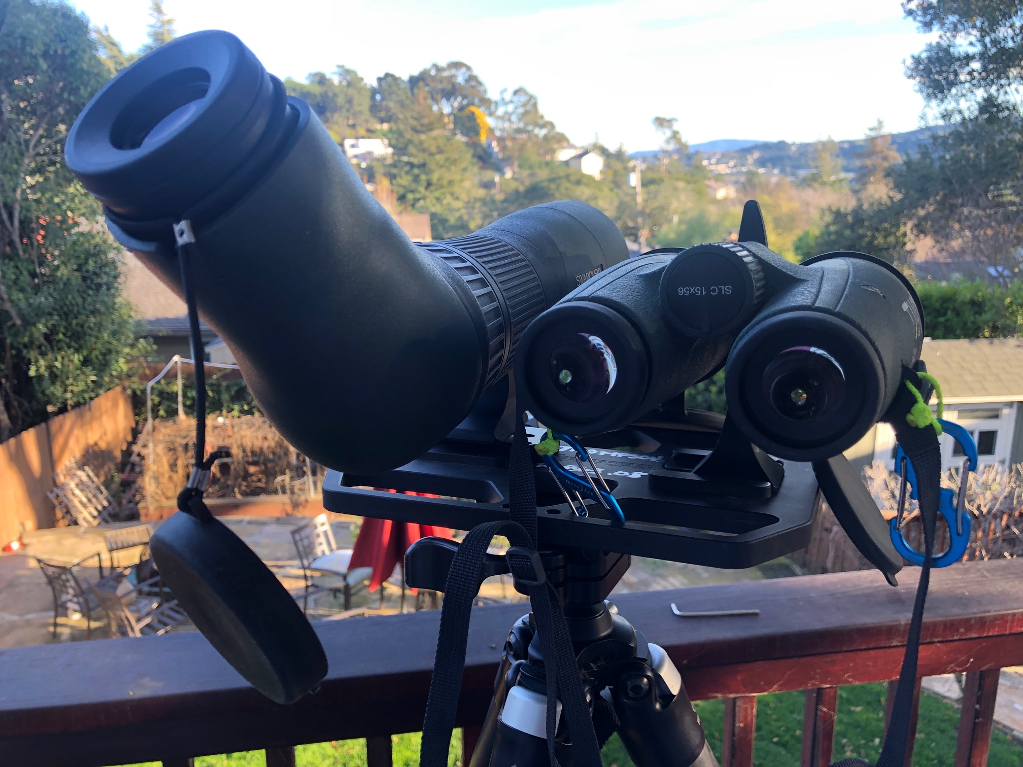

Yep, angled spotters require time to make finding a target feel natural. Binos are more comfortable for hours on end.. But, angled spotters can help keep the sun out and reduce the tripod height helping make things much more stable. It is not only the ocular raise, but the fact that your head also lowers making a large difference in required tripod height. It can make the difference in using your shaky center column or not. Here is a photo from my yard.
