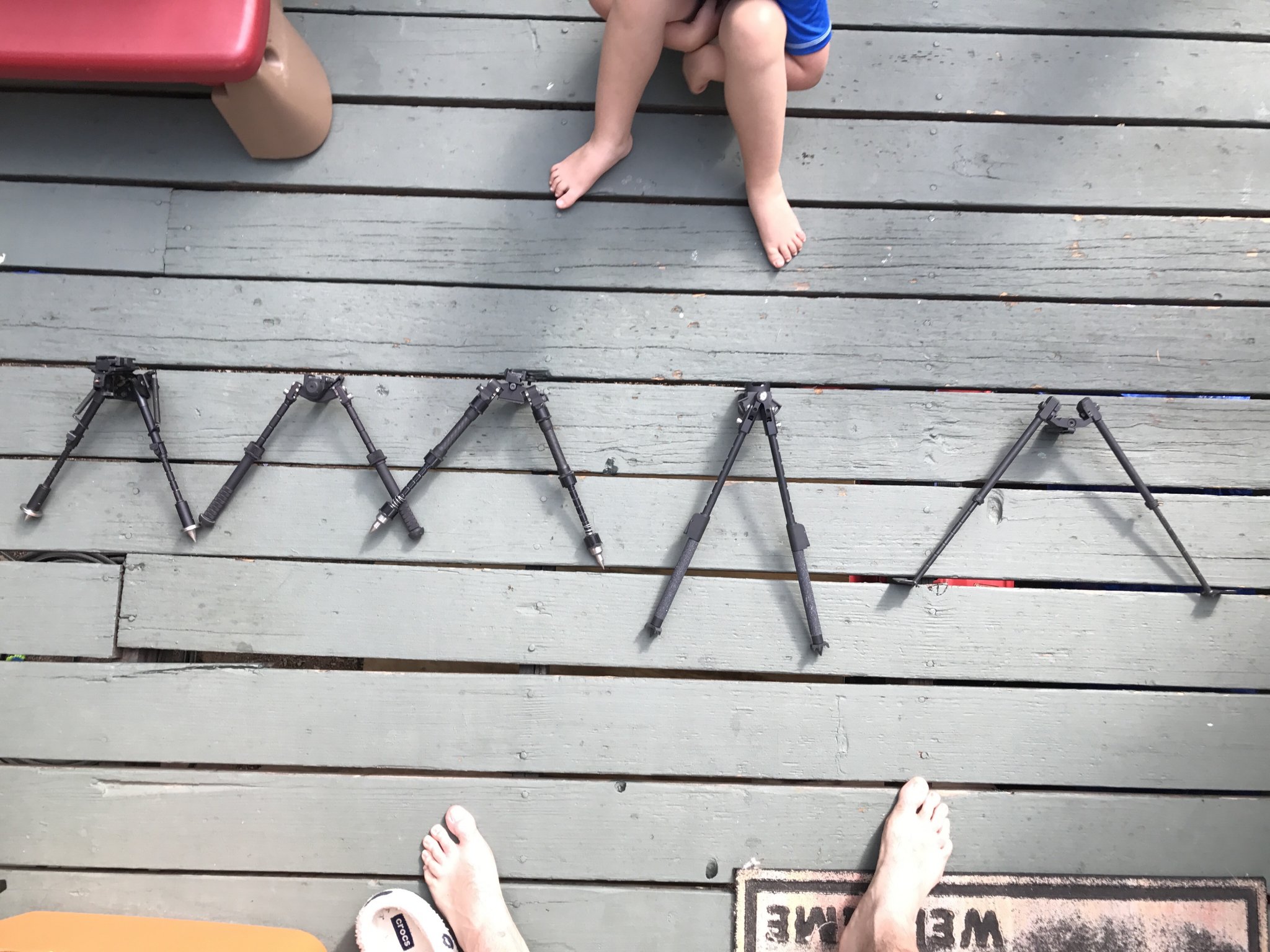

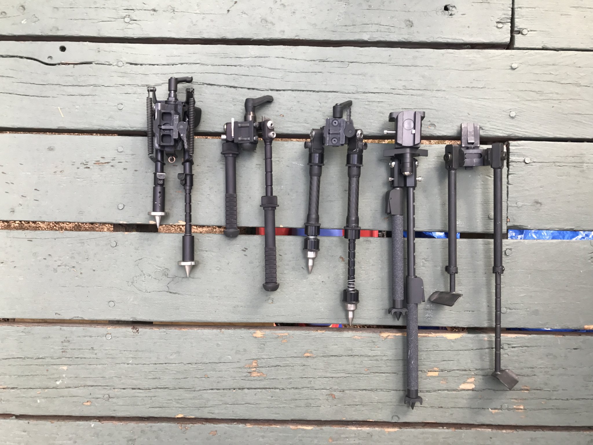

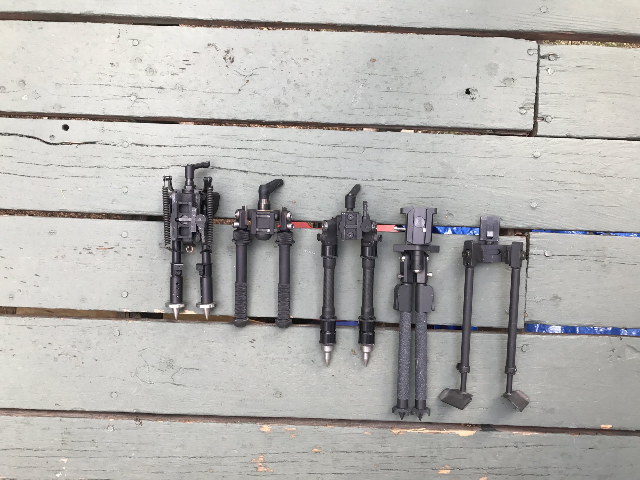

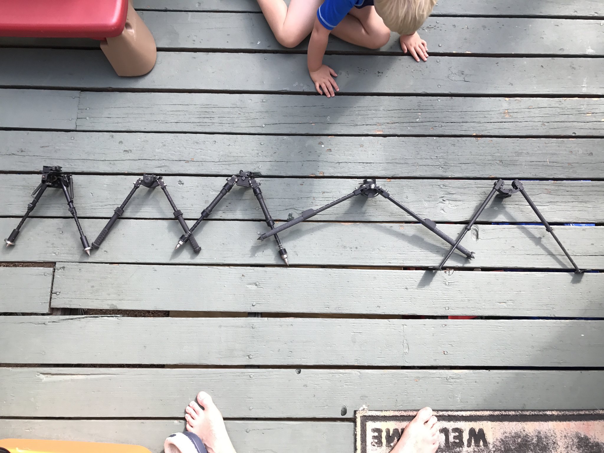

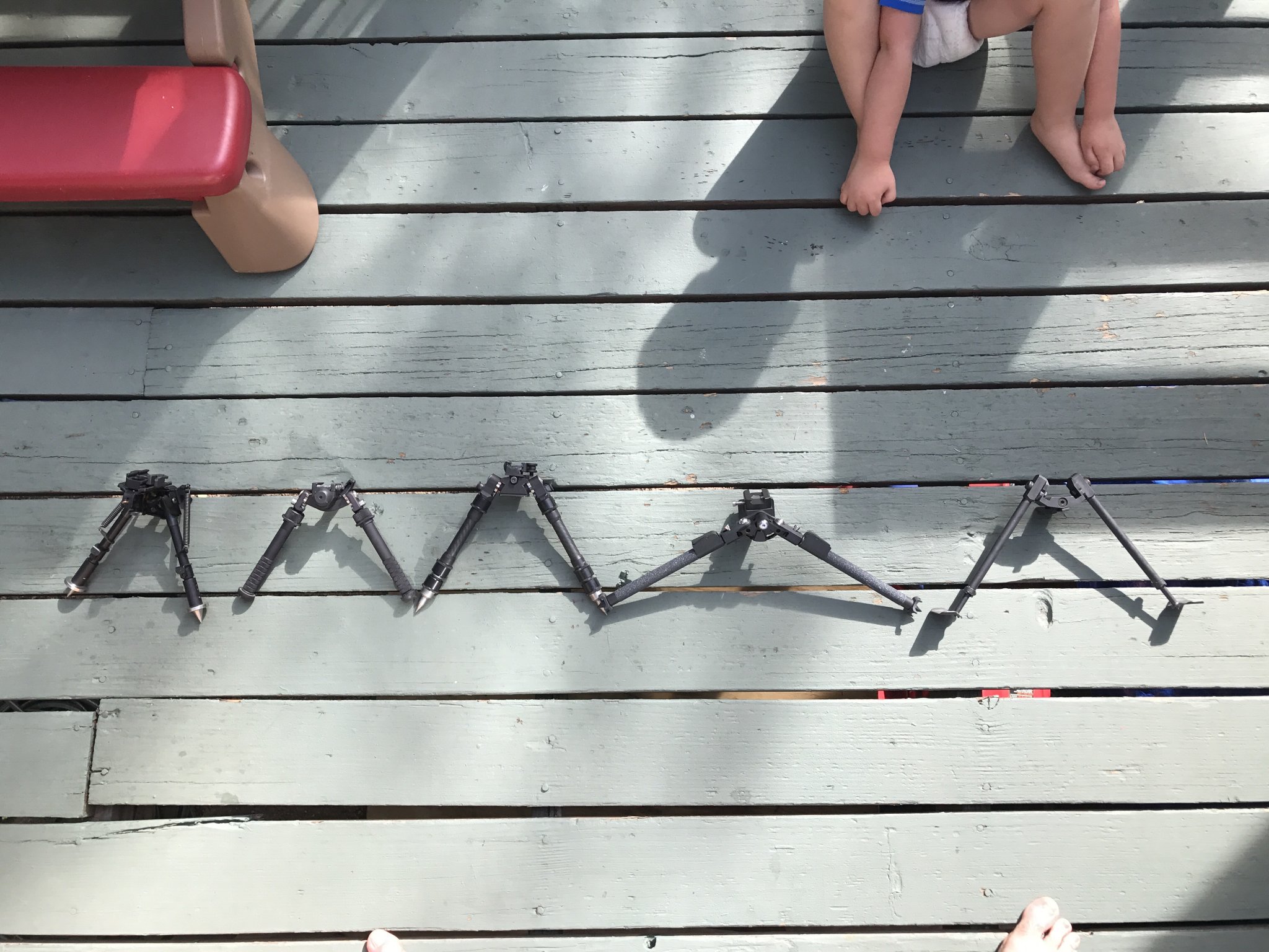

First some pictures. Left to right, Harris with podlock and qd clamp, atlas cal, evolution bipod, ckye, and Sako trg

Harris
Weight 1 pound 4.5 ounces
Folded length 9 1/4"
Folded thickness 2.5"
Folded width 3 1/4"
Height 6 1/2"-9"
6 height settings
Foot width 7 1/2"-10 1/4"
Slack front to back 1/4" - 1/2"
Panning slack 1" - 1 1/2"
Likes
Fast leg deployment
Perfect can't adjustment , not too fine or too course in adjustment and it stays where you set it.
Value/cost if you don't modify and upgrade it.
Dislikes
Spring loaded legs
Very stiff, not much play in legs
Legs can collapse when trying to pan or adjust.
Narrow footprint feels less stable
Atlas cal
Weight 13 1/4 oz
Folded legnth 8 1/4"
Folded thickness 1 1/2"
Folded width 3 3/4"
Height 6 1/4" - 9"
5 height settings
Foot width 9 1/4" - 12 3/4"
Front to back slack 3/8" - 3/4"
Pan slack 1 3/4" - 3"
Likes
Light weight
Legs don't rotate
Feels low and stable
Legs fold 45 and 90* in both directions
Dislikes
Can't not as smooth as others in review
Can't adjustment feels courser than Harris, little movement makes big adjustment.
Can't adjustment seems to work loose
Disclaimer, I just received this bipod yesterday and is practically brand new. I'm sure it will loosen up and smooth out. I have yet to shoot with this bipod.
Evolution bipod
Weight 1# pound 3 ounces with spike feet
Folded legnth 10 1/2"
Folded thickness 2"
Folded width 3 3/4"
Height 8" - 10 1/2"
7 height adjustments
Foot width 11 1/4" - 14 1/2"
Front to back slack 3/4" - 1 1/2"
Pan slop 5" - 6 1/2"
Cool features on this bipod. Legs are QD and can be swapped for different legnth up to sitting height, they also have a tripod adapter that pops onto the socket for the legs.
Likes
Legs don't rotate
Quite a bit of slop in the legs allowing panning and I like the feel when loading.
Has panning head and non panning head available
45* and 90* legs in both directions
Legs don't rotate once poked into the detents
Dislikes
Legs rotate until locked into detents. There are 4 detents that the leg locks into preventing rolling but legs will roll up to 90* until they lock.
Legs are spring loaded
Leg extension release must be pulled upwards which for me is awkward and usually requires 2 hands to make adjustments.
Can't adjustment is too course like the atlas and can work loose.
Ckye
Weight 1 pound 5 1/2 ounces
Folded legnth 12 1/4"
Folded thickness 2 1/2"
Folded width 2 1/2"
Height 5 1/2" - 14 3/4"
8 height settings
Foot width 6 3/4" - 27"
Front to back slop 3/4" - 1 1/4"
Pan slop 3" - 3 1/2"
Likes
Love that the legs extend by just pulling, no buttons or levers.
Like that it comes with spiked feet
Like the built in barricade stop
Love how adjustable it is, not sure how much all the adjustment will help in the real world.
Like the button release for the piccatiny rail allowing it to be slid on rail forward and back.
Like that the panning feature can me adjusted pretty much out.
Really good tension adjustment for cant. Uses set screw instead of Knox or lever and I love it, nothing to bump or stick out and seems to hold the setting.
Dislikes
It hangs down off the rifle quite a bit
Cost
Friction fit on some of my piccatiny rails
I just received this bipod today so don't have any shooting yet. So far seems like a really nice bipod with tons of adjustment
Reactions: Jeffd
And last but not least, my reigning favorite,
Factory TRG bipod
Weight 1 pound 7 1/2 ounces
Folded legnth 11"
Folded thickness 2"
Folded width
5 1/4" at feet 3" at legs
Height 4 1/2" - 8"
7 height settings
Foot width 12" - 1 1/2"
Pan slop 2 1/2" - 3 1/2"
Likes
Very low, wide stable bipod
Alex of legs is above the barrel making the barrel hang in the center of the triangle = very stable
Legs reply by pulling out and down, no buttons or levers and not spring loaded
Wide feet that float in soft material but also have claws that bite when needed
Dislikes
Only fits in spigot mounts
Wish it had some cant tension
I think this is still my favorite bipod but willl test it side by side with the new ckye and atlas cal bipods and see how they do in the real world.

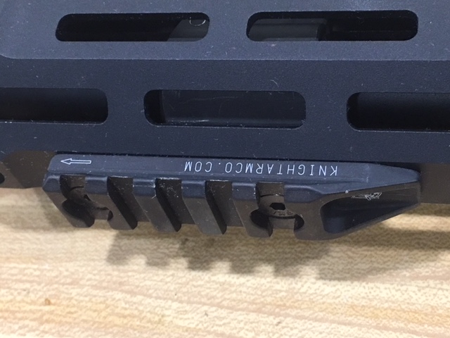

The Ckye bipod's pic rail attachment is less than stellar. They should have used
a true QD attachment, like Atlas does with ADM qd lever mounts.
The Ckye pic mount is inferior, because it:
Only allows tbe user to mount a pic rail by sliding it on the end of a pic rail.
So this means that the Ckye will only mount pic rails that sit proud of the
stock/ chassis.
The Ckye cannot be installed on Kmw Sentinel, for example, because the pic rail
for the bipod sits in a recessed inlet.
My solution for this was to buy ADM QD lever pic mount and affix it to the Ckye,
effectively converting it into a true QD bipod.
But.. that being said, for the price tag that comes on the Ckye, it should come true
QD ready... not needing another $100 upgrade to make it so.

I agree with the ckye mount. The idea is cool if you have a full legnth rail and can adjust the bipod for different stages, like a barrel or something. The way I look at the ckye bipod is, it's a games bipod, it's not the bipod I'm going to take hunting (atlas for sure) so with that in mind I think the idea behind being able to slide it around make sense. I'm planning on purchasing the arcs head since I will be upgrading to a full arcs rail on my comp rifle.

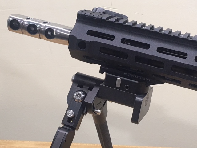

I've decided I want to try something other than the Harris I've been using, which is setup pretty much identical to the one here. The 3 I like best are the CAL from Atlas, the Evolution, and the Cyke. So this thread has all my bases covered, just wondering if you have any updated feelings or experience with them.
On the Cyke-Pod. I bought both the Picatinny and Arca Swiss Heads so I could see which I liked better. For my application the push button Picatinny Heads is perfect . I used the KAC 5 slot rail which has a lead in ramp for very easy, no look, one hand attach and detach. If I ever get a bolt action rifle I would think about a full length Arca Swiss rail and then the Arca Swiss head would make perfect sense.
Rasyad
Reactions: Jeffd
I got my Cyke Pod yesterday and I'm anxious to use it.
I got both mounts also, I think I'll be using the Arca mostly. Unless you foul your smooth forend with a full length Picatinny rail, you can't really use the barrier stop with the Picatinny clamp. The Arca can't lock on the rail so it's not perfect either.
I have an idea to improve it but I'm not sure it's feasible yet.
Otherwise, it looks great. I love how wide the legs can go and the cant and pan drag seem good. There is some play between the legs and the pivot locks so the legs wobble if not loaded. I'm going to have to figure out how it likes to be loaded but I think that should be pretty easy.
If I can splay the legs out wide, I don't think I'll ever have to worry about a rifle falling over on the bipod because the cant drag is quite stiff and it is held quite low.
