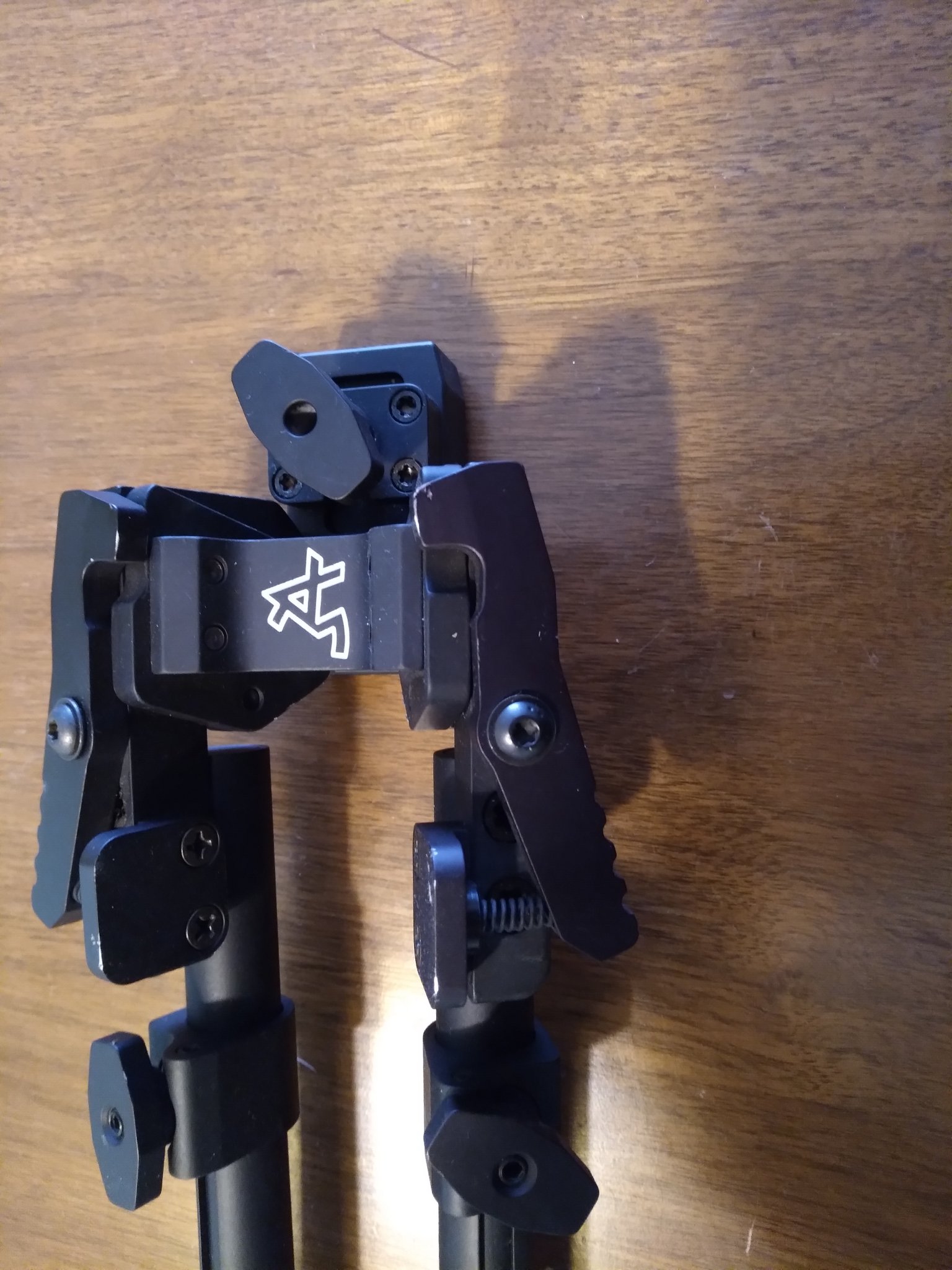

If you're looking at $300+ bipods then it's safe to assume that you're talking about Atlas and up. At that price point it's hard to go wrong, you simply need to figure out which strengths and features are most important to you and zero in on one from there. Some have features you may want like the ability to pan and others don't, personally I have never needed the feature and I have seen rifles fall over because of it. I'll touch base on some of your bullet points.
1) At this level they are all very well made.
2) Atlas has more inherent flex in the legs than TBAC and Accu Tac simply by leg design.
3) The Atlas 5H, Elite Iron and Accu Tac bipods offer this feature, it lowers the bore and increases stability.
4) Make sure you get one with a lever to adjust for cant, pan feature is a personal decision.
5) Being able to deploy the legs easily with one hand is important IMHO.
6) They all have interchangeable feet, some are much easier than others to swap.
7) Leg extensions are nice to have but rarely have I ever needed them, those who compete and hunt with theirs might find this more necessary.
8) Like the apex feature, this pushes the bipod even further out increasing stability and leverage and depending on design can further lower the bore as well.
9) As long as it has a 45 degree setting I think that's all that one needs, being able to easily and quickly adjust the leg positions is better on some than others.
Taking all of that into consideration I ended up with the TBAC bipod as it met all of my needs more so than any other option out there. The tool-less leg/feet swaps is nifty and you can deploy the bipod simply by sweeping down on the legs. I am very happy with my decision but I am sure that I could be just as happy with an Accu Tac or Atlas 5H as well.

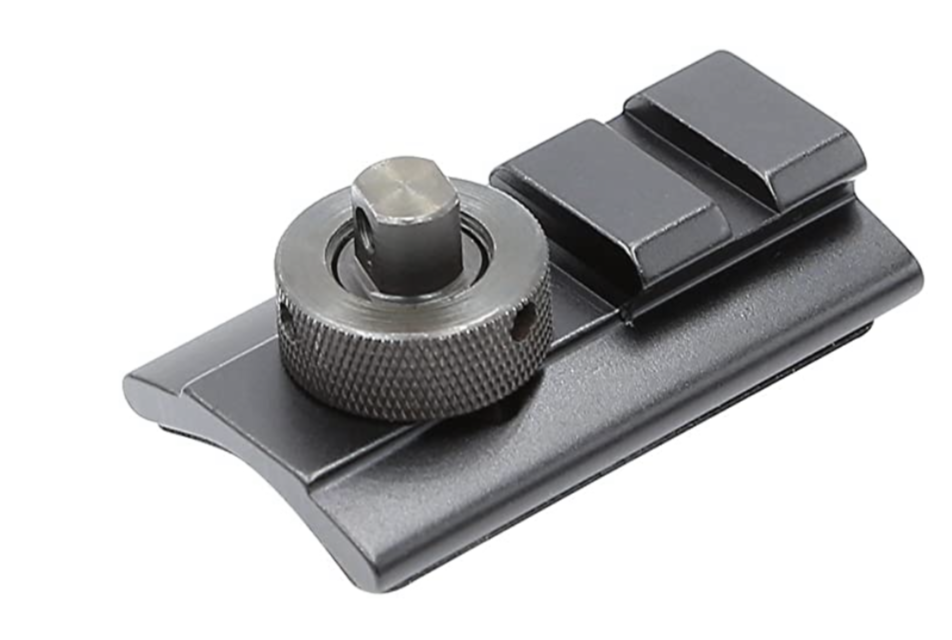

Looking at the different attachment options between picatinny and arca, what are some experiences I should be aware of to influence which direction to go?
If you are going to use anything but the sling stud then go arca.
Reactions: Bro Mo
Im new to this as well, I have a couple cheap stud mount bipods that mostly suck and one that mounts to a picatinny rail that is much more stable and I like better. Easier to swap quickly as well. Looking at the arca it seems more difficult but Ive never even seen one only on the internet. Problem is none of my bolt guns have pic rails where I want to mount the bipod, just the AR's. Is there an adaptor that will allow me to do that, either mounted over the studs or remove them and replace them with the rail. I cont care so much about having a swing. Please answer as a 'reply' so Ill get notified and not lose this thread.
KAC makes a very good stud mounted bipod adapter.
There are TONS of them of all different sorts. Google it.
ARCA gives you the ability to quickly loosen/tighten and slide the bipod back and forth along its length. Here's a photo of my rifle in an MDT ACC chassis, which has the rail machined into its entire fore end length. Other chassis or stocks can have ARCA rails mounted via M-Lok or other attachment mechanisms.
The slotted picatinney rails are usually short and provide secure mounting in more limited positions.
Note how far back the Atlas bipod is placed on the ACC's rail. Behind it is a GrayOps "gamer plate" which increases stability atop bags and such.
Im looking for exactly the opposite, a pic rail that will mount over the existing pair of stud swivels ( or remove them and use screws to to mount a rail in their place)allowing me to mount a bipod onto the rail
Like this? I have used them and they work.
Budget: Harris “HBRMS” w/ PodLock and ADM pic mount
Better/Best Option: Atlas CAL w/ the new RRS SOAR ARMS mount
I have seen that one but it looked really small. I found this one that looks a bit more secure.
Pic Rail Adaptor Plate | Caldwell​
https://www.caldwellshooting.com › Rests
The Caldwell® Pic Rail Adapter is perfect for utilizing both your shoulder sling and a pic rail mounted accessory at the same time. By adjusting the tension on the front and rear T20 screws you can change the vertical angle of the Pic Rail Adapter to align with the barrel instead of the stock.

Not sure as to the make of this bipod, I dont remember where or when I got it but it locks up tight and is simple to use.
Thanks Super Mod. ;)
Here are some in stock but it is Optics Planet LOL just check your hole spacing.
I saw that one as well and will be looking for one, though it seems on back order. It looks like the best choice as it actually uses both stud swivel holes, should be really secure.
That looks like a GG&G bipod, I’ve had one for years and they do lock up tight with minimal “flex” even with the legs at 45 degrees .....it’s a good bang for your buck option (my opinion)
