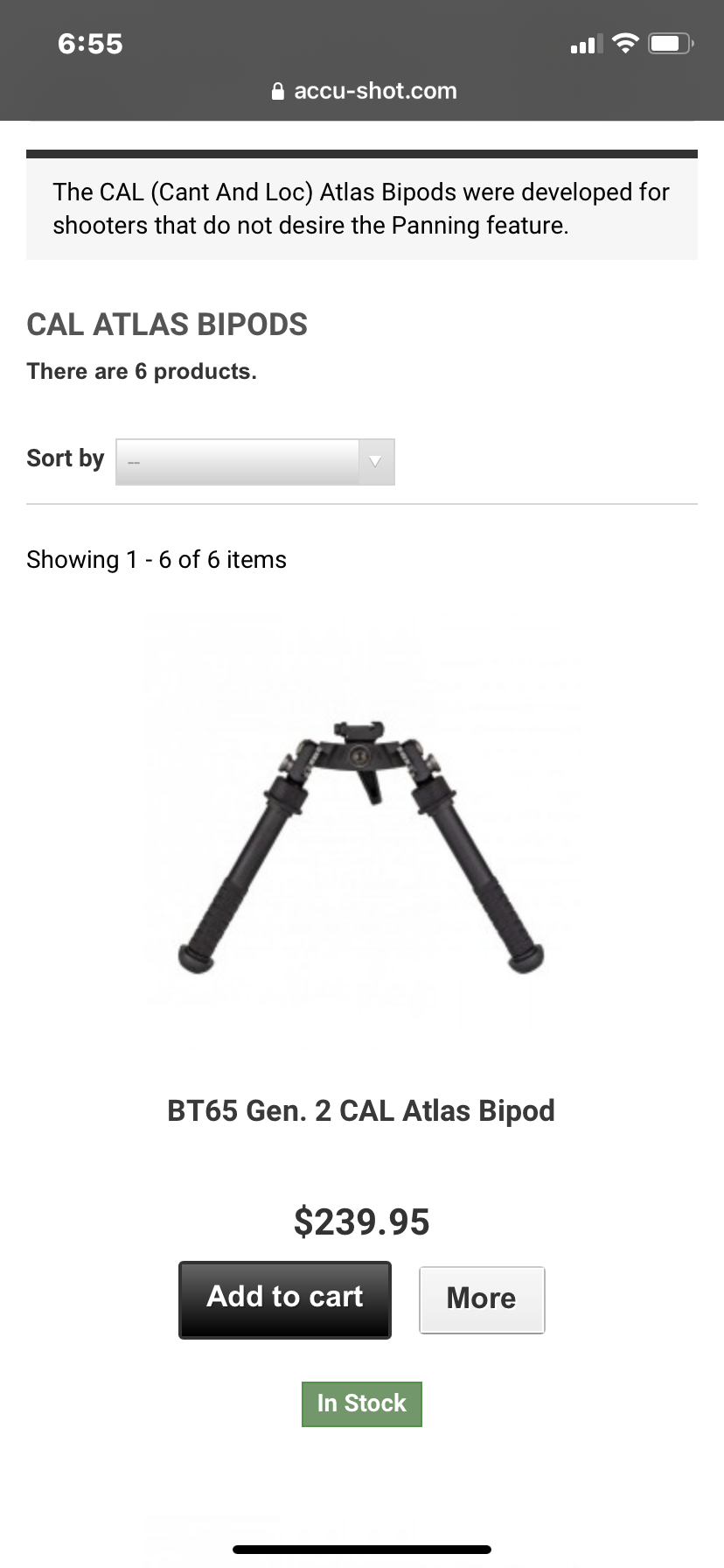

Frank Galli specifically recommends the Atlas Cal without pan. Or thunder beast but that’s more $$$
What is your budget?
I guess I don't really have a budget yet. If there is a compelling reason to spend thousands, I would probably do it. Never been particularly shy about spending money :). I'm just thinking for what a bipod does, I probably want to be in the $100-$250 range. Unless there is a compelling reason to do otherwise.

Like everyone else said: Atlas Cal Gen 2. Sounds expensive until you figure out fully upgrading your Harris will end up costing more and doing less (ask me how I know lol).
That said, if your rifle is tipping that easily, it sounds like you don't have a KMW Pod-Loc on your HBRMS or any ratchet lever like mentioned above (which is pretty much a necessity)..? They're ~$20 for a legit Pod-Loc and IMHO a HBRMS is nearly useless without one. You don't have it "as tight as possible" if you're using the Harris' crappy knob, Pod-Loc fixes that, I'm sure the $7 jobber gets it done too.
Reactions: Mikenbiken
Atlas cal and be done with it. It’s a quality piece of gear. If you are used to using cheap bipods it will be very apparent why this is worth $250 the first time you mount it on the gun, feel how rock solid it is, then shoot off of it
