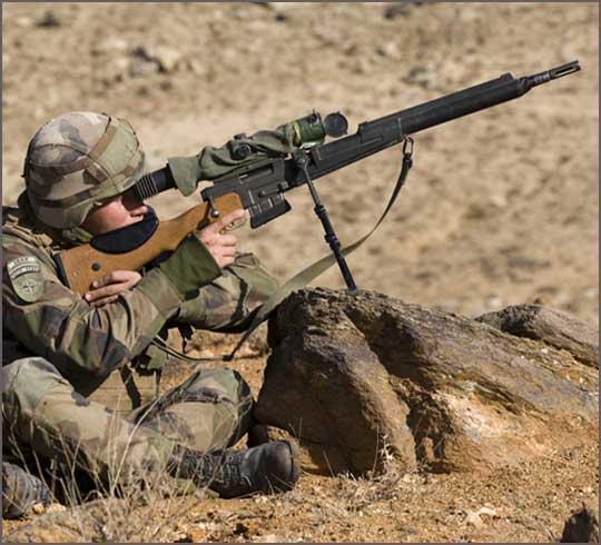

The French F2FR rifle had this cool integrated bipod mounted way back. Had some play in it for transversing when tracking a target. Was placed in the spot it was for reasons shown in the pic.
For a hunting or DMR type setup I think this would work well. For max stability then out front is best.
Placing a bipod in a location based on the need for an up-angled shot from a big rock seems pretty specific…
Yeah, but imagine lots of improvised spots in which you need to take a quick shot. Windowsills & belly/chest-height walls in which you need to shoot steeply downwards/upwards, any shots in which you need to track a target, lots of not-prone positions, etc.

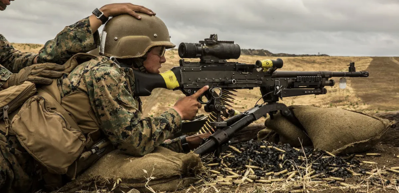

In my way of thinking, a bipod way out front has a more specific use than a support mounted more centrally. Think about how you mount a gun on a tripod or a how a number of machine guns mount to their support.
Of course you sacrifice the most stable position for versatility.
And yes, I know the OP doesn’t have a MG. Just using this as an example as how mounting a support further back can be useful and that front mounting isn’t the end-all be-all (but it is the most stable). Just keeping the mind open…

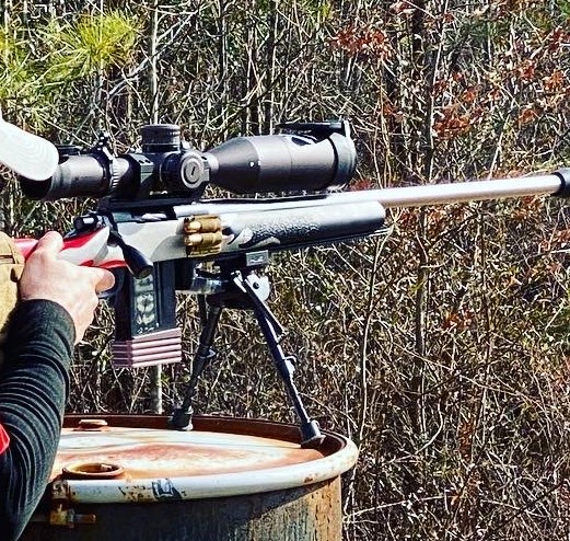

From a technical standpoint you are normally best served by placing the bipod as far out as you can get it underneath the rifle, as this maximizes your “stability”.
However if you foresee yourself ever having to manipulate the bipod‘s under pressure/time constraints or off of a shooting platform of reduce size, then placing bipods back further towards the receiver tends to trade that for the benefits of being able to make adjustments with breaking body position and or place the bipods on a larger variety of not standard shooting platforms.
It's my experience too that in some situations having the bipod farther back can allow me to get closer to the platform and get more points of contact, buying back some stability for a shot. This has worked well shooting off of 55 gallon drums, tree stumps, rocks, stuff like that.
