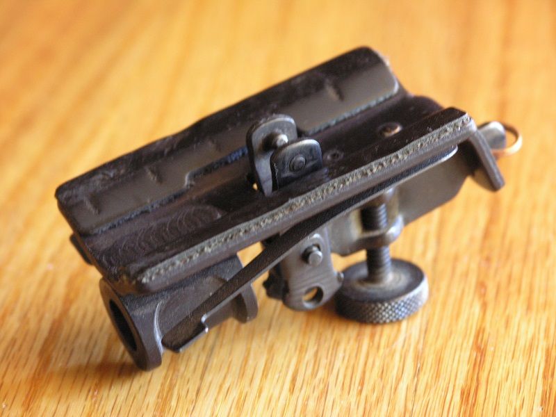

I've got a 10" Anschutz Rail in the bottom of my X-Ray 51 so I'm running an Atlas BT28. If you have an Anschutz Rail in the bottom of your stock I highly recommend a BT28 Rail in combination with a picatinny rail-equipped bipod (Larue LT706 QD Mount + Harris BRM-S) is ideal. ALL of the (many) rail-equipped bipod adapters that incorporate a bipod stud increase "stack", sit a little higher, and are heavier than the direct-mount LT706 configuration. Elimination of the Harris "saddle" lowers the center-of-gravity a little and reduces the Harris's weight by 2.8 oz.

X-Ray 51 with BT28 Rail in Anschutz Rail with Harris BRM-S + LT706 QD Mount Combo + KMW Gen 2 Pod-Loc:
Eliminating the Harris "saddle" lowers the center-of-gravity a bit as well as reducing weight by 2.8 oz.:

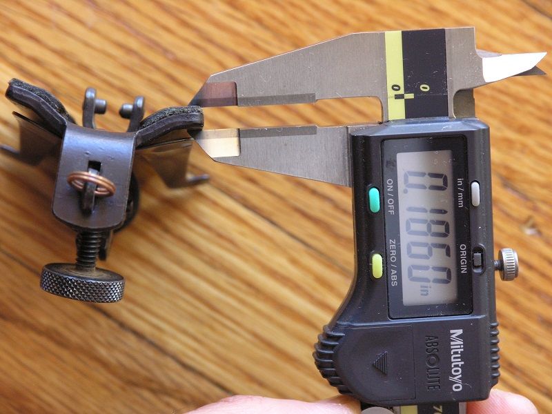

The only thing about the BT28 AFAR Kit is that you may have to shorten the 1/2" long screws that are included in the Kit. I have some older BT28 AFAR Kits, and the short screws in the BT28 AFAR Kits are really too short to work optimally in McMillan "Anschutz" Rails, so the (supplied) 1/2" long screws needed to be shortened to length. The BT28 Rail attaches to accessory rails by capturing the "lip" of the host Rail between the BT28's Body and the opposing edges of the BT28's two "Nuts" as the BT28's screws are tightened. When installed in a McMillan "Anschutz" Rail, the short screws barely had a full thread engaged on my BT28's threaded "Nuts". IMO that's not enough thread engagement to ensure that the screws won't loosen or strip-out if the bipod is bumped around. Hence I shortened (the included) 1/2" long screws to use the BT28 on McMillan Rails.
NOTE: The (supplied) short screws work well on the rails in the bottom of Bell & Carlson stocks (the Rails installed in the bottom of Bell & Carlson stocks are made of thinner metal, and the "lips" of these rails are also thinner so ). Because of this the screws don't have to be as long and the short screws included in the BT28 AFAR Kit worked perfectly when I tested them in the Rail of my brother's B & C Medallist Tactical Adjustable.
