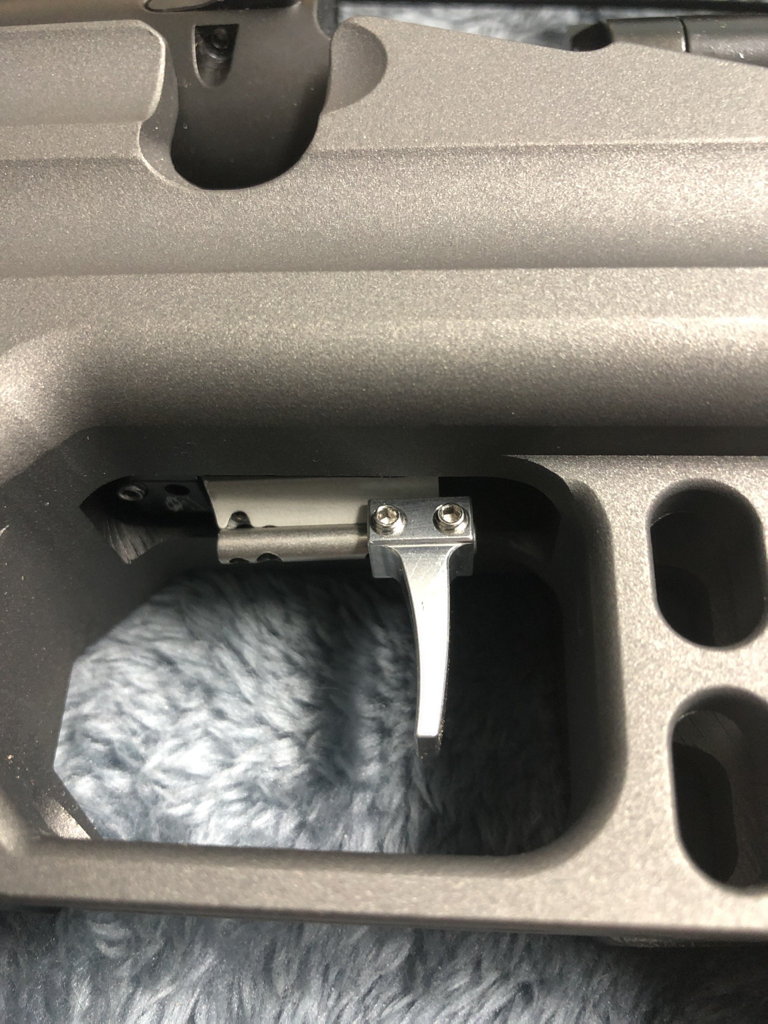

Came off a Timney CE to the TT Diamond and have to say the diamond is a great piece of kit. No creep it just goes. Never used Bix n Andy
Ive never even seen a tt diamond but have never read anything but good about them. I think ttd is probably easier to adjust but i think b n a has more ways to adj, first stage weight and length of pull back to 2 nd stage. weight of pull of 2nd stage. Where the trigger is on the rifle, about 5/8” adjustment. mine is all the way back. It will also swivel on the round bar. I had to cut a little off my first stage spring to get it down to 1.4 oz, 2nd is 1,6 for a total of 3 oz, mine will vary about 1/2 oz. The varriance vould be the way i measure it.

But now its the best trigger ive ever seen!

That's the biggest difference. Once a TT breaks, you know it, you finger comes to a dead stop. The BNA just keeps coming rearward through the overtravel, its quite nice, zero affect on squeeze and follow through. All my builds will have a BNA from now on, but I'm not gonna pull all my TT and swap em out.
I also prefer to have some over travel versus an abrupt wall.
Reactions: 4O6shootist
My only experience with two stage triggers is on a Hiperfire XP3 I think it's called on my gasser. I'm currently stepping into the bolt world and have a TS Pro on the way for my Archimedes. When y'all say there is no wall after the break, which the Hiperfire definitely has, is it like a reverse first stage?
I'm not too concerned since I have no preference currently, it's a whole new platform. I'm just curious how that works without a stop if that makes sense.
I tried putting a ts pro on my Archimedes, it was horrible with the standard sear height, believe you'll need a low sear. I just put my spare TT special in, no issues. Check sear height prior to avoid my observed issues. Bolt lift was horrid, trigger weight was insane. Tried adjusting the trigger to tune it with no solution.
I have a low sear coming with it. I've seen multiple references to needing it. If it happens to fall in between, i'm not against fitting the middle one if necessary. I doubt I'll be disappointed, only fired a few bolt guns before and it was a very, very enjoyable experience compared to a gas gun.
