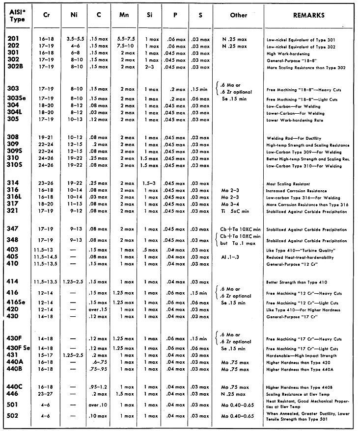

There are all kinds of "Stainless". Depending on the composition, some will blue/oxidize and some won't, just like some is magnetic and some isn't.
7091174
That is good info. This is the first time I have come across this issue with any barrel. I will likely surface prep and try again. I am surprised about how much minor temperature changes affect different metals
