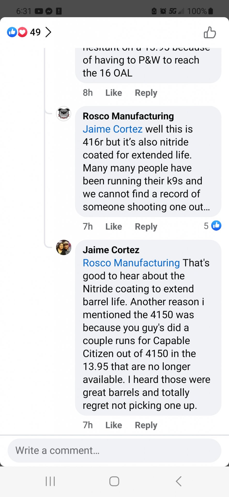

Every time someone calls nitride a coating God kills a kitten. Sounds like your WO barrel had a tight or rough chamber, SS isn't any more averse to being dirty than anything else.
Criterion has a lot of customers shooting sub moa CL barrels, myself included.
What’s even worse are the vendors that describe it as a coating. Clearly have no understanding of the product they’re selling.

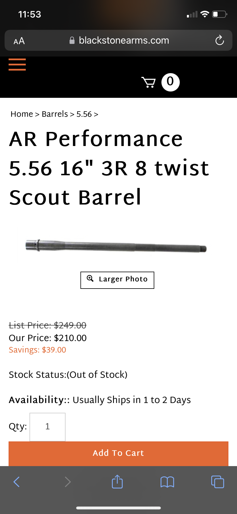

Just a heads up OP. The picture of the melonited scout barrel on Blackstone’s site is wrong. The scout looks more like a criterion hybrid. The pic he’s using is the old Socom profile with 5/8x24 muzzle threading. For some reason, that bothers me. Lol
I think I've noticed BA and a few other prominent names make that mistake on their websites. Always hurts my confidence in a company, like what other technical details are they unsure of?

Calling it a coating? Or nitriding itself?
Nitriding is a surface hardening conversion and absolutely changes the metal, for the better in this application.
