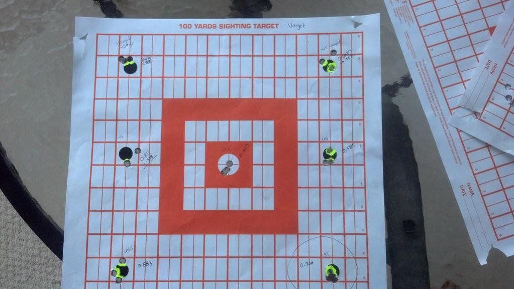

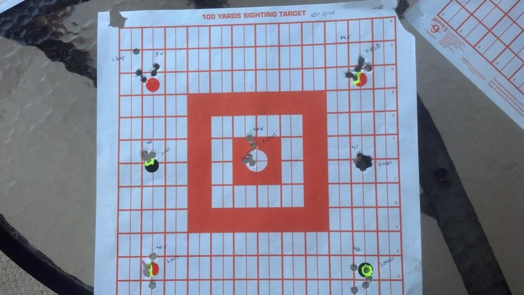

I know I am about 5 years late to the party with the Blaser, but after years of waiting I finally was able to get my hands on one of my "holy trinity" guns (being a poor college kid sucks). Naturally, the first thing I did was start to develop some loads for it. I had some Varget, BLC-2, and XBR laying around, so I loaded some pills up moving in 0.5 grain increments to see what gave me the best results. The results weren't anything phenomenal, but with many groups being 1/2 MOA or less I was plenty happy. Here are the targets

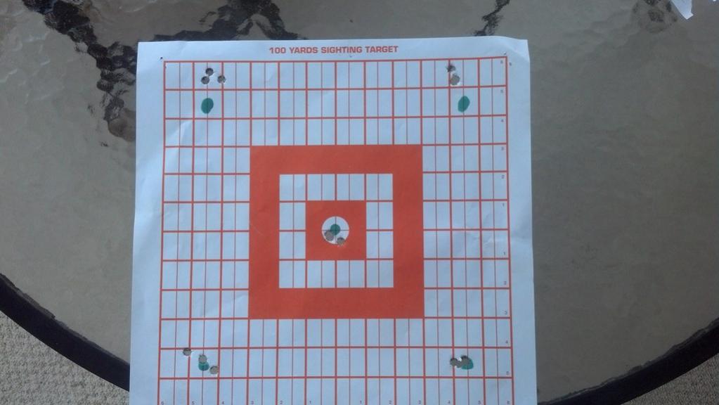

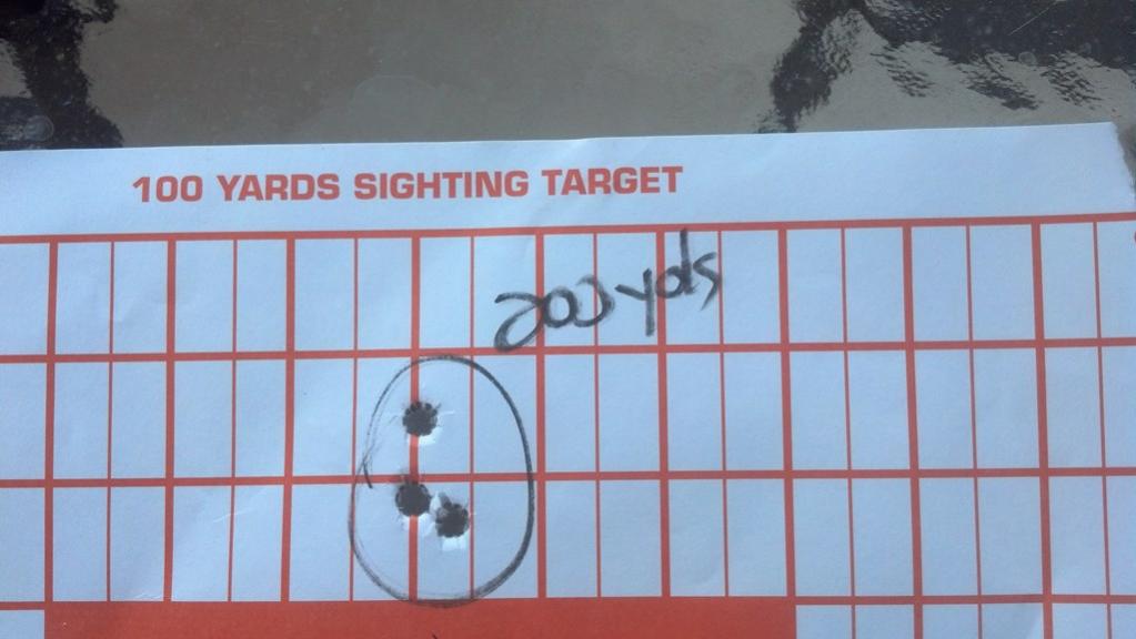

Given the results and the amount of each type of powder I had on hand, I decided to play around with 40 grains of XBR and see how they did at 100 and 200 yards. Today was my off day, so I packed all my stuff up a headed to the range. There was a slight breeze with gusts up to 10mph at times, but nothing too bad. At 100 yards I got a repeat performance of my previous range session.

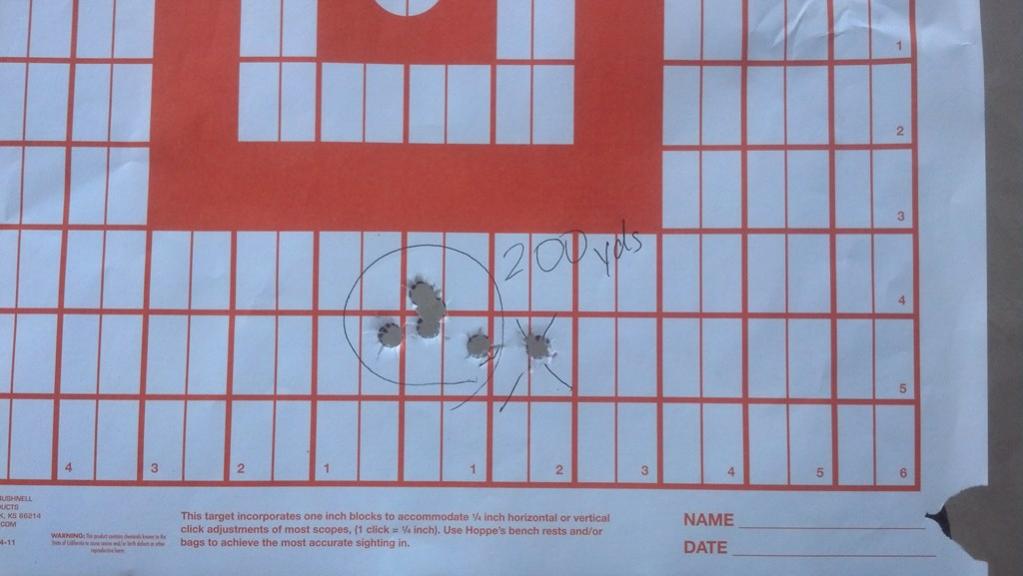

So I decided to back it up to 200 and these are the results I got.
(Cont. next post)
And the second 200 yard group.
The one with the "X" through it was from a previous string where I was sighting in my FNAR with a new scope (not so lucky with that one).

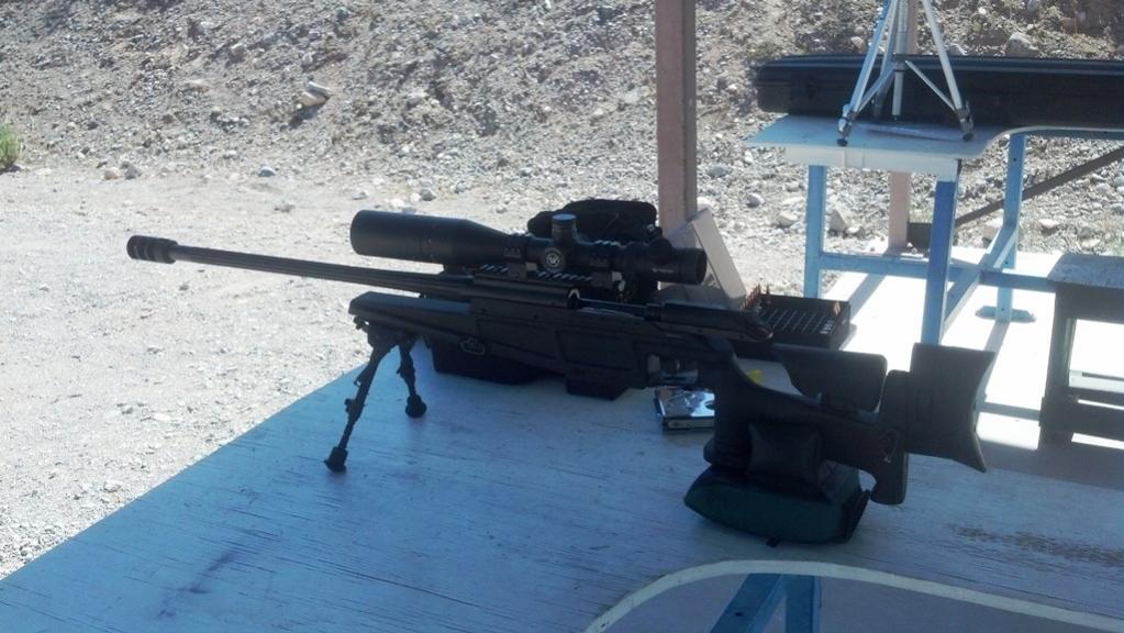

Anyways, I am happy with my groupings and I think they'll only get better with more time behind the gun. Now I just need to decide between the 300 Win Mag or the 338 lapua barrel.

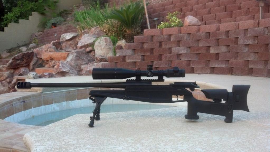

Specs on the gun are:
Blaser Tactical 2
Vortex PST 4-15X50 FFP mil/mil
Weaver high rings
And the load specs:
Federal Brass
210M primers
168/175gr SMK and 178gr Amax
40.0 gr XBR 8208
2.800 OAL for smks and 2.810 for Amax
Looks like you got it tuned in good, Now get out and stretch its legs! That's a monster brake on that thing. Looks good over all.
