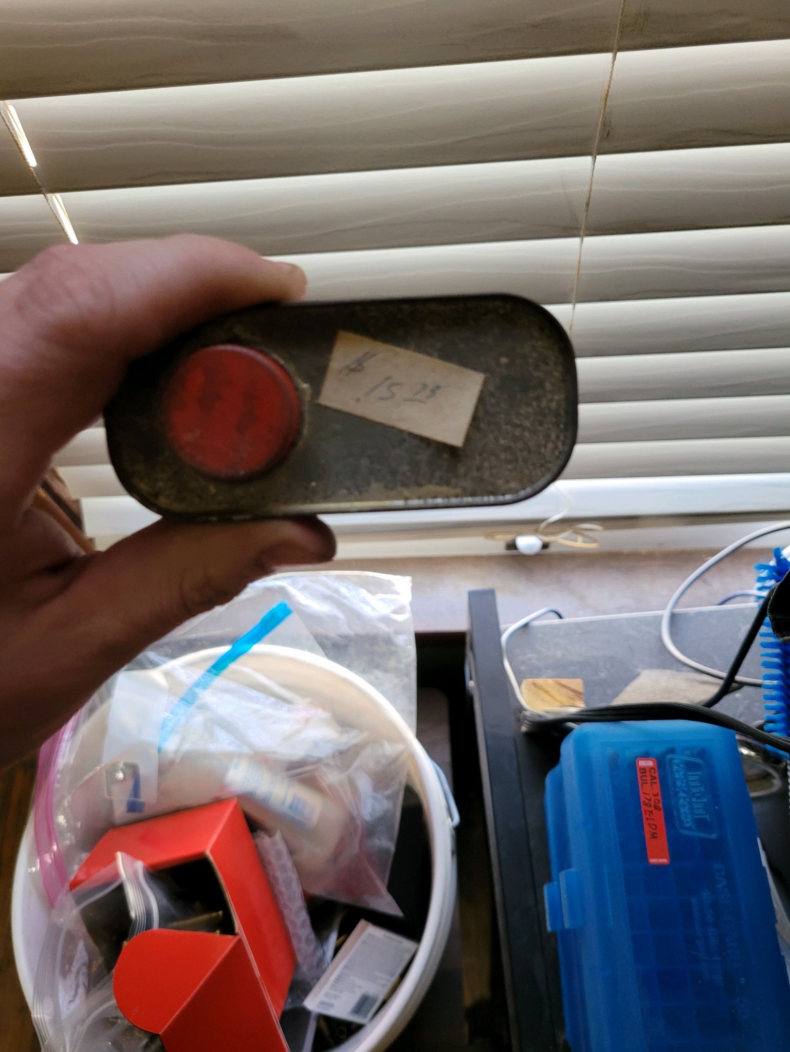

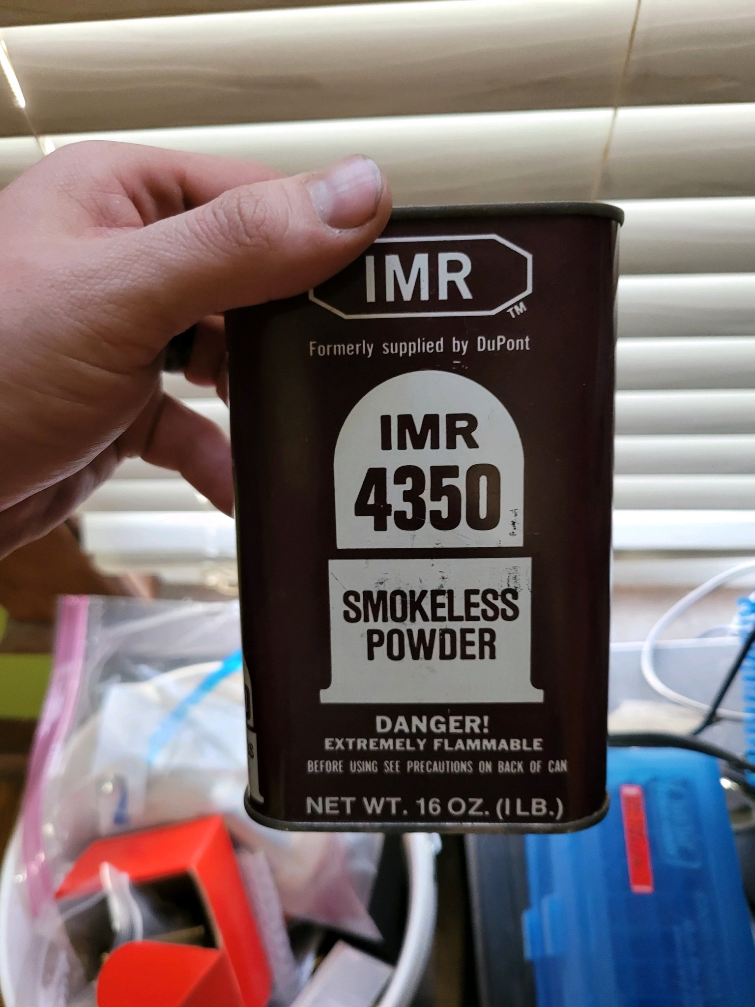

Went through my dad's reloading equipment since he can't do it anymore and found these gems. Plus 2k large pistol primers. Has anyone tried pistol primers in bolt guns I don't have anything that shoots large pistol and would like to be able to use them

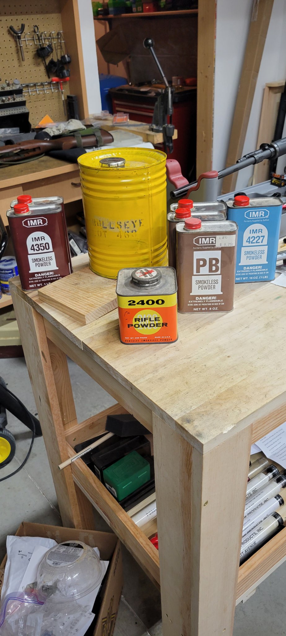

Running out of supplies Bullseye still good 2400 not so

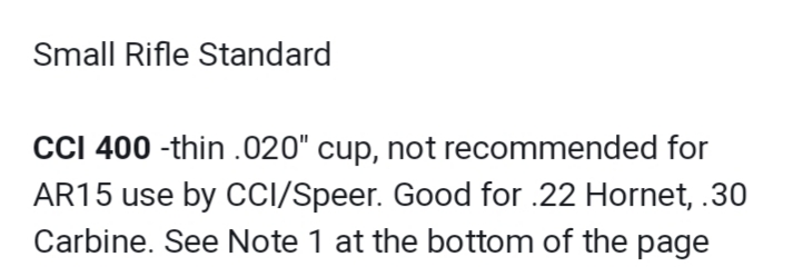

I tried a few pistol primes in .30 carbine. Pireced about half of them. So depending on brand, the pistol primer are thinner or will take less psi than the rifle primers. Wolf brand in my case,

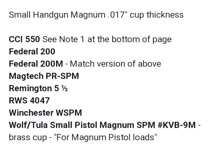

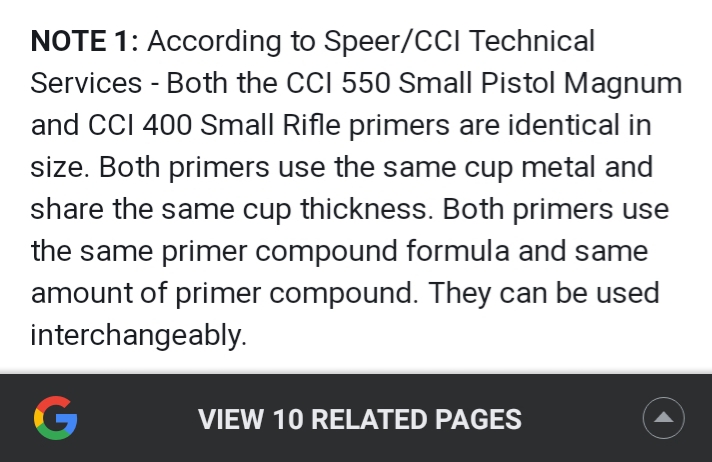

CCI 550 magnum spp and CCI 400 srp are identical and interchangeable according to Speer/CCI.
From the thread "A Primer on Primers":
