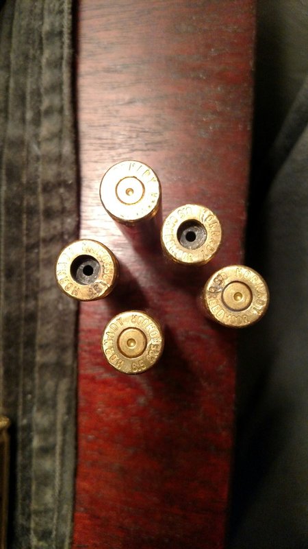

I recently built a 6.5 Creedmoor and will post specifics once I iron out the best load and function. It is mostly JP and Aero precision. I have noticed others have gotten good accuracy out of 42.5 of h4350. I have found this to be a very accurate load as well but I am noticing hard ejection, extractor marks and now blowing primers. I did not notice pressure until I got to 42.5. I will admit that I am not very knowledgeable when it comes to adjustable gas blocks. It is a JP adjustable gas block but I haven't made any adjustments to it as of yet. It ejects cases at approximately 2 o'clock. Beating the hell out of my cases even with +2 gas system. These are new Hornady cases. 140 gr Hornady bthp. Also, using JP silent buffer. No evidence of pressure on factory Hornady rounds. Any advice other than the obvious of backing off on the powder? Maybe such as adjusting the gas? I really like the load regarding speed and accuracy but it's not safe the way it is.

Can't really tell from the picture but are you getting flat primers too?

I am running the JP LMOS bcg. And yes, out of about 10 rounds at that charge, 4 we're blown primers, 2 were protruding and 2 were intact and flattened. All had ejector swipes. Is the charge too high for the low mass bcg? I plan to adjust the gas next trip to the range

Finally had a chance to get it out today. Followed Padom's directions to a T. Amazing. I turned the gas off initially and started opening it each shot. It is very sensitive. As soon as it was reliable, 85 percent of the brass was falling in a nice pile at about 3-4oclock. About 15 percent going at 2oclock. The brass looks really good. Not one blown or flatened primer. The gum seems to run much smoother. Not as violent of an impulse. Very mild ejector swipe on about 50 percent of the brass but very mild.
I was under the presumption the load was over powered and the blown and flattened primers occurred even before the gas cycle occurs. That presumption was proven wrong. I am now leaning toward the primer may have been violently dislodged during the cycle
