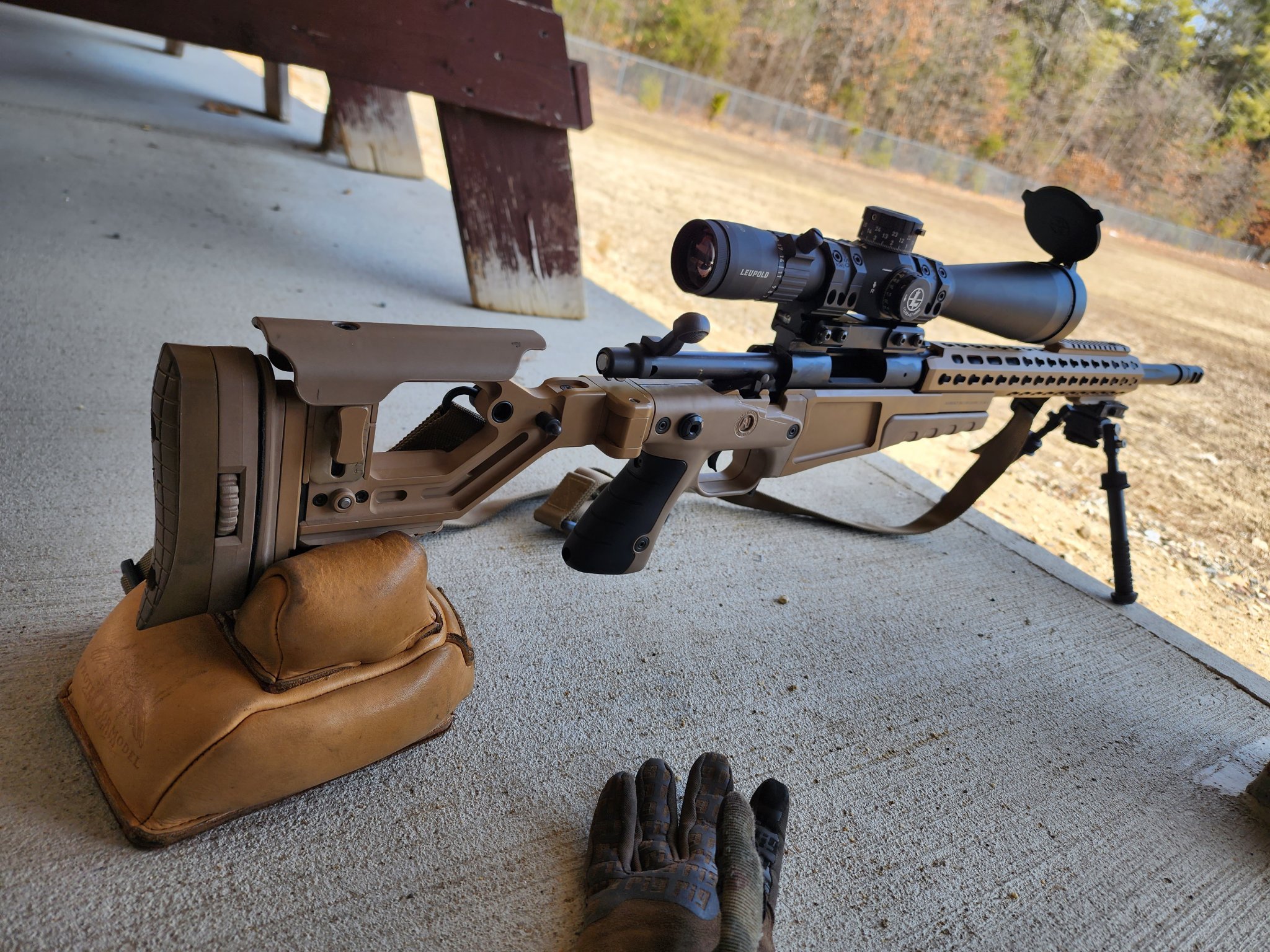

Hey everyone, was out shooting my new to me Remington 700p LTR in AICS chassis.
Ran both 175 grain .308 gold medal match and GGG M80 Ball 7.62.

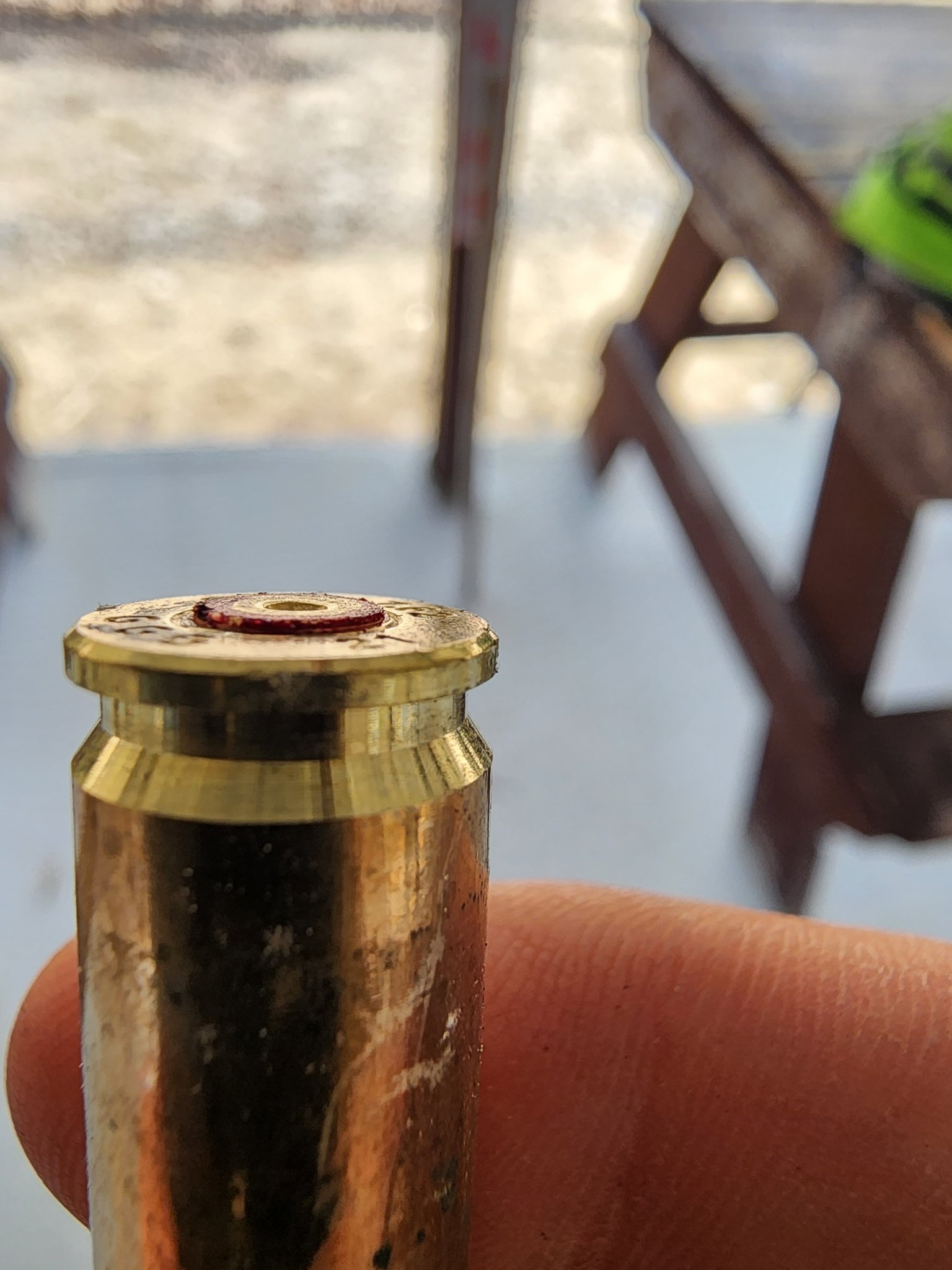

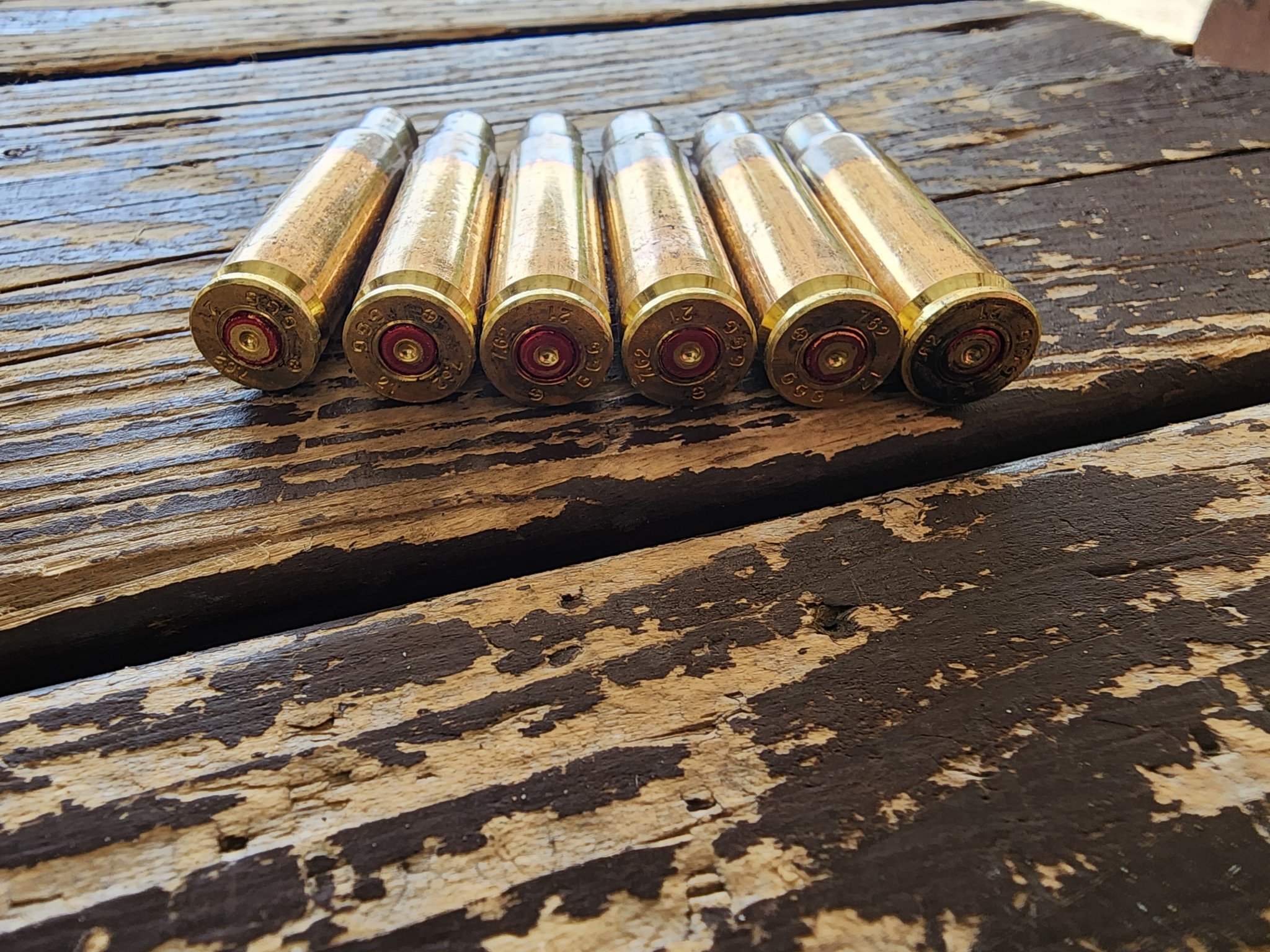

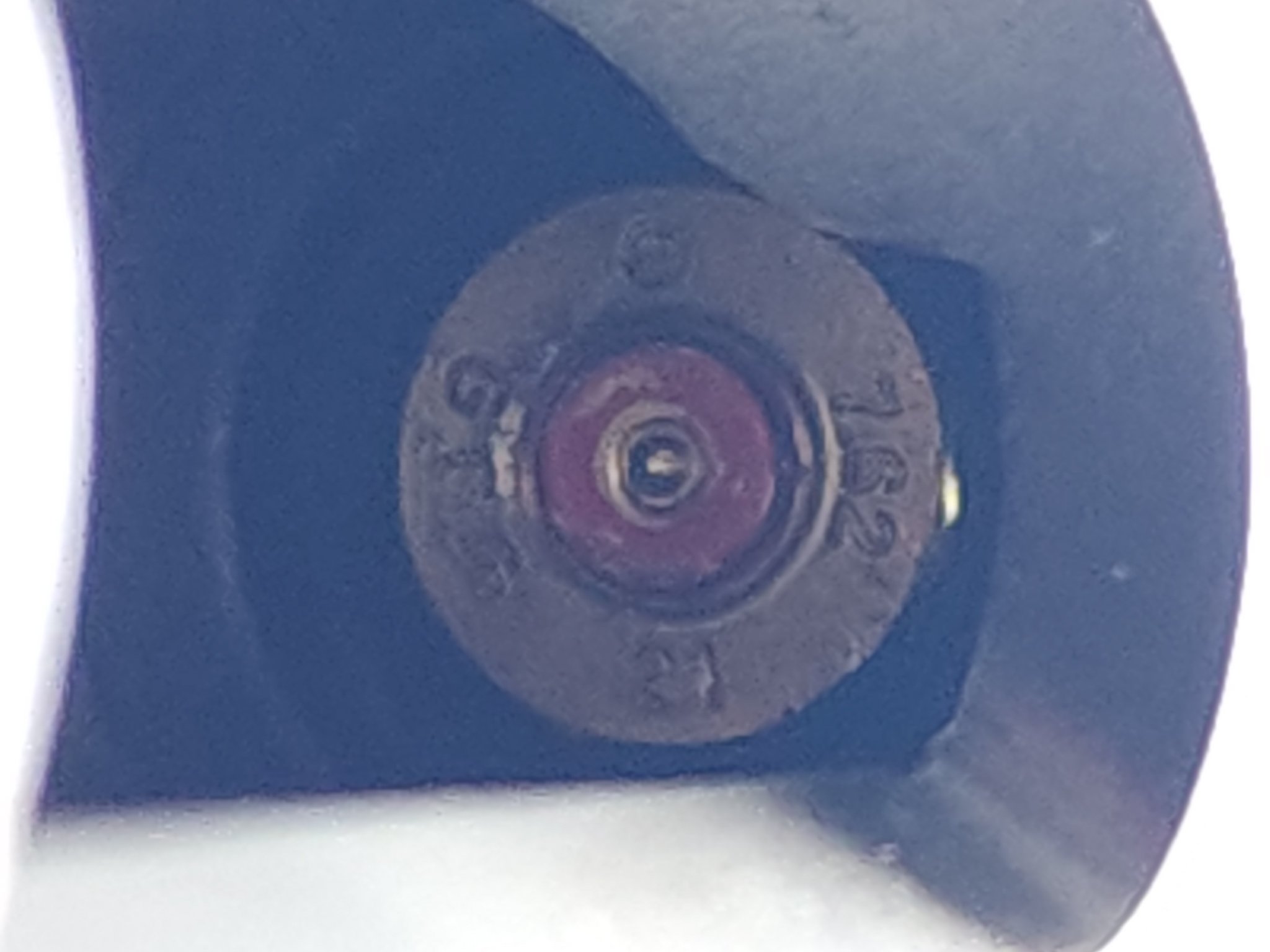

The M80 ball ran terrible. As you can see, popped primers and stuck in the chamber that I needed a rod to get it loose. I also had a round get so stuck I do tap the bolt with a piece of wood to loosen it up.
I contacted the vendor of the ammo who thinks the rifle has a headspace issue. However, once I swapped over to that gold medal match, everything worked just fine.
Wanted to ask the folks on here that would know better than I might.

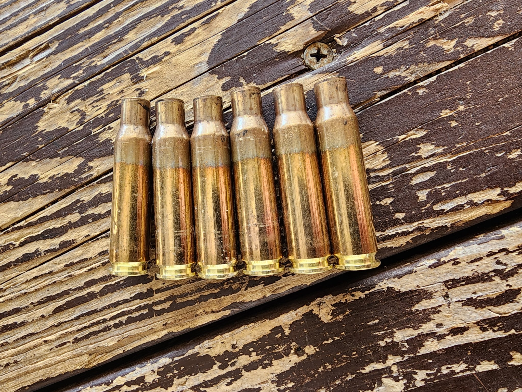

If anyone is wants to see pics of the federal brass...just let me know!

If you still have an unfired round, measure it, chamber it, then measure again to see if the projectile is getting pushed down in the case. 7.62 nato does headspace a little longer than .308, so if your rifle has a tight .308 chamber, you can run into problems with nato ammo.
Reactions: Robert4
The headspace is too much. I couldn't tell you if its your chamber or their brass. I would suspect their brass is too short if it doest do it with the other ammo. If it does I would suspect your chamber is too long.
What your are seeing is not blown primers. It is the primer backing out of the case fro excessive headspace. Blown primers are different animal, you will find the primers stuck in your gun, not stuck in the case. :ROFLMAO::ROFLMAO::ROFLMAO:

Digital/dial calipers with a case length gage or an optical comparator. What you can do if you don't have access to those tools is get one of your unfired nato rounds and stand it up next to a fired FGMM case on a flat level surface (if you want a control, the place an unfired fgmm bullet on the other side of the nato bullet). Make sure the cases are side by side and take a clear, close-up picture of the shoulder area of the two (or three) cases. What we are looking to see is if there is a noticeable visible variation between them. If there is a visible difference between the shoulder heights from the base, then that will at least clue you in to where to start looking.
