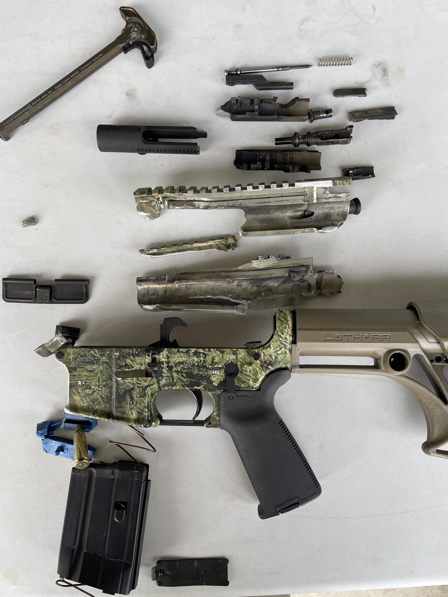

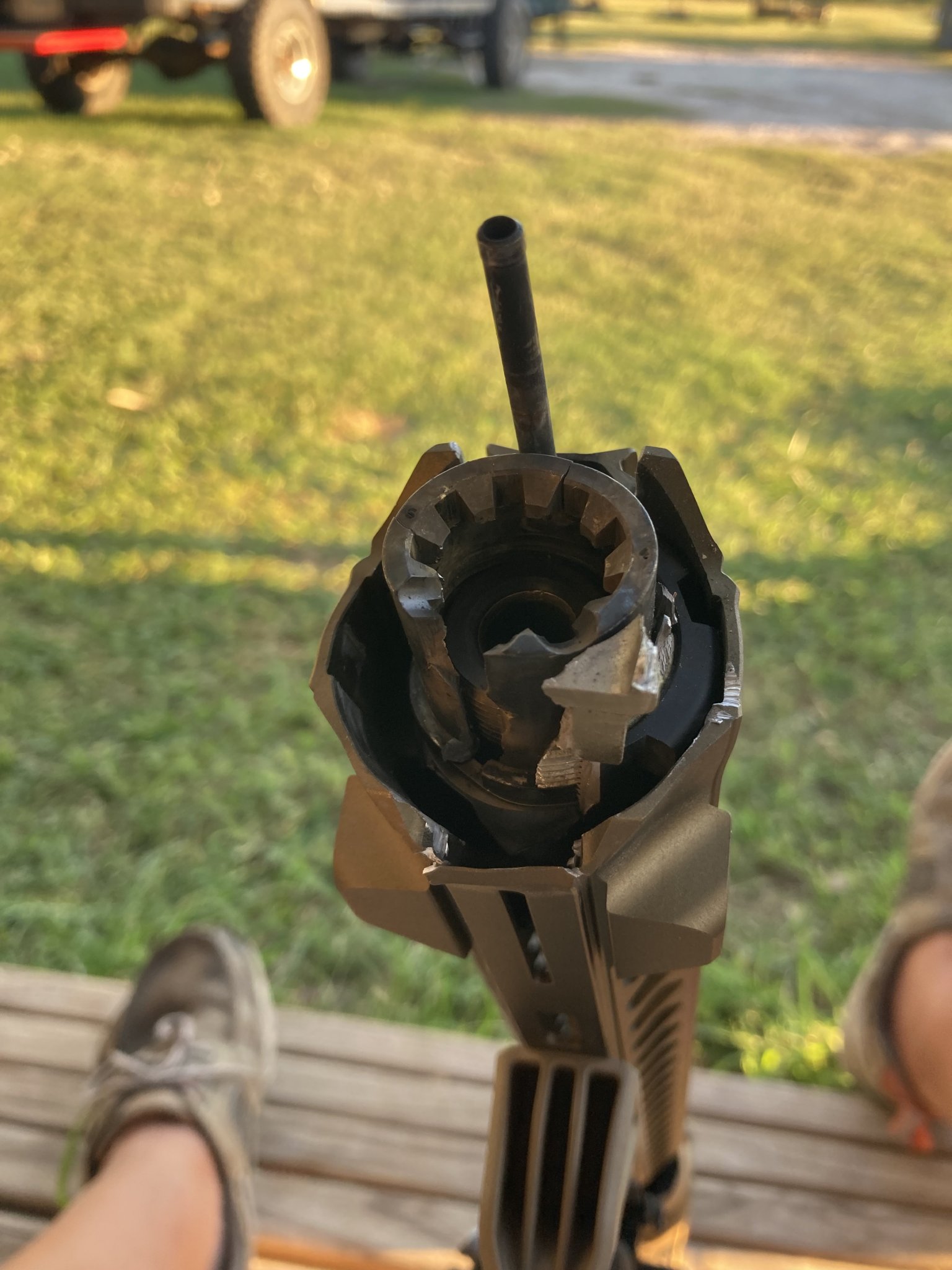

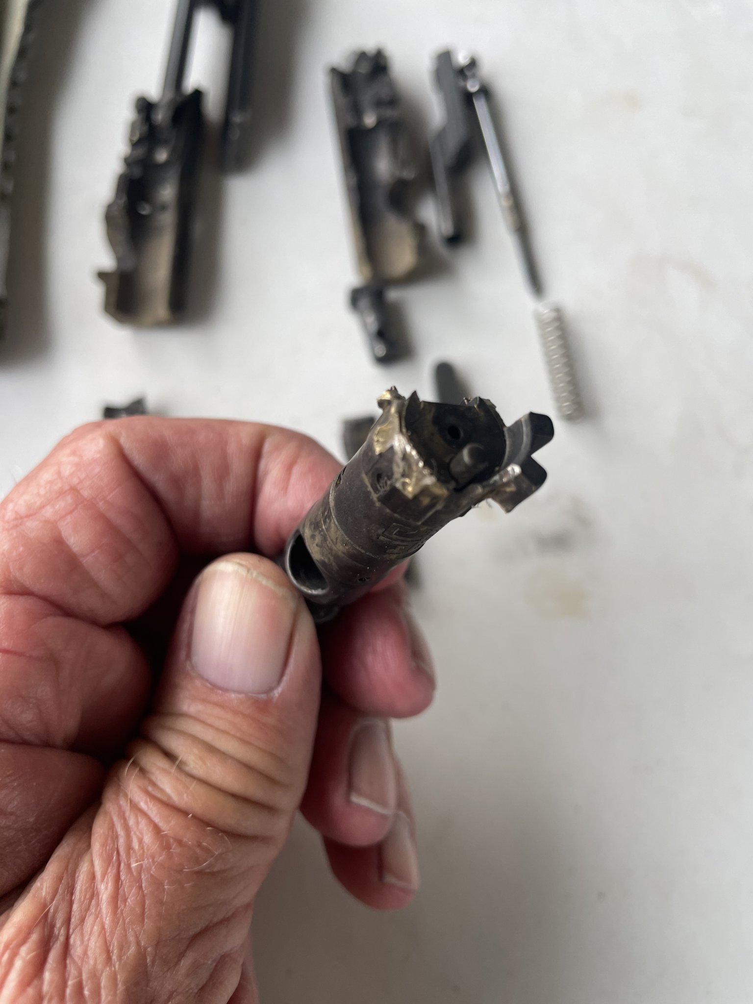

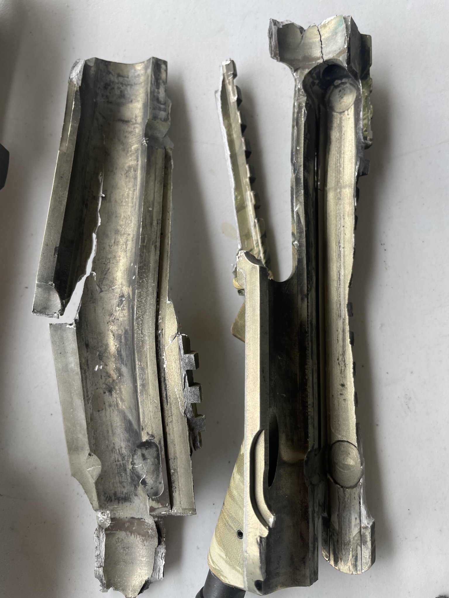

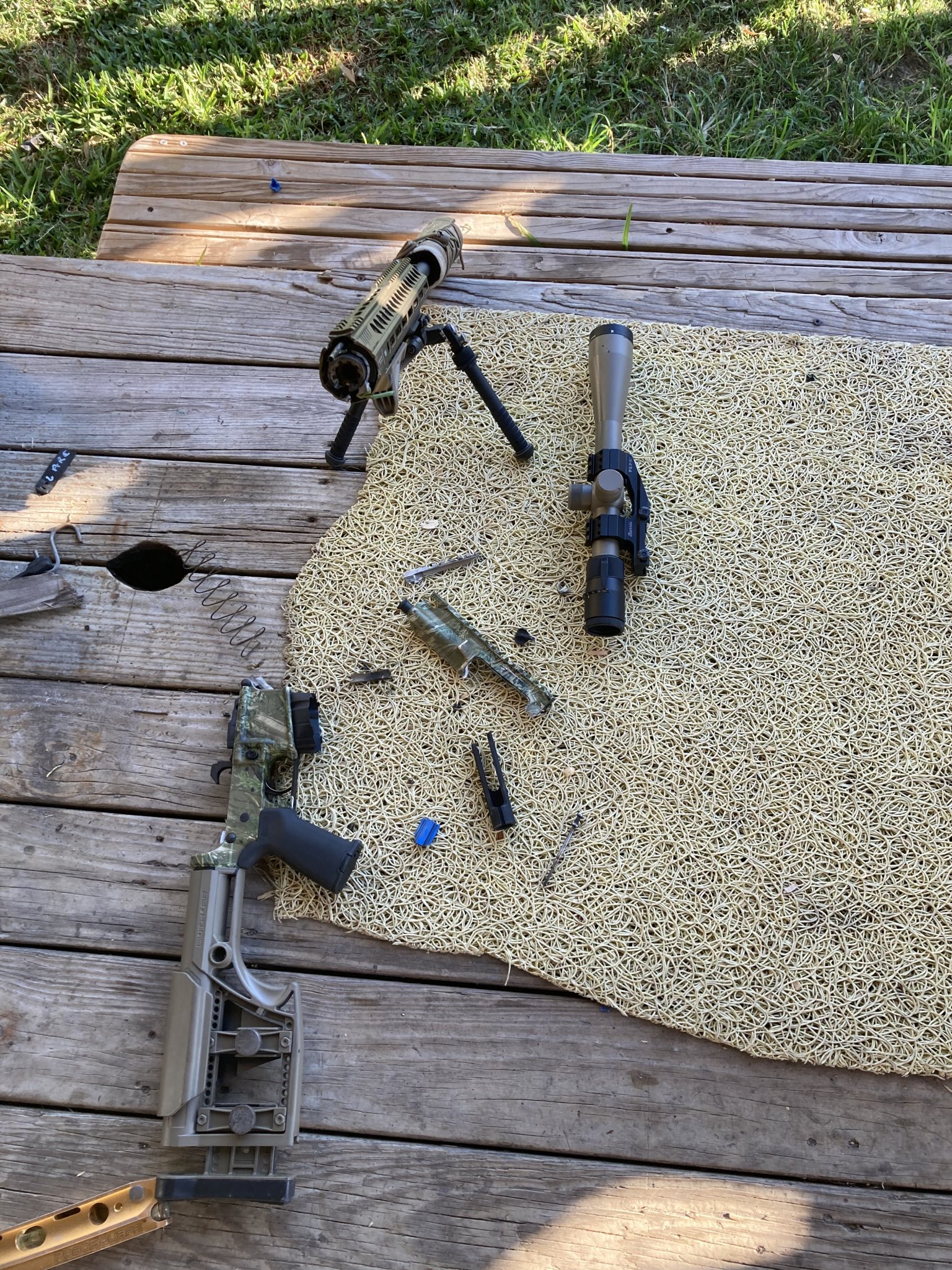

Very experienced and cautious Hand loader made a very bad mistake when he grabbed CFE Pistol instead of CFE 223. No serious injuries. Parts are where they landed and pictures speak for themselves.

He takes full responsibility but turns out he ordered CFE223 and was sent the CFE pistol, contacted retailer and their records only show CFE. More than a few lessons here. He has been loading for over 15 years and is an avid shooter and area PRS competitor. I have learned more from him about loading than any source other than Forums and books. He brought parts for me to take a closer look at tonight but I was busy and didn't connect.

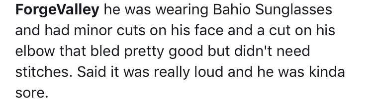

Rocketvapor, it was a Bushmaster and ForgeValley he was wearing Bahio Sunglasses and had minor cuts on his face and a cut on his elbow that bled pretty good but didn't need stitches. Said it was really loud and he was kinda sore.
The potential for injury was definitely there. 25gr vs 250 is a complete different ball game when it was likely the same mistake. Pistol powder and rifle cartridge. Marks name was drug through the dirt over a reloading error, not a design flaw.

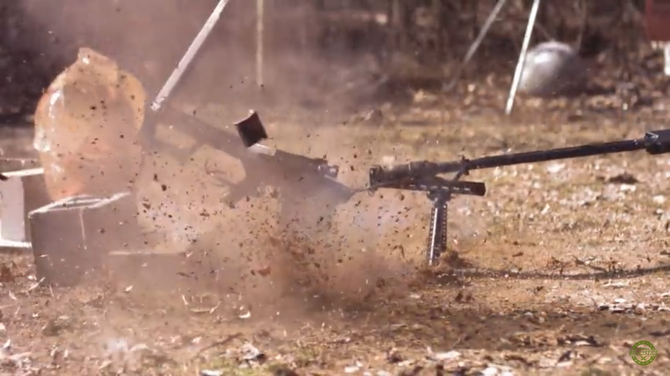

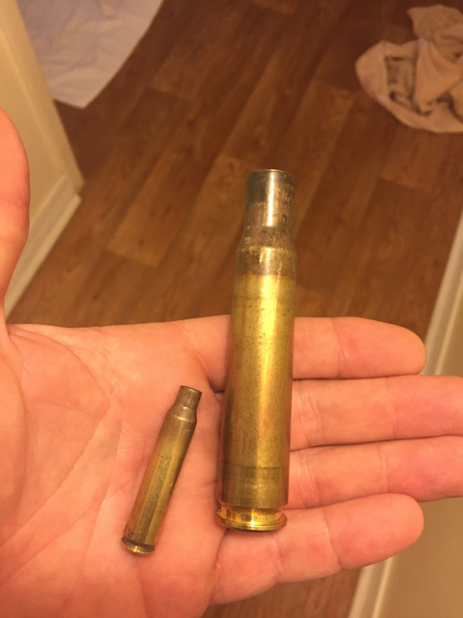

Did you see what’s happened to the Barrett? When loaded with pistol powder, potentially just as deadly.
Yes, I saw, and while it certainly goes bang, most of the shrapnel grenades outwards laterally, not straight back at your face and body.
Scott has blown up two RN 50s, once with himself as the unfortunate subject, and one with a stand-in. in both cases the “ears” became frag that went right backwards at the shooter.
no one is screaming at eugene stoner for the same reason they aren’t screaming at ronnie barret, when those respective firearms have a massive overpressure event, they are not practically guarnteed to send lethal shrapnel in the worst possible direction, instead venting most of the force in directions other than the shooter.
Apparently you missed the chunks of metal that imbedded in the ballistics dummy.

I hear you, but you’re also comparing a .223 to a .50.
Would you sit behind that Barrett with a cartridge loaded with pistol powered powder and trust your life to it??
Either one regardless of size would cause some damage. I prefer not having metal lodged in my neck

Did you see what’s happened to the Barrett? When loaded with pistol powder, potentially just as deadly. View attachment 7972058
