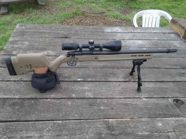

    My stock was giving me problems, changed it out.
    The wind gave me problems went indoors, it wasn't the gun.
    ​​​​​​a ballistic calculator helped figure out the finicky subsonic.
    Mine likes 220 otm subs and 207 amax.
