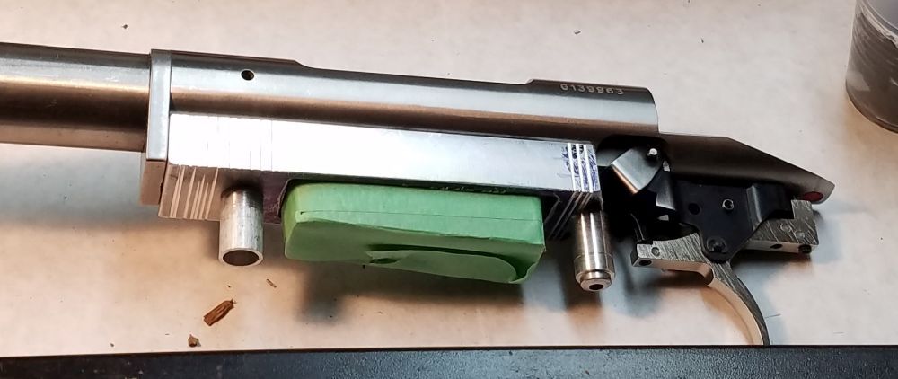

Here is a picture of a 20 degree V block and pillars I made.
