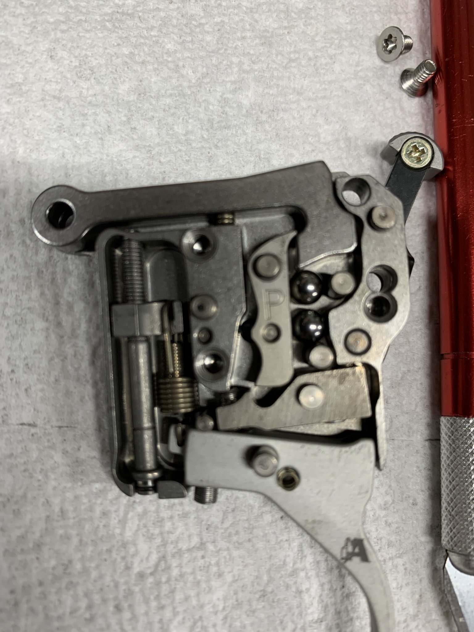

I had to disassemble my trigger because I was a caveman and had to do surgery on it. Upon reassembly I discovered that a pin or something was filling the hole to make a seat or shelf for my top sear spring to sit on. Either that or I'm missing something else because the spring drops into the hole and provides no return on the top sear. Any ideas what I'm missing? I'll give Bullet Central a call tomorrow if not.

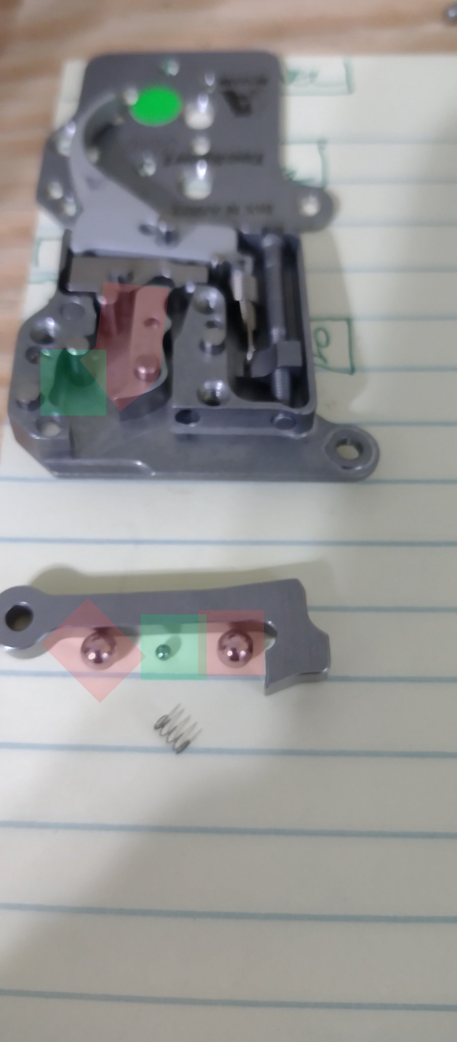

The other question is about the smaller ball (green in pic). I see no mention of that anywhere in web hunts and it was in the corresponding location when I got the cover undone. Does that look like the correct location if anyone knows.

The tiny green ball bearing and spring go in the hole in the side of the trigger shoe and press against the cover. They aren’t essential and the early models didn’t have it which is why you don’t see it in old documentation.
The two larger ball bearings just go in the empty space. Looks like you may be missing the seat spring?
Ahhh, I appreciate it. I guess the sear spring took a trip across the room. At least I know what I'm looking for. When I changed sears it was uneventful. The full disassembly was another story. Thanks

I appreciate it. The ball ended up by the bigger two when separating the face. My bigger problem is the top sear spring that went into orbit and I'm ready to snap looking for the damn thing. I'll call in the morning and hopefully they can get one coming my way. I'll also do some digging to see what I can find that may fit.
At this point I'll buy a new damn trigger before I spend another second going through bins of brass looking for it in each case.

The reason for the small spring and ball bearing in the trigger shoe is that there were some complaints that the trigger shoe had side to side play when it was handled so they drilled a hole in the shoe and put a spring and ball in it to eliminate the possibility of side to side movement.
I was not able to feel any significant side to side play with or without the spring and ball when I changed my
shoe from the one with the spring to the one without it.
Edit: Oh yea, never take the safety lever off because there is a spring washer under it and it is a BITCH to get it the c-clip back on. You need an arbor press to hold everything down while you put the c-clip back on.
There was very minor movement in mine but nothing really bothersome. The spring does remove it nicely after closing it up.
