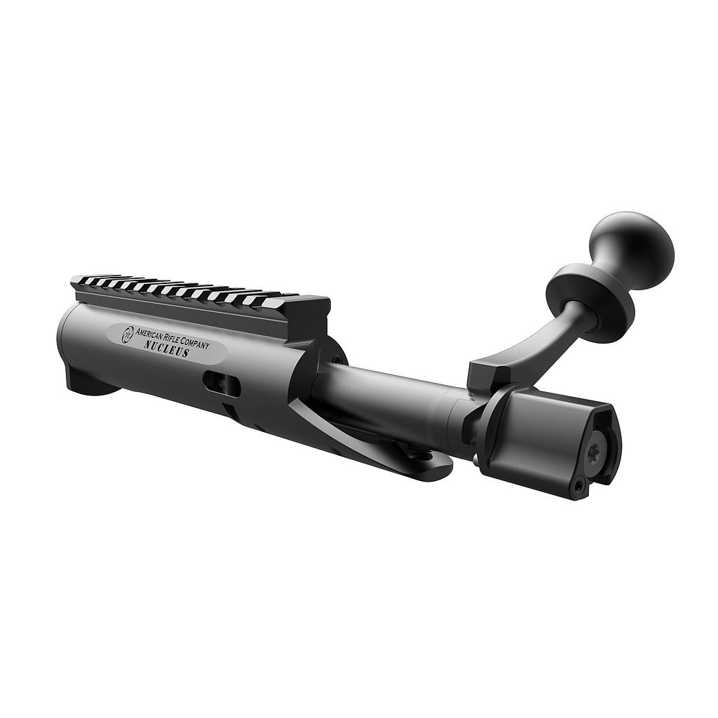

I have my 6mm ARC bolt guns built on a Cz527, and my PRS/NRL competition rifle is on an American Rifle Co. Nucleus (on sale until Wednesday for $750, by the way). The Howa mini is another viable option, as is the TL-3/Origin. Most any action you can get a Grendel/7.62x39/PPC (.445") bolt face will work. If you build something that feeds from AICS mags, go with MDT BR or ARC magazines.
