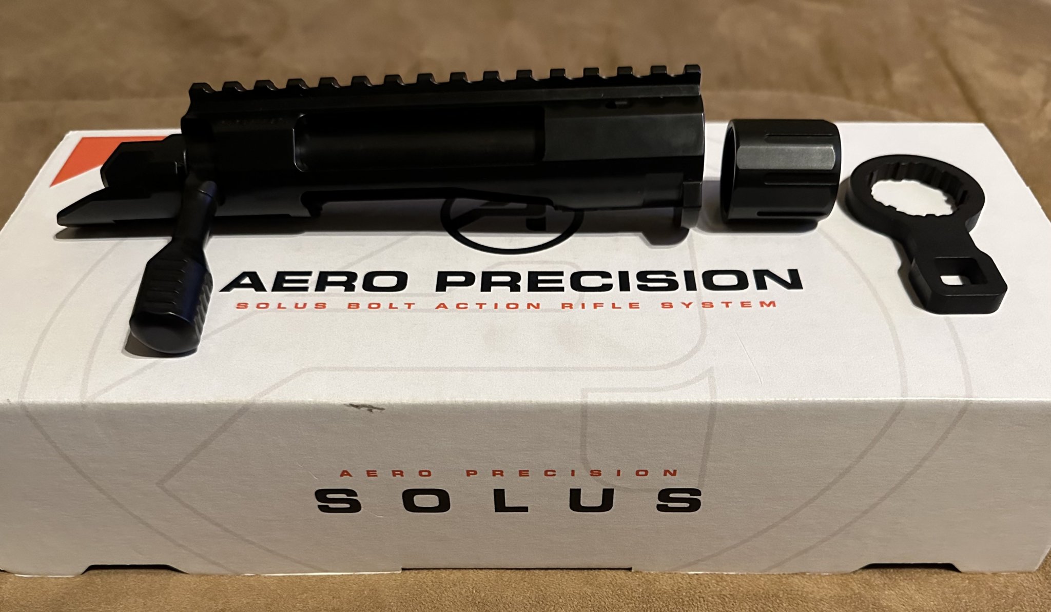

If you're in the PNW, drive over to Aero Precision and pickup a SOLUS bolt action and chassis, and build on it. Or pickup a whole SOLUS rifle. They have several flavors in 6.5CM and .308 Win.
Also, the SOLUS uses Zermatt Origin/Bighorn shouldered prefit barrels, and Aero sells the SOLUS action wrench for like $90, so you can swap barrels at home yourself with a torque wrench and a barrel vise. Simple as that. It also has interchangeable bolt heads, but they don't have anything other than .478" to offer right now. In the future I wouldn't mind getting a short-action magnum and building a 7mm SS (Sherman Short Mag) on it.
I'm building a custom SOLUS 20" .25 Creedmoor right now. I've got everything except the barrel and scope. I'm going with a custom pre-fit with a shoulder, and won't be using the barrel nut setup, but it does come with the nut and the nut wrench incase you want to use a Savage small-shank barrel instead of a shouldered pre-fit.

Get a Bighorn Origin action and a prefit barrel. You can change the bolt face easy enough for a short mag but a 6.5 Creed will drop elk. The Origin is a known commodity and it works. Allows for any 700 footprint stock or chassis and triggers. You can easily stay under $2000.

Yeah, all to end up with a, not long enough, long action with 70% lug engagement and a brittle bolt. They were awesome at $400. Now?
Pass. The. Origin.
JA outdoors is a source for tikka actions and parts. Also getting barrels off the newer actions is a breeze.
